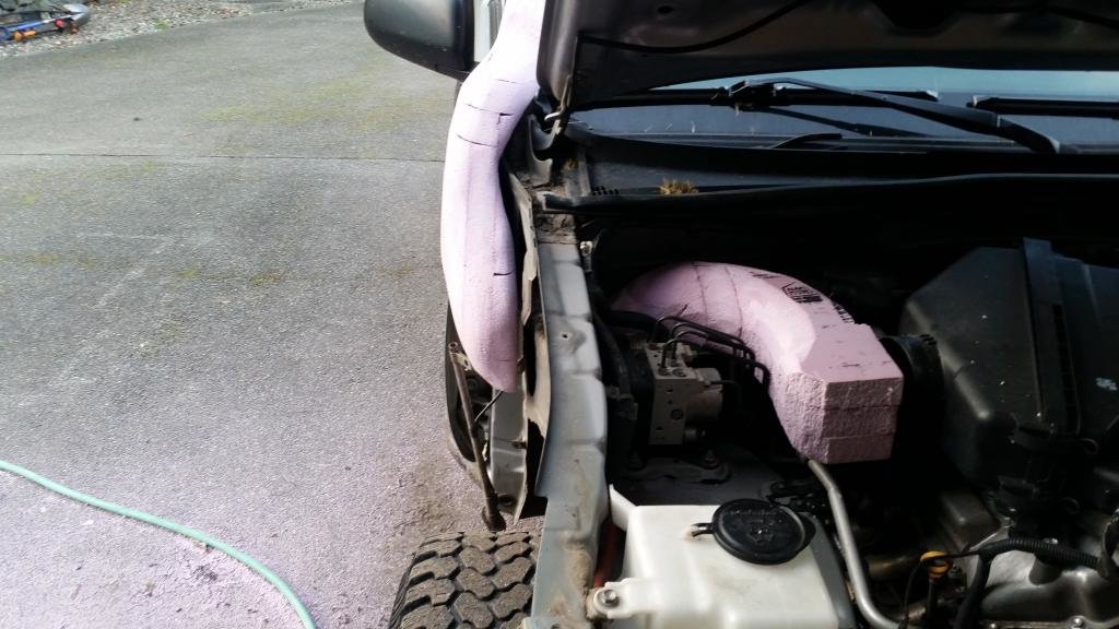

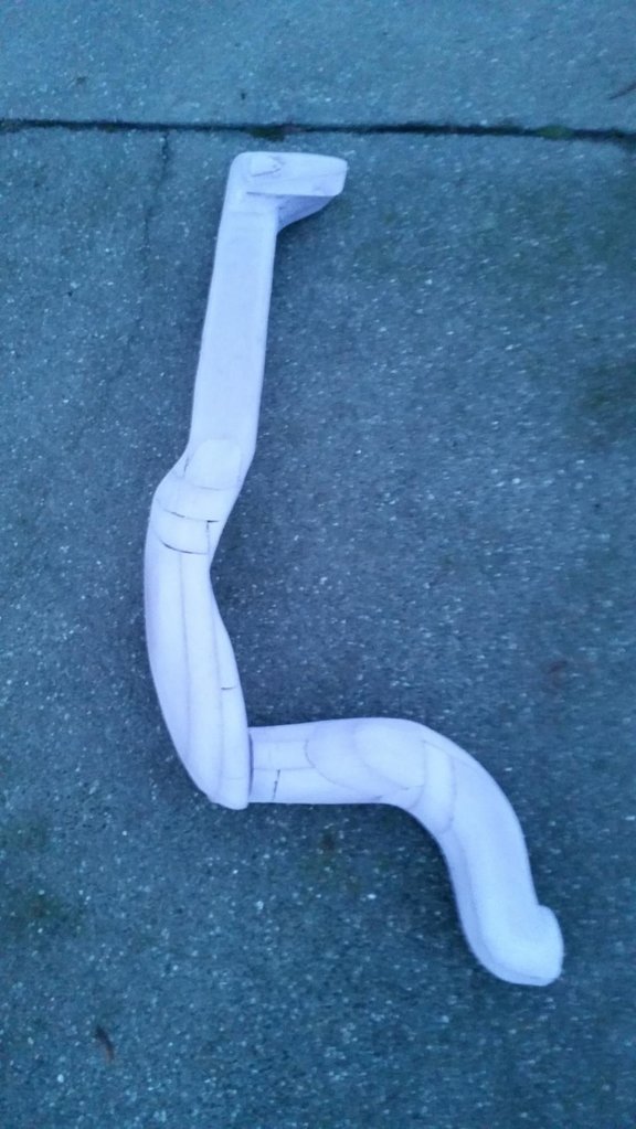

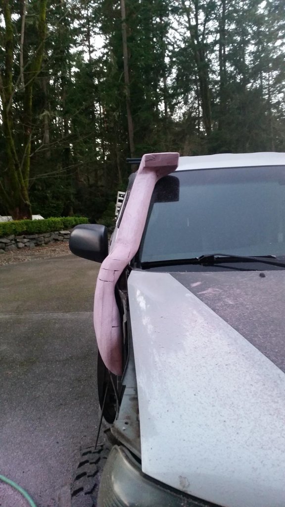

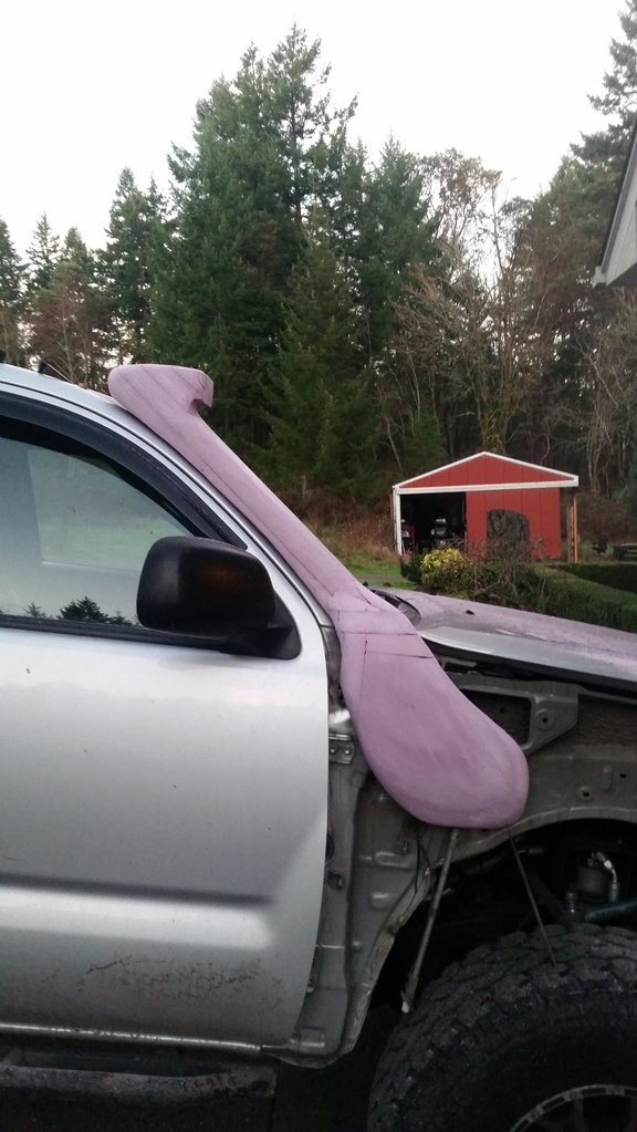

    I still have a lot of work to do but I thought I would post a teaser. I am working a little bit every day so it's going to take a while but this is where I am at now:

    Lol I know we were talking about this before. It wasn't worth it to me to wait and pay $300+ even for a used piece of "custom plastic".
    I feel confident in my fiber glassing abilities that I can pull this off. So far I am in $15 for the foam, $8 for the spray glue, $22 for the silicone couplers, and $20 for the fiberglass materials.
    I am not going to give too much away until I am done though.

    That pink mold you see is made of insulation foam. Once I get it perfectly molded how I want it I will be fiber glassing around that. When the fiberglass is satisfactory I will pour acetone into the tube which will melt the foam leaving me with a fiberglass tube coated in resin.

    I am almost done with the engine bay tube (I am actually farther then what is pictured):
