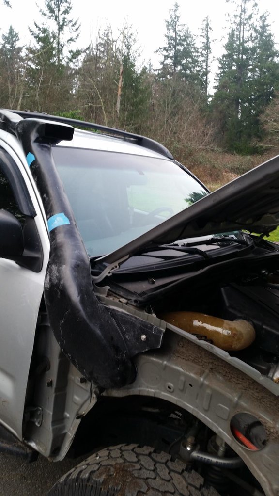

    I have been making a little progress over these last few days:

    I got the inner fender mounts done and cut the fender. I still need to make a mount for the upper portion.

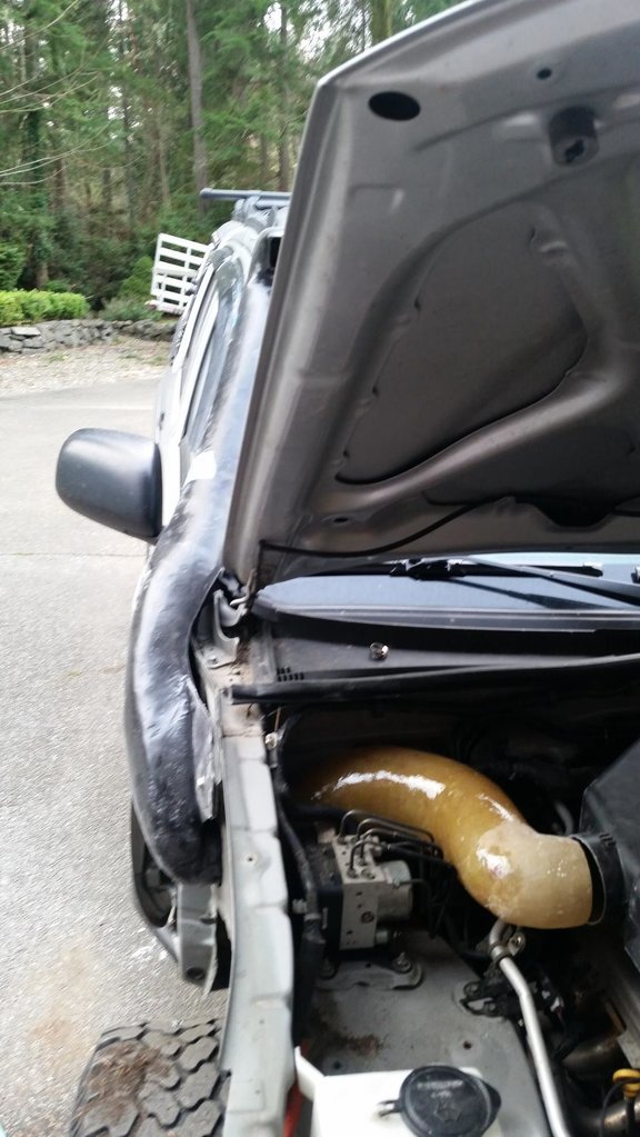

    I've got the main portion primed and put the first coat of paint on. I started fiber glassing the engine bay tube. I plan on getting some automotive weather stripping the the fender and then I will install the main tube permanently. Once I am done with the engine bay tube I will swap it out for the stock one.

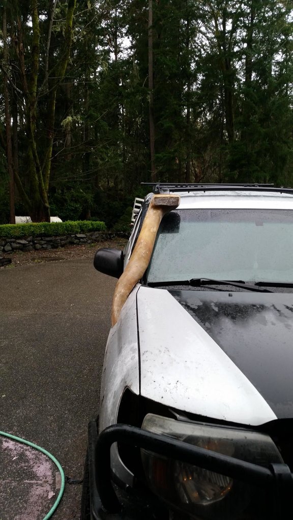

    I had a good amount of progress today. SO CLOSE!

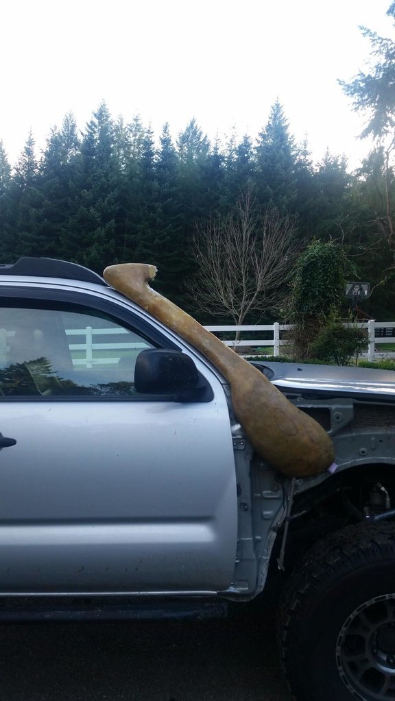

    DONE! (mostly) Now I just need to figure out a grill and I have an idea for a rain deflector.
