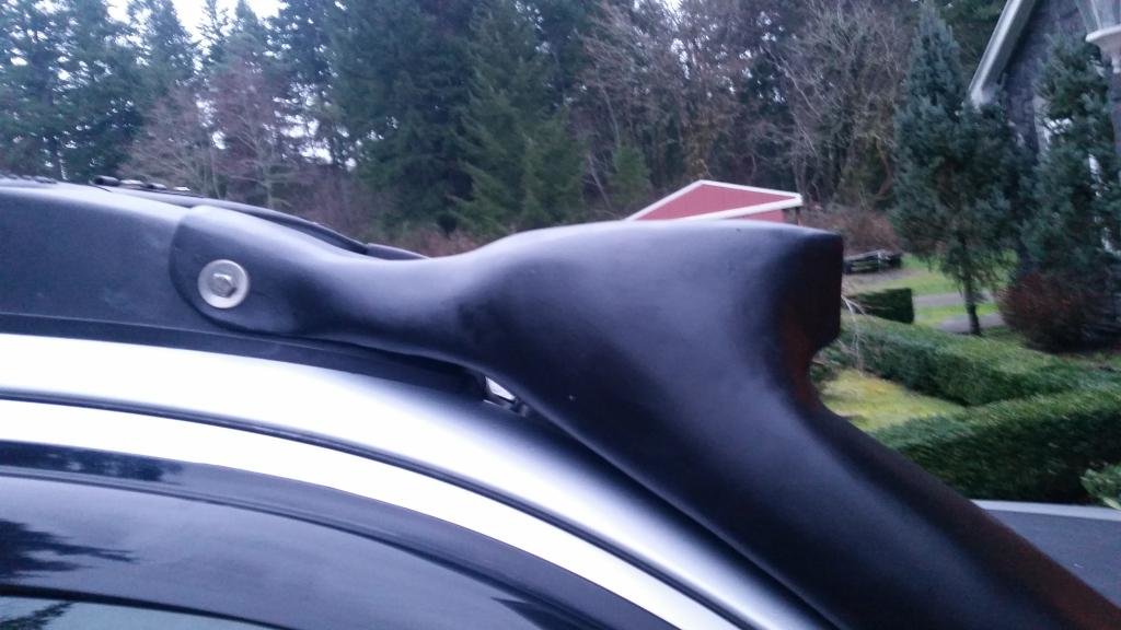

    Looks slick! Any provisions for a water separator like the ARB?

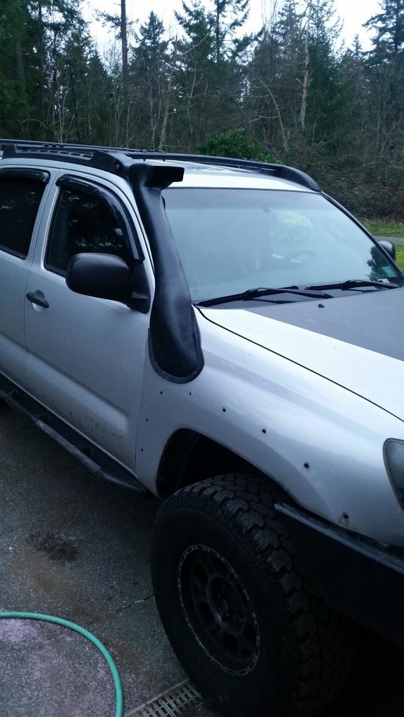

    Thanks guys. I'll post up once I have some more time to work on the grill/deflector.

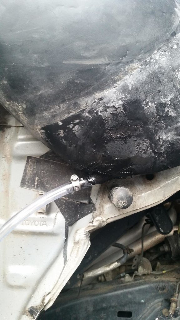

    I build the bottom just a little lower than the intake tube and have a tube that I still need to connect to alow the water to drain.

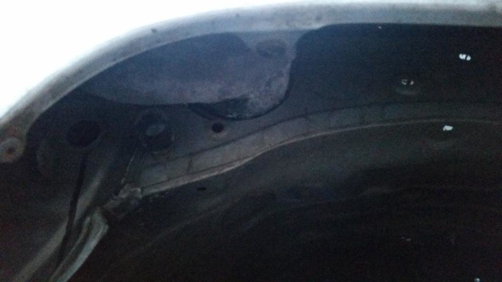

    He does not have a smog pump either. I wounder if you had 1 it would suck in water and there for defeat havinga dorkal.?

    so your water drain is at the bottom of snorkel?? I'm so intrigued :popcorn:

    What do you mean by a smog pump?
    Ya, I got to impatient to do it earlier. I have it made, just not attached yet.

    I'm not even sure if it's really called a smog pump at this point I've heard to it referred to as a secondary injector and a cold air start pump where your electronic brake distribution center is right in front of that should be a little pump that connects to your manifold, or shouldn't be at this point I don't know why some of them have them and why some of them don't I do not know that either. manwithoutaplan and knows what I'm talking about and a few other people on Tacomaworld know what I'm talking about but no one can come up with a straight answer

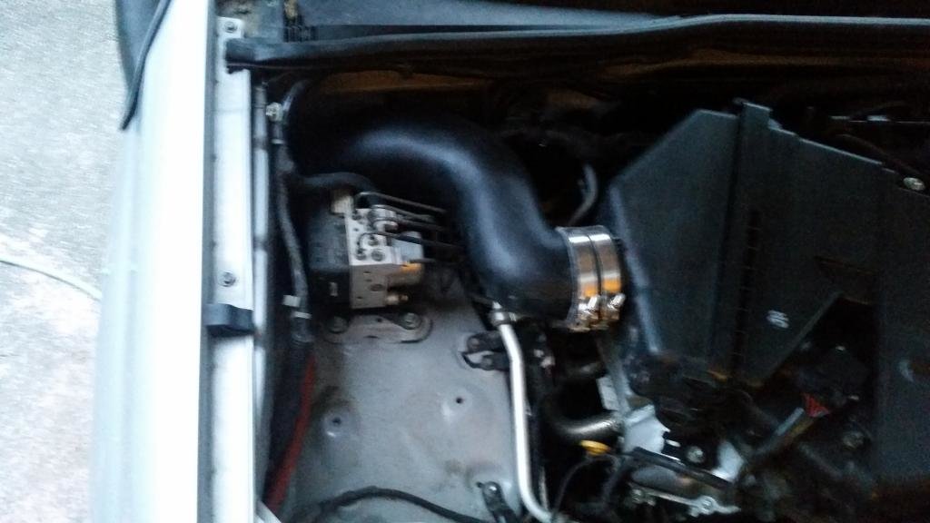

    I hope this gives you a better idea. I still need to come up with a water trap. I can get Pelican Micro cases for like $10. I'm thinking about using one of those to be able to drain it easy.
    So it's an additional intake port? I wonder if it is one of those state emission code additions.

    I'm pretty sure it has something to do with the state emission codes but why do earlier models have it and later models have it and Inbetweeners like mine and manWithoutaplan or you dont.and from what I'm told all four cylinders came with it

    wont that let water in then? The arb one is designed to expel water from the intake head.

    I know Safari has small holes at the base of their head but I highly doubt that much of the water is removed by that. It is currently open ended and, yes, as it is it would allow water in but I am working on a water catch with a check vavle. That way water will be able to leave the snorkel but will not be allowed the opposite way.

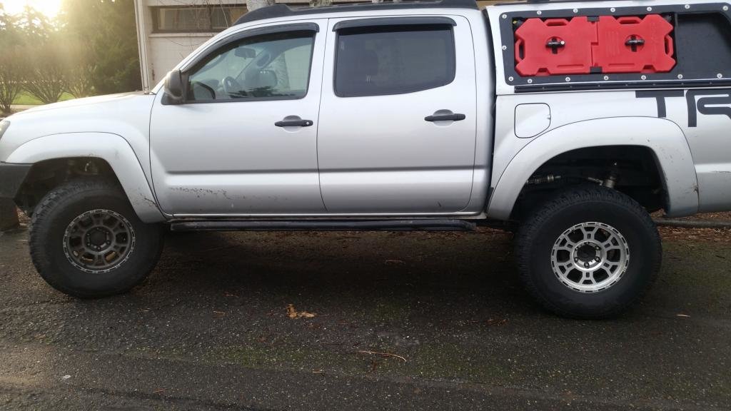

    I am battling myself. Do you guys think it would be worth switching out my aftermarket Vision Raptor rims for Toyota FJ80 Land Cruiser rims painted black? They have identical specs; 16x8, 6 on 5.5, 0 offset and 4.5" BS. The FJ rims are $200 + what ever work to swap out. Eventually, I would like to get a set of 16" beadlocks with 4"-3.5" backspacing but consideringthe price I don't think that will be happening any time soon.
    Vision Raptor:
    FJ80 rims:

    If your waiting for them to pop up on ebay or CL then they can be had for a nice deal, but if you're going to buy new there are so many better options out there for the money. You might be better off derping what you've got if your looking for a short term change and keep saving for what you really want.
