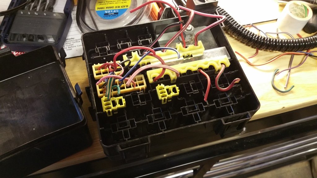

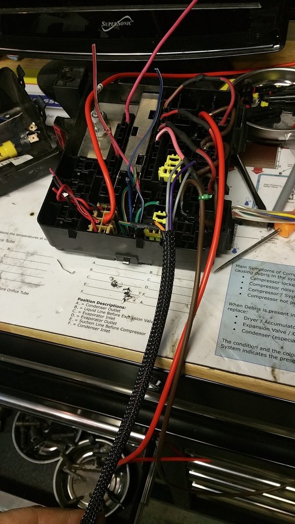

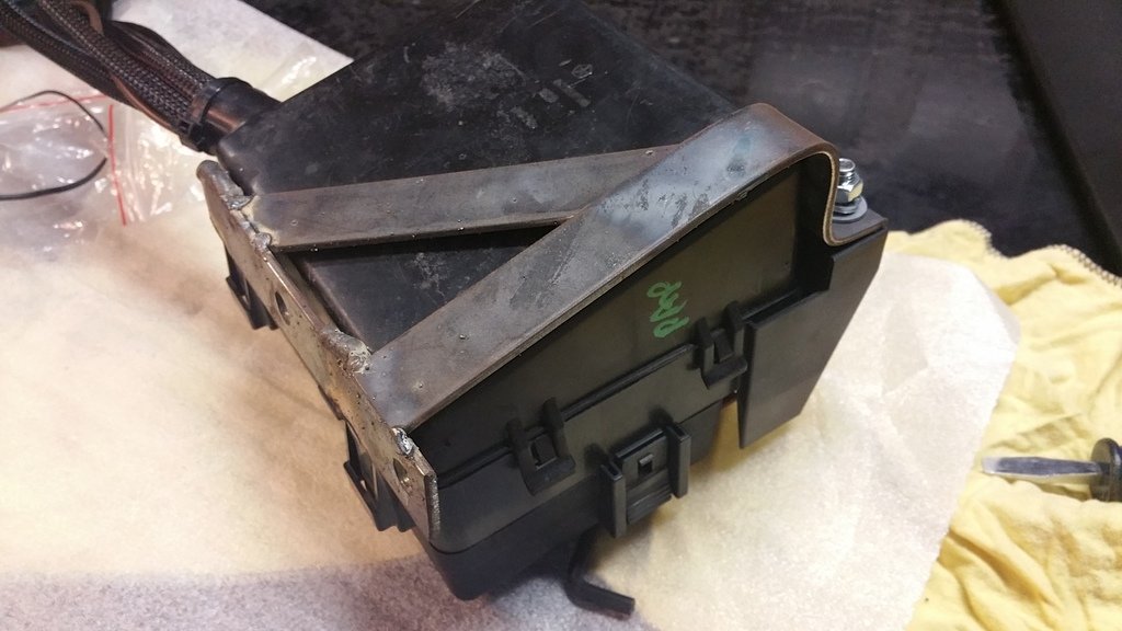

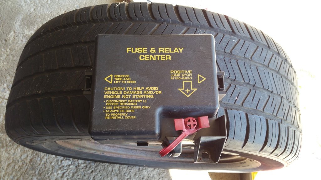

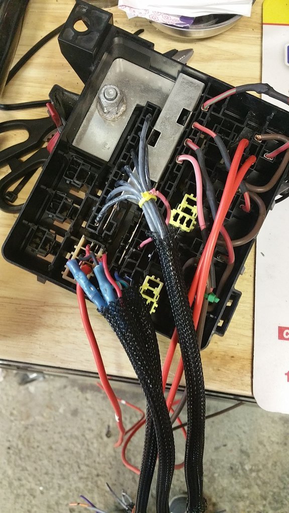

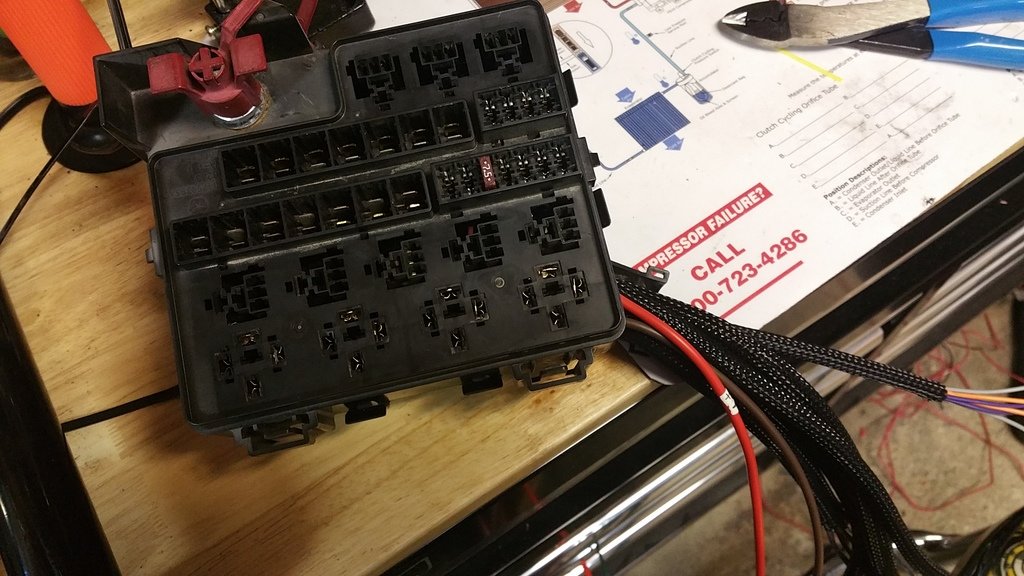

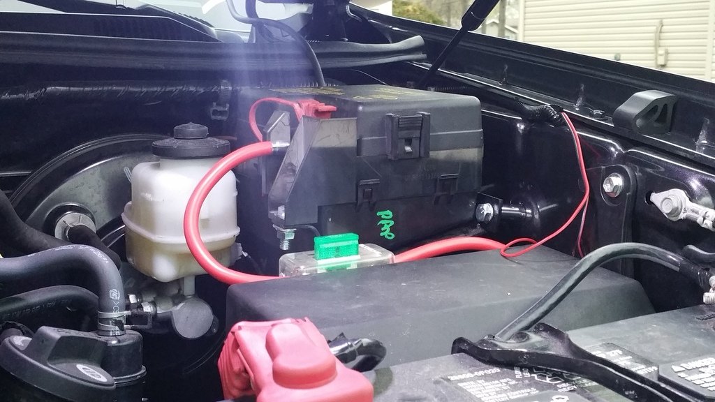

    So between wanting to do a S-Pod, Bussman and a few other options, I decided to be frugal and build my own fuse box. After some Pull A Part rummaging, I found this donor from a 2001 Sebring (or Intrepid, been a while, I forget.)
    Seems to fit well where I have intentions to put it.

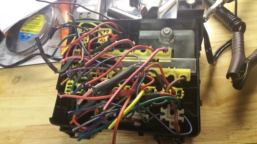

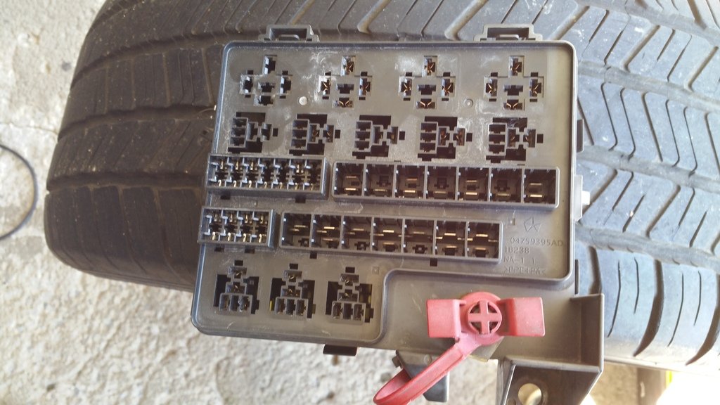

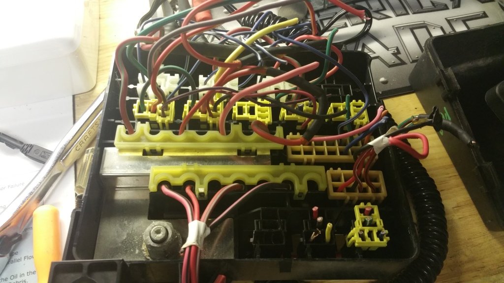

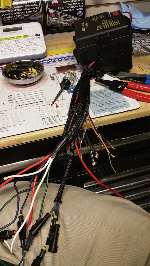

    Starting clearing away wires, saving any connectors I may be able to use.
    The rebuild...

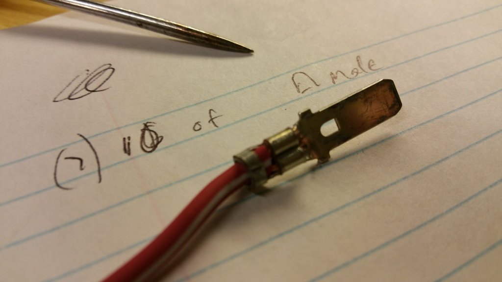

    Worse part were finding these connectors, but with the help of @Up2NoGood, found the ones I needed to make up missing/damaged ones..
    All benched tested, just need to make a Mount for it and wire it up, along with adding connectors to all the wires in and out.

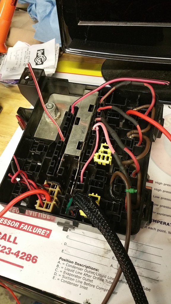

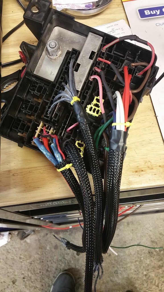

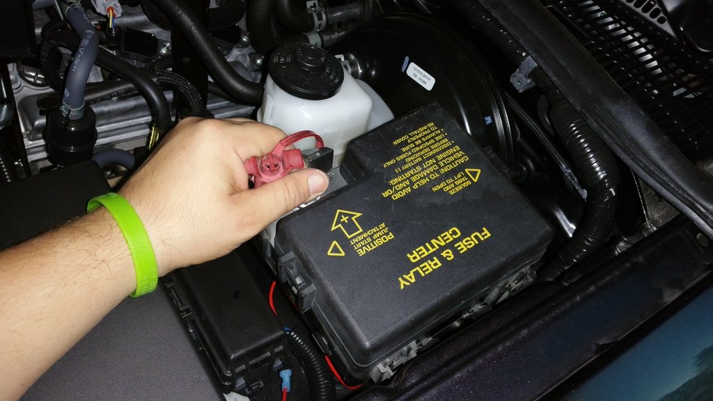

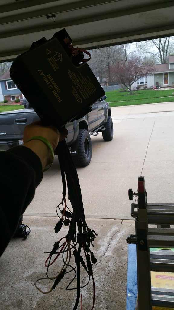

    Bracket is done, just need to space out the bracket away from fender due to Redline Hood Struts.. Painted it after this with POR15.

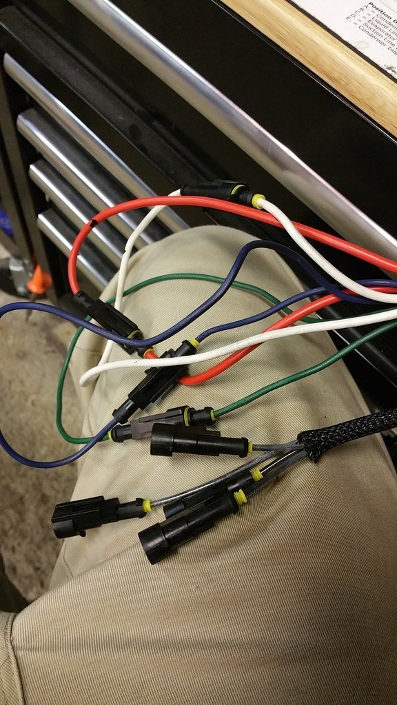

    Waterproof connections all installed.

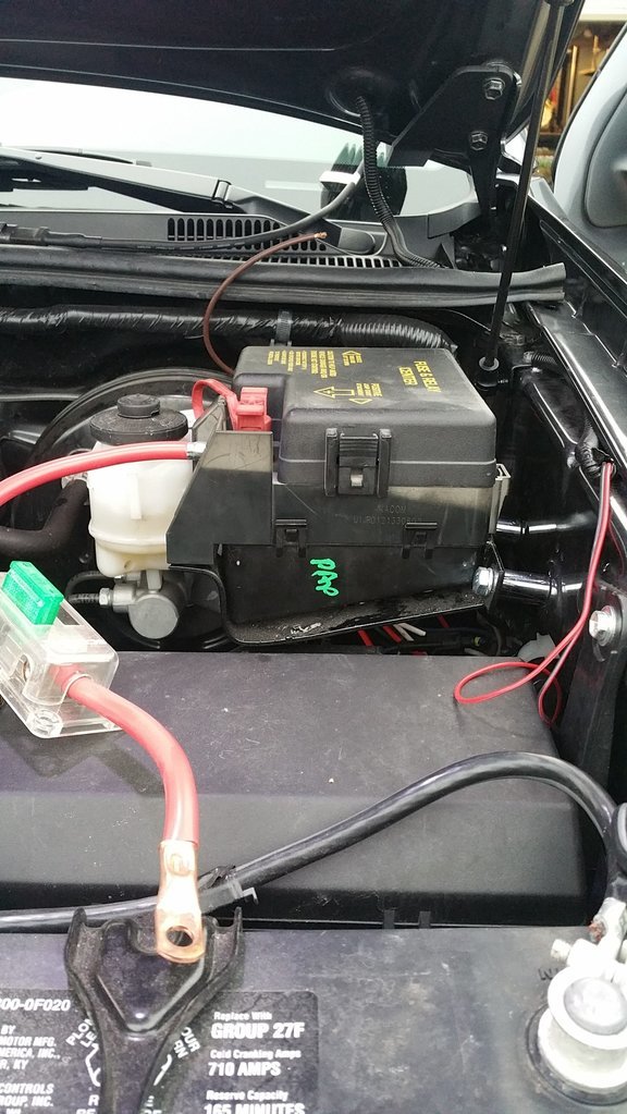

  5. Apr 27, 2016 at 10:02 AM
    xjoey dubsx
    xjoey dubsx [OP] Curb Crawler
    Sep 18, 2015
    #164617
    267
    Joe
    Cleveland, Ohio
    2015 Taco TRD Sport 6" Coil Overed

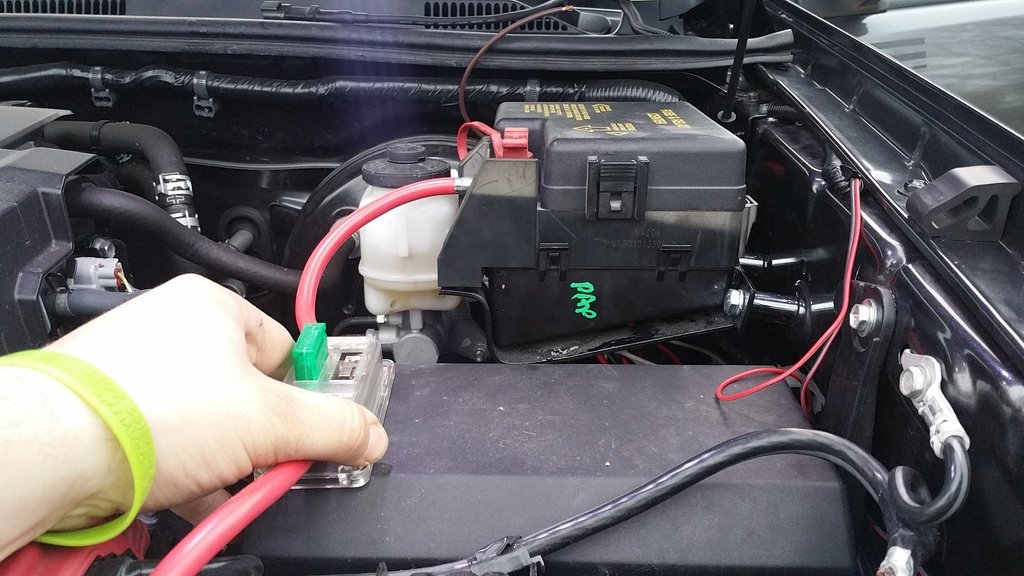

    6" PC Coil Over Lift, 35s, 18s, Extang Bed Lights, Garage Door Opener Hack, Bullydog GT Tuner, BHLM, 8300 Tinted everything else, Raptor Lights, Bakflip G2

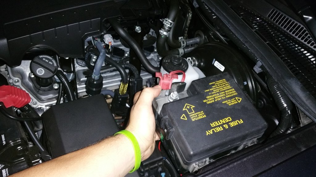

    Mounted and ready for wires to be hooked up.
