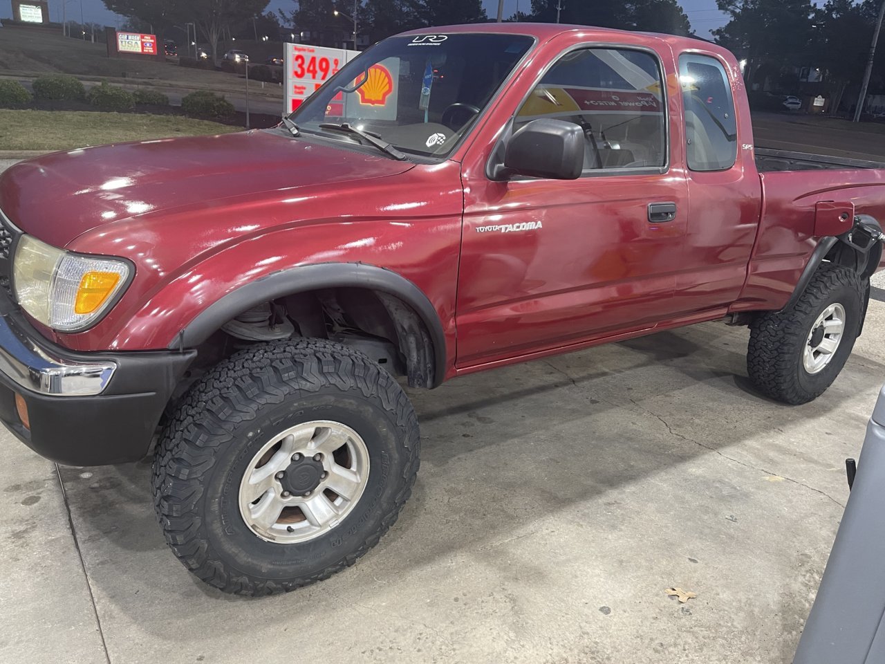

    Hey everyone. Long time lurker. Bought my 00’ pre runner SR5 in 2007 when I moved away for college. The old girl got me through college, med school, and now almost all of residency. Finally added a beater Silverado to the family so that I can put car seats in the back. The free price was right. But now that I have a second truck I can finally get after the Tacoma and do it right.
    Doing some major suspension upgrades in the next few weeks; ome shocks struts and springs, freedom uca, new LbJ and lca bushing, tie rods and steering bushing. Should I plan to use new cam bolts? They aren’t rusted as I loosened up a few years ago to add a 2.5” spacer up front with ome leaf springs.
