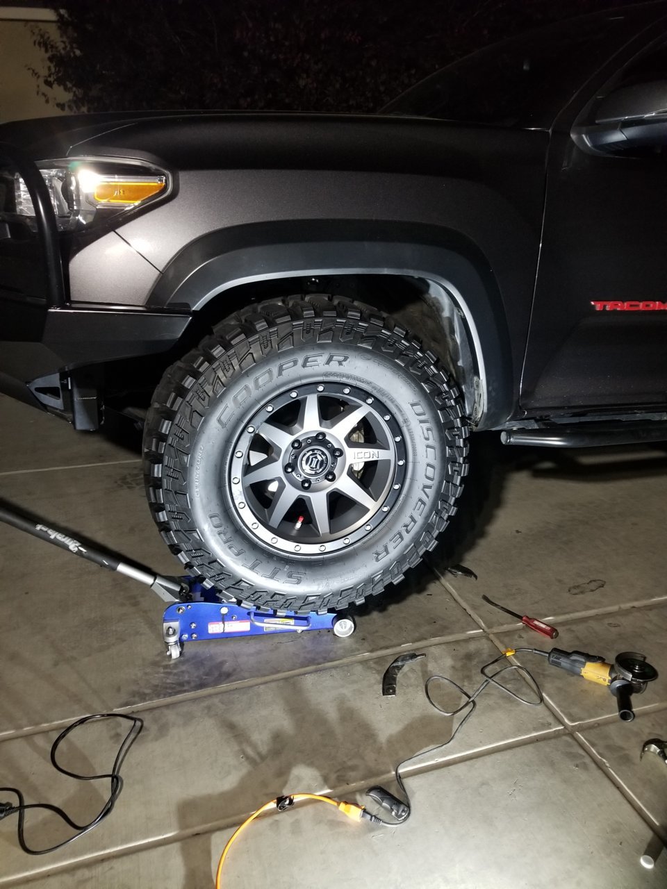

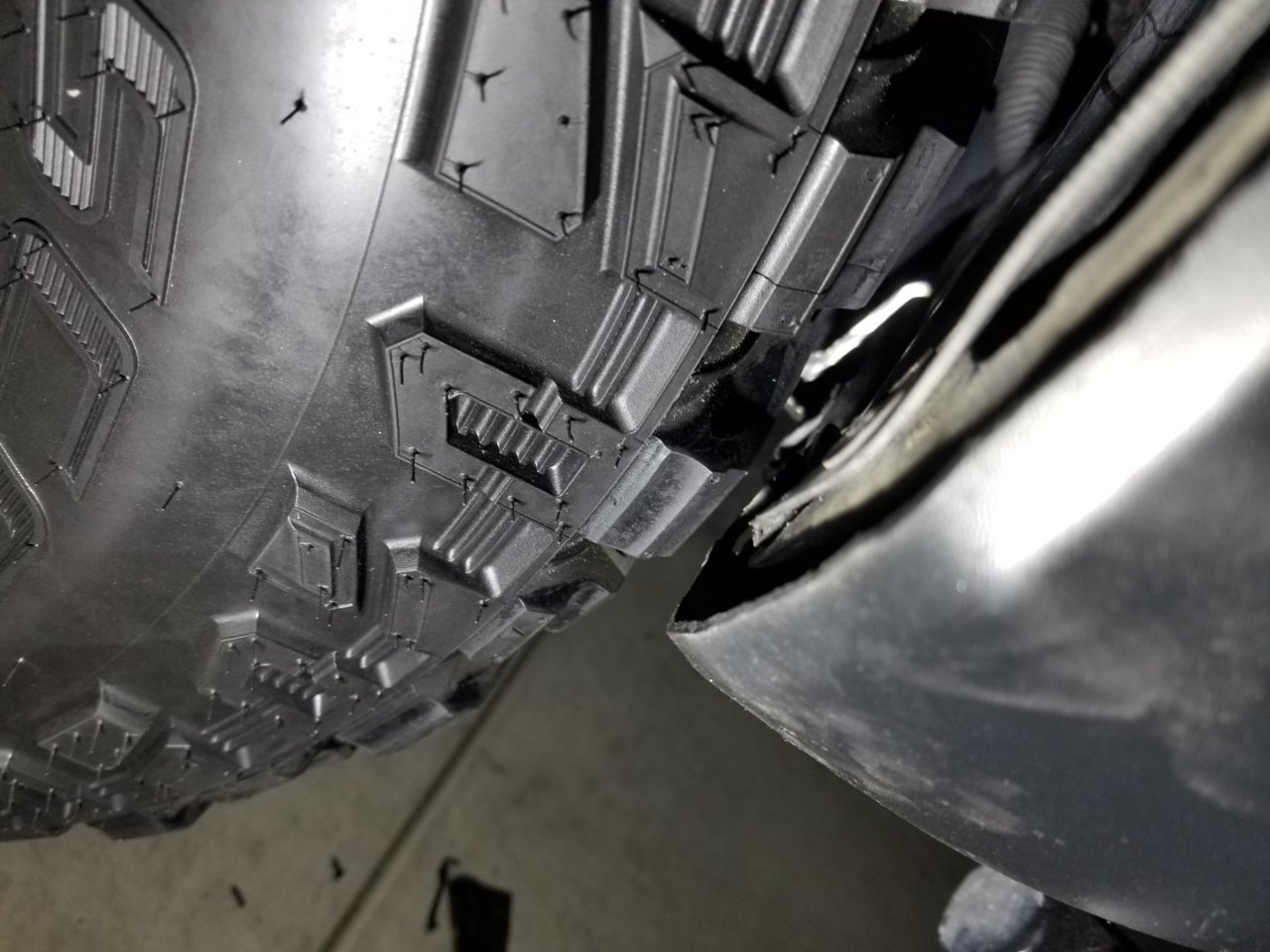

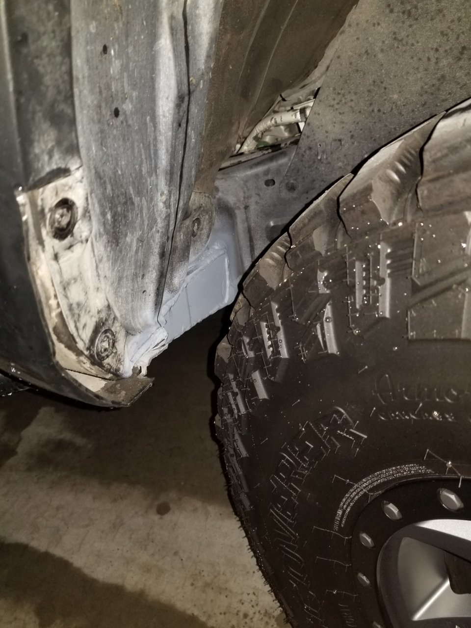

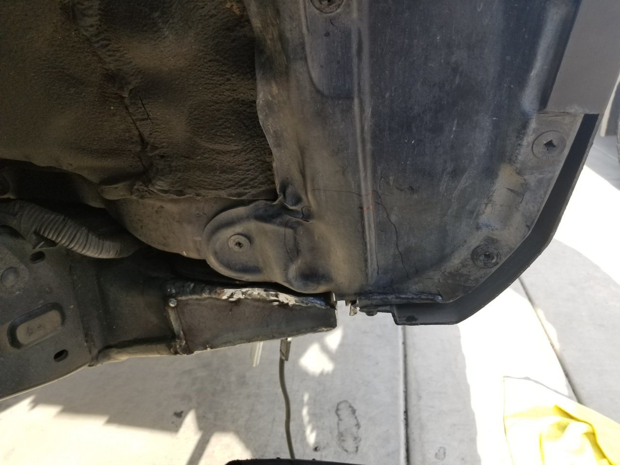

    Just got done doing g the cab mount chop on my truck and I dont know why but I didnt have to cut as much as I've seen on some other trucks. I would highly recommend removing your strut to allow you to move the wheel up and trim as required. I've noticed that every truck seems to be different.
    **note: my truck is lifted 5.5" over stock so I'm going to have more clearance than a 3" at ride height**
    Clearance with the wheel stuffed as high as it can go with the little bit of cutting and trimming.
    Clearance at ride height.

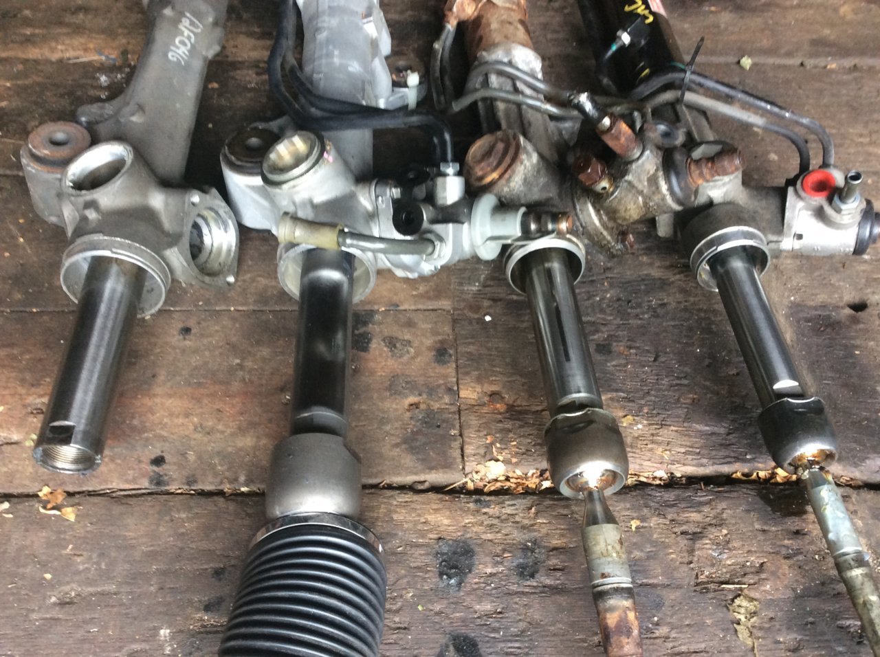

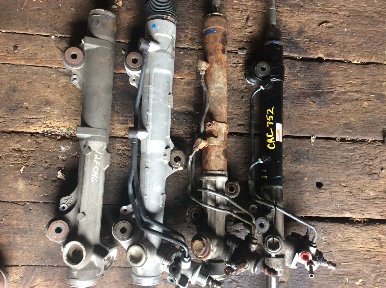

    Things are about to get racktastic.

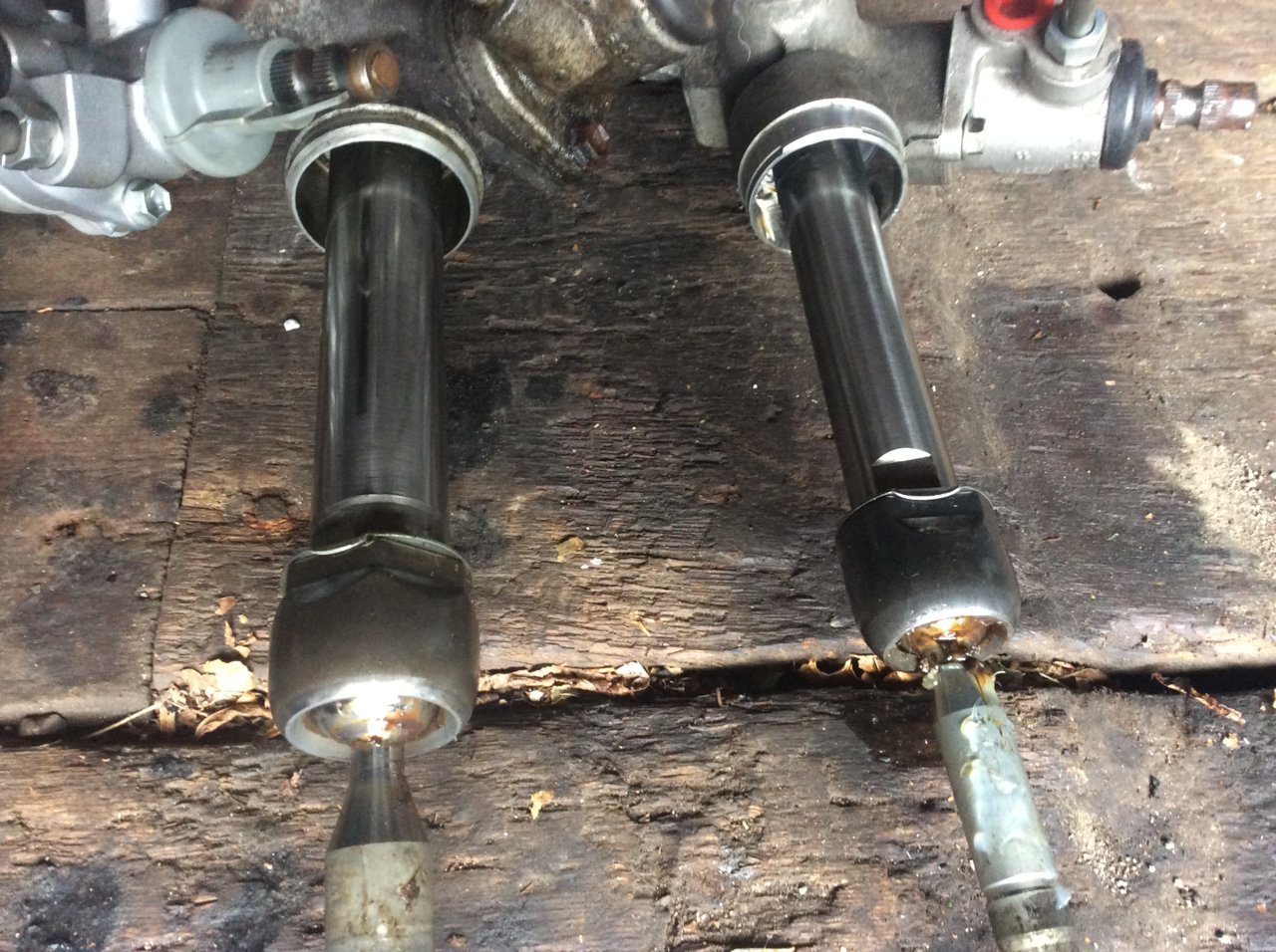

    here we go, staying tuned. @Jowett which one do you figure makes for the best fit?

    The one that is set to arrive on Monday... it's a variant of the rusty colored unit above. UZJ100 Land Cruiser.

    Nice appreciate the feedback, with that said, you thinking the 98-01 100 series years. wasn't aware of the different variants but ill geek out and look into it more

    It's the 03 - 07 rack that has the greatest chance of possibly being modded to bolt in. It is is similar to 98 - 02, which is the rusty rack above, but different mounts.

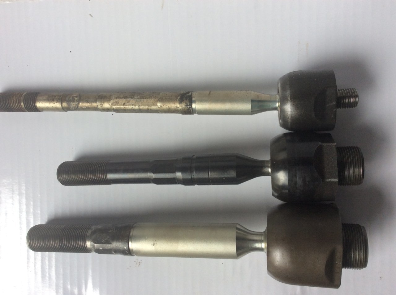

    Inner tie rods.
    Taco
    100 Series
    200 Series/Tundra
    Uscgamecock7, Weirich and mcharfauros like this.

    100 series inners look like a happy medium, but the tundra/200 series are definitely pure beef

    Just when you think you are almost finished. It’s steering rack time!!

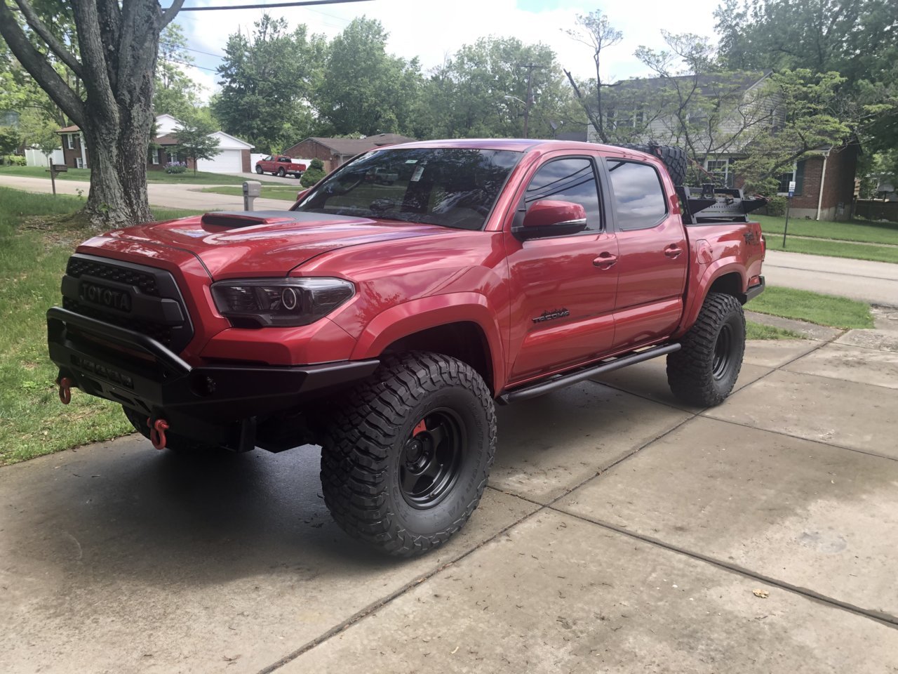

    Plastidip front grill and badges Bilstein 5100 shocks set at 0 OME 888 coils Lights Racing UCAs Headstrong AAL TRD Pro Wheels Matte Black BFG KO2 275/70/17 Rocky Mounts DriveShaft SD KB Voodoo Bed Rack ECGS 8 in clam shell bushing Custom Bedside Decals TRD MTB Edition CBI front bumper CBI rear high clearance bumper CaliRaisedLed 20 in single row bumper ARB CKMA12 Air compressor
    16x8 -3.5 315/75-16

    Thank you very much. It’s been a great experience. I’ve done everything myself except the cab relocation. Enjoyed learning and figuring it all out.

    You did a nice job. I just finished a cab mount relocate on a friends 3rd gen. PITA and a lot of grinding. But they are nice when done.
