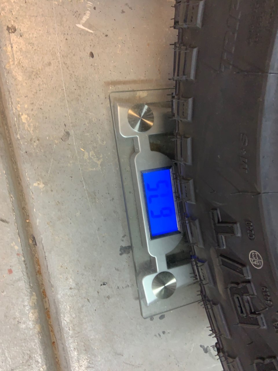

    67.5 pounds on bathroom scale.

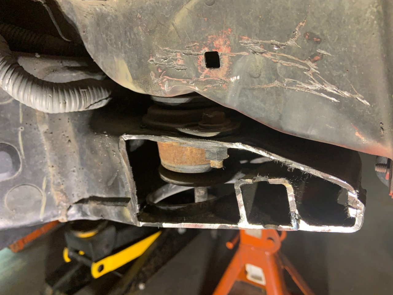

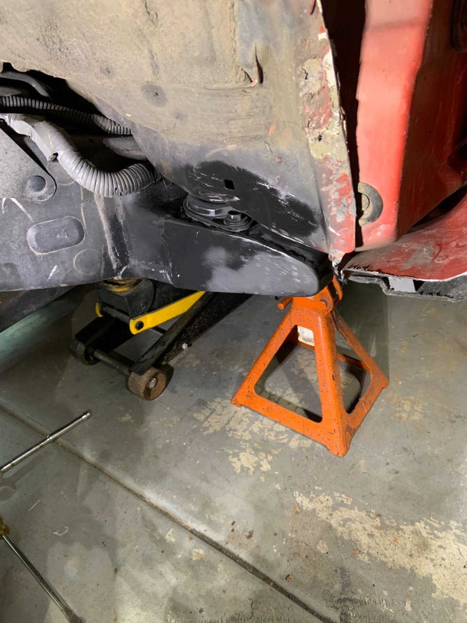

    Cab mount chop done. Getting closer to those 35s.

    Thanks, thats not bad for the load rating. My C rated 315 BFG ATs are 65. Since you seem to have an unmounted one, how tall does it measure? If they make this tire in a C rating Ill definitely try a set.

    I have one mounted as well, to use as my, make sure I cut enough. with the shock off the front you can cycle the tire and wheel though its travel limits with a jack. The tire unmounted is 33.75". Mounted at 35PSI, on the truck with truck weight on it is
    34.5"

    I have a weight of 67.8lbs on my Kenda’s in 35x10.50x17. Around 33.75-34” unmounted.
    Chose these over 315’s because I was tired of the issues that a 315 gives you (rubbing, weight, etc). I also love the sidewall protection!
