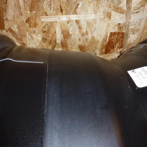

    Like this??
    You gotta start doing some DIY posts man, you’re a wealth of info. I had to look this up. I’m over here like tape a what!?!? :rofl:

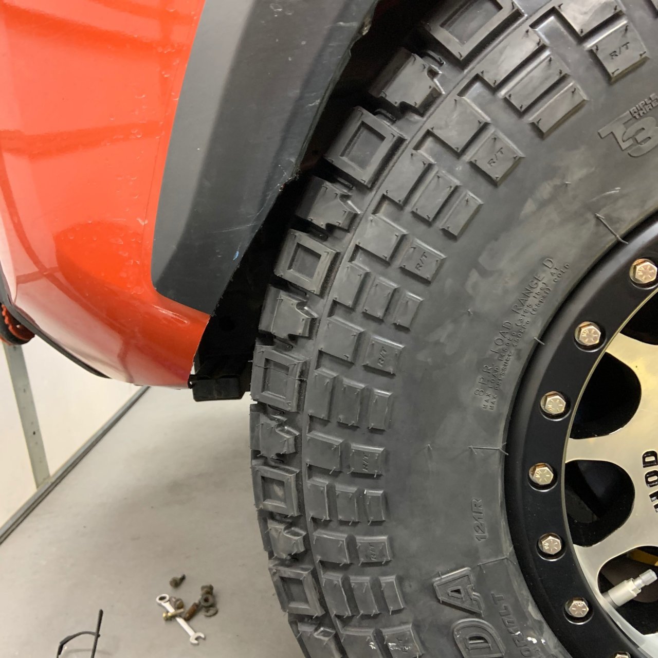

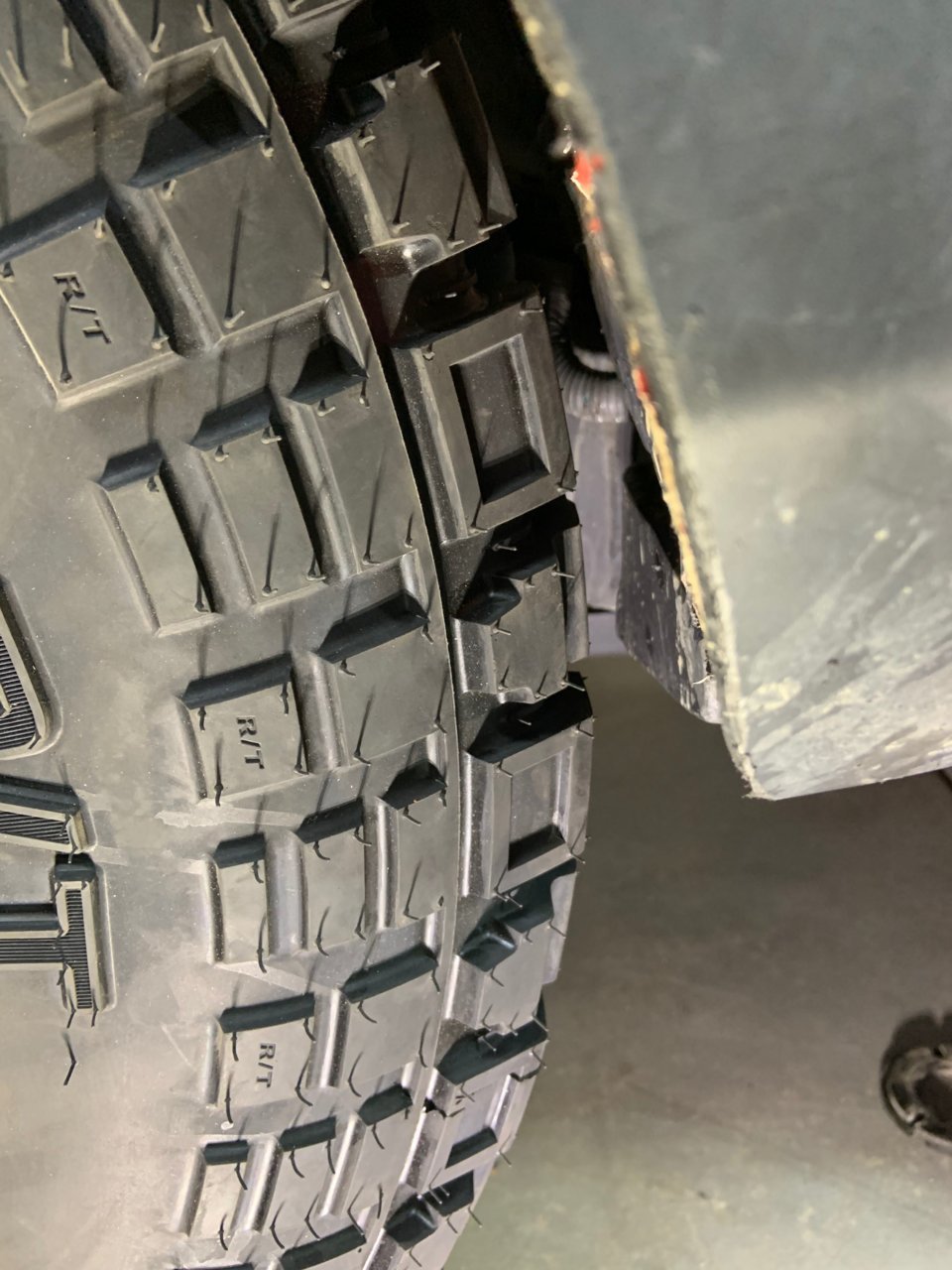

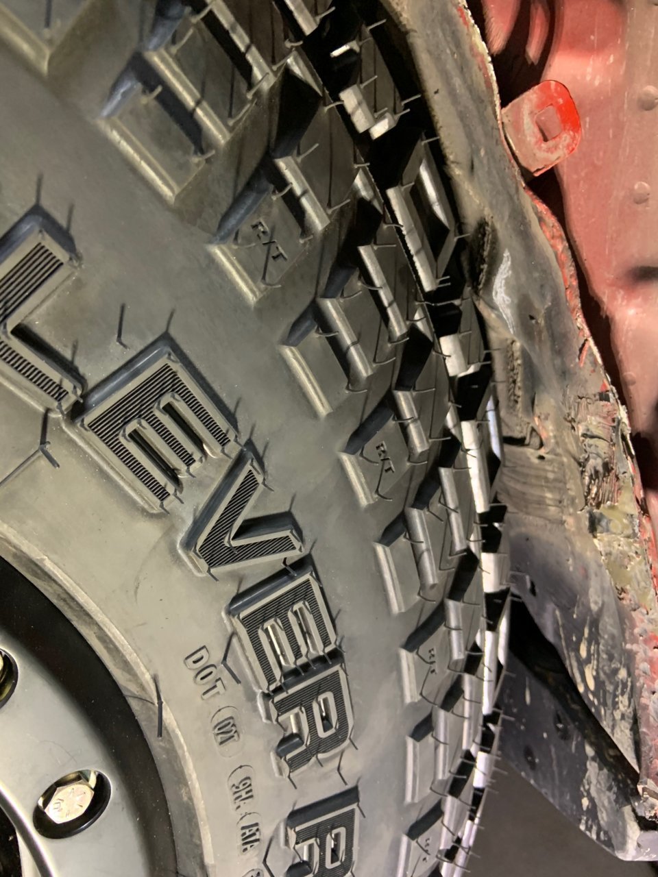

    Some final fender trimming and wheel well bashing done. These pictures are at full stuff, love that the tires and wheels are under the truck not hanging out. As you can see with the LCAs adjusted all the way forward you have lots of room with a standard CMC. Wheels are Method Racing 105 17"X8.5" 0mm offset and 4.75" backspace, with Kenda Klever 35"X10.5"X17" tires.

    What about using something like skate board tape or is that too rough. Do you get any bead leakage even slightly by taping them.

    Do I understand correctly that you were able to fit 35's without any fender trimming at all? You mentioned your wheels spec (16x8 4" backspace -12mm offset). What are your tire specs; LT315/75r16? If 35's fit without fender trimming, I'm not seeing much reason to stop at 33's. I would have to do just about as much work.

    I didn’t have to trim the fenders or flares running a 35x12.5
    I’ve replaced my bumper since this post with the C4 Hybrid.
    At the time I had a low profile bumper from SSO so had to do some minor trimming to the front plastic.

    Really good shit here. Gonna remember the gorilla tape trick for the future, as I don't think at the moment I need beadlocks for what I am doing. Though I'm pretty sure this conversation has happened to many people running 33, then 35 and so on
