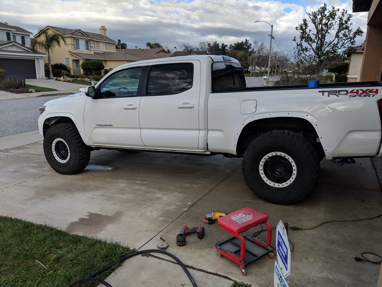

    I ran 35s on a bone stock suspension for 1000miles under the right conditions I could get the tire to rub the outside of the UCA, a change in back spacing would have completely eliminated the UCA rubbing. Also rubbed at the front of the wheel well on hard bottom outs, but they do that regardless of suspension

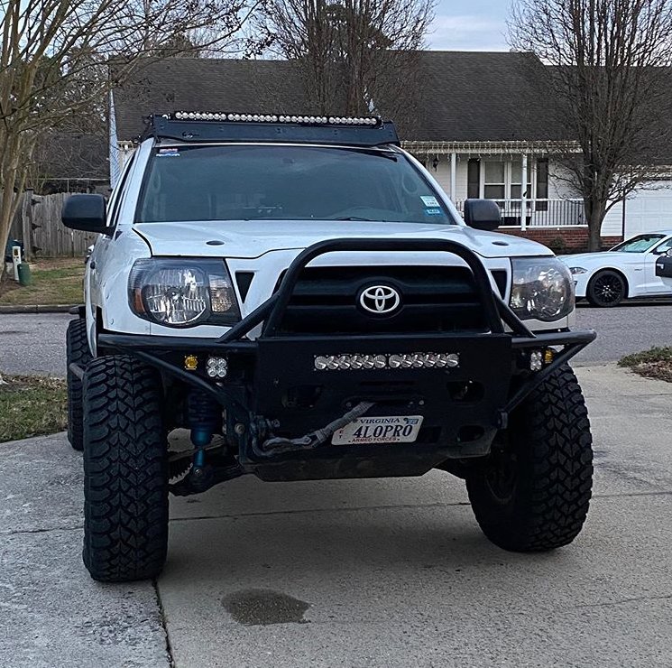

    This because min rim width for the bigger tires like 35s is 8.5"
    This our wings stop about an inch or so before the fenderwell. People stuffing bigger tires run into issues with the wheel well before the bumper.
