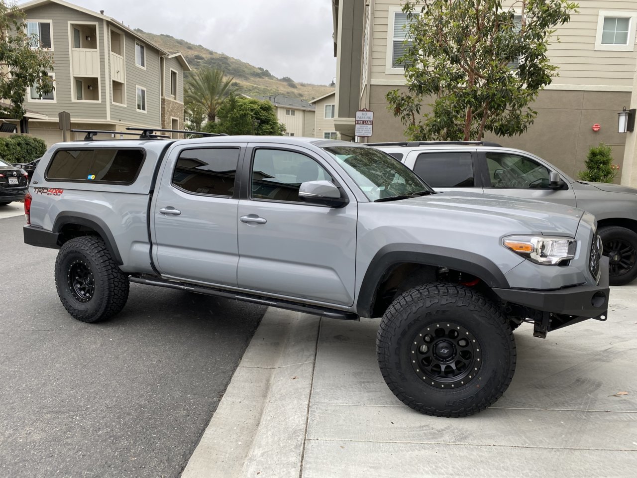

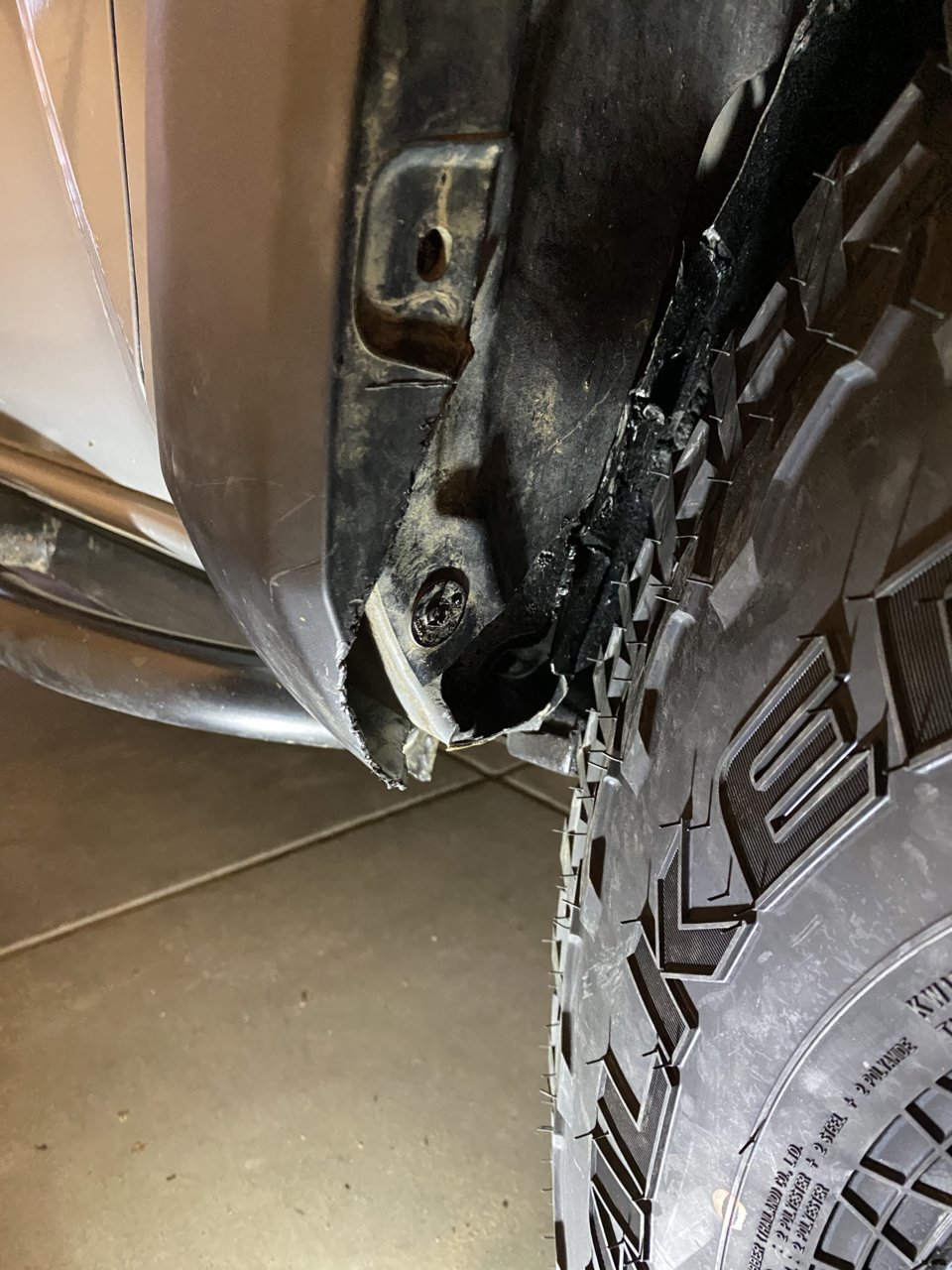

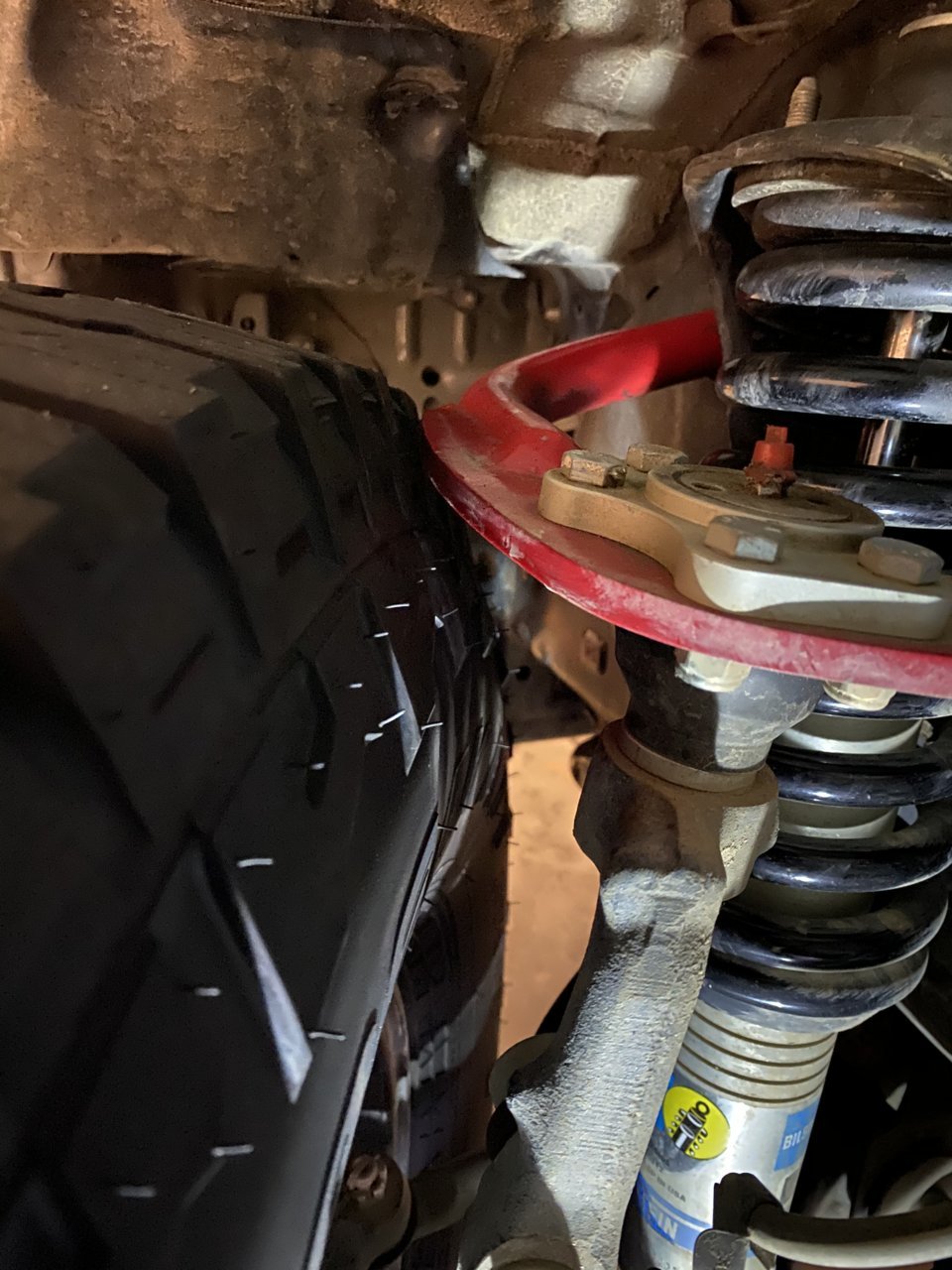

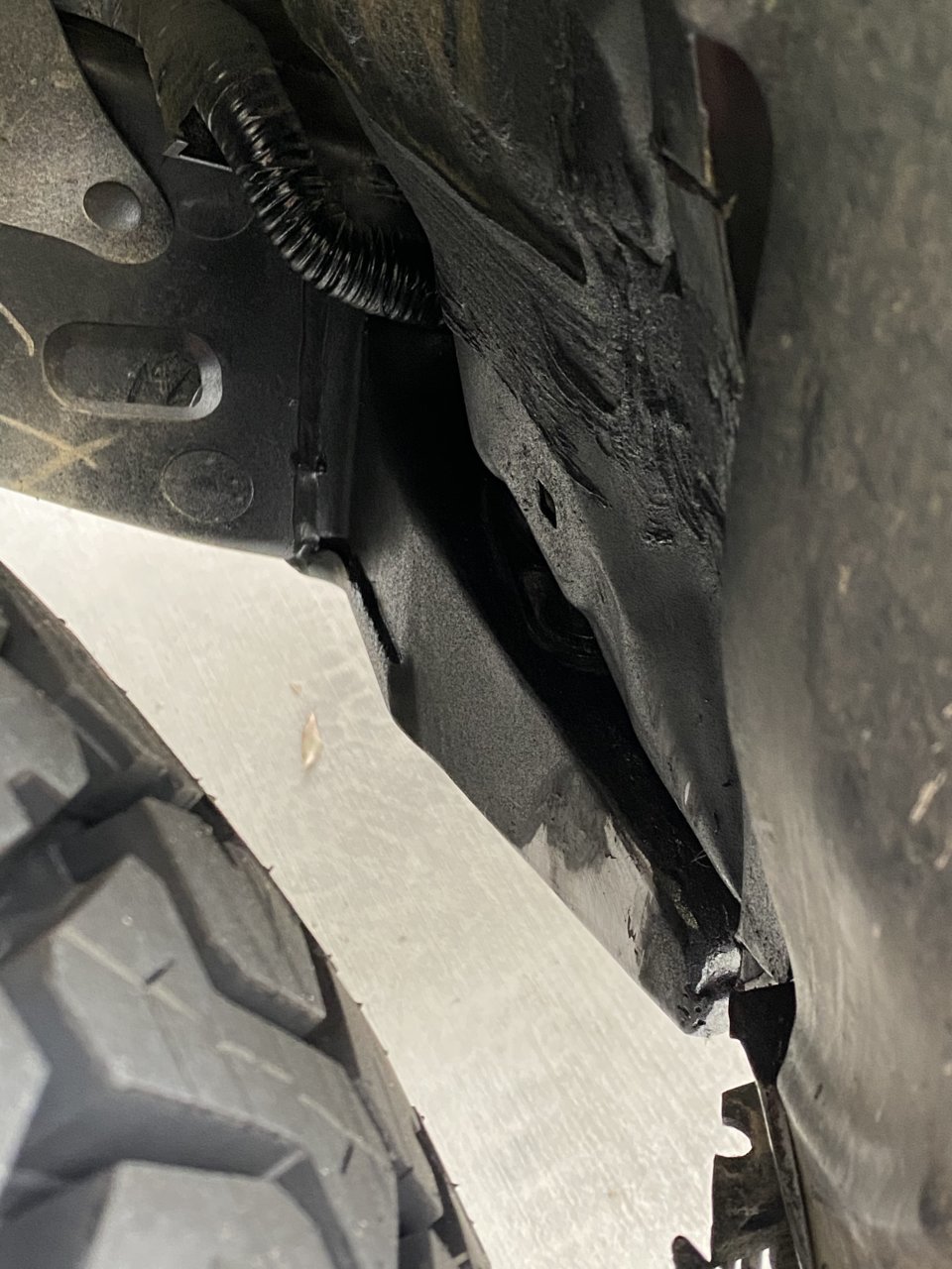

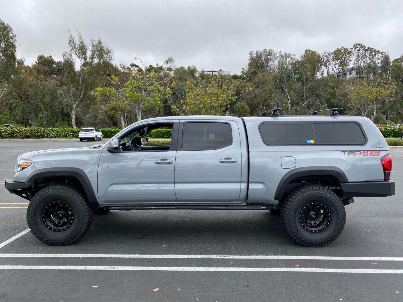

    35s are on. They look insane, so much clearance underneath.
    Trimmed plastic and metal back in the turn in point.
    Hit the JBA UCA on large turns. Ordered 0.5” Bora spacer.
    Still hitting cab mount. Need to cut more there.

    Pretty much exactly what @ovrlndkull said, I went with this kit because it seems to be more robust and gives alot of clearance. Also re-using the factory bushing is always nice incase you need replacement parts and OEM qaulity bushings are always amazing. I didn't need this to run 35s, I did need it for 37s.
    It really depends on what your plans are for the truck. If your LT and super wide it's alot harder to fit bigger tires and you won't rub cab mount as much as rubbing firewall. It also depends on your style of wheeling. 35s barely rubbed while rock crawling but higher speed stuff or jumping the truck you really need to tub and do a body mount relocate.

    I cut all the way back to the bolt on the top. The bit to the outside of the CM I hack off as well. That means the furthest out point from the body is the mount no more nub sticking past the mount. The closest matched thickness metal to the CM is 11ga. I get real aggressive with them on 35s to get as much clearance as possible. Truck looks awesome so clean!!!

    2019 Magnetic Gray TRD 4X4

    Looks awesome! Love the new SCS rims.
