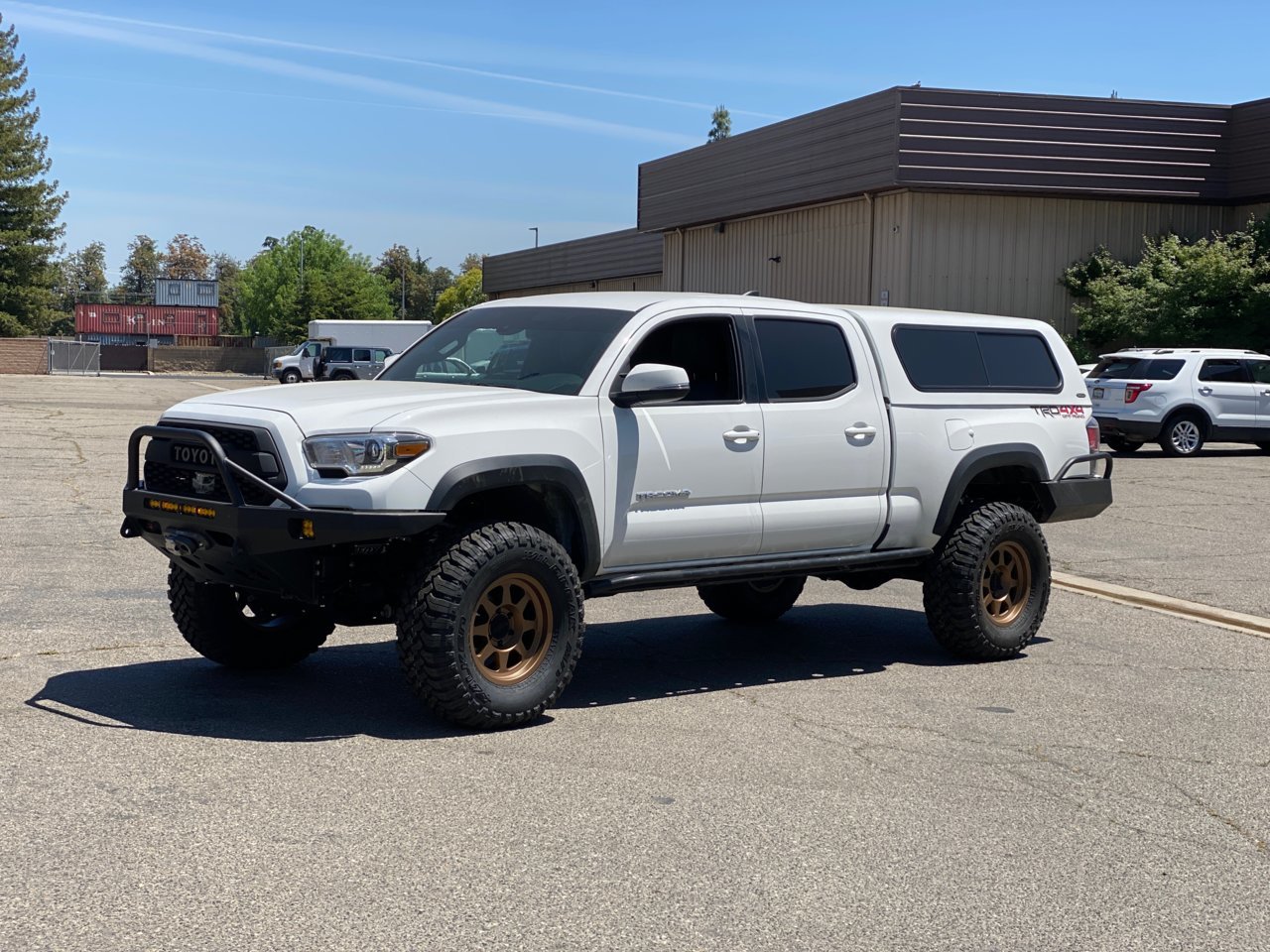

    Thanks again for the wealth of information here! After more cutting, bending, and heat molding I was able to successfully join the club today.
    After an alignment I suspect I'll have close to zero rub. I do need to look into some bumpstops, though. I don't want to unintentionally start a tubbing process with my fenders when I'm on a trail. :)

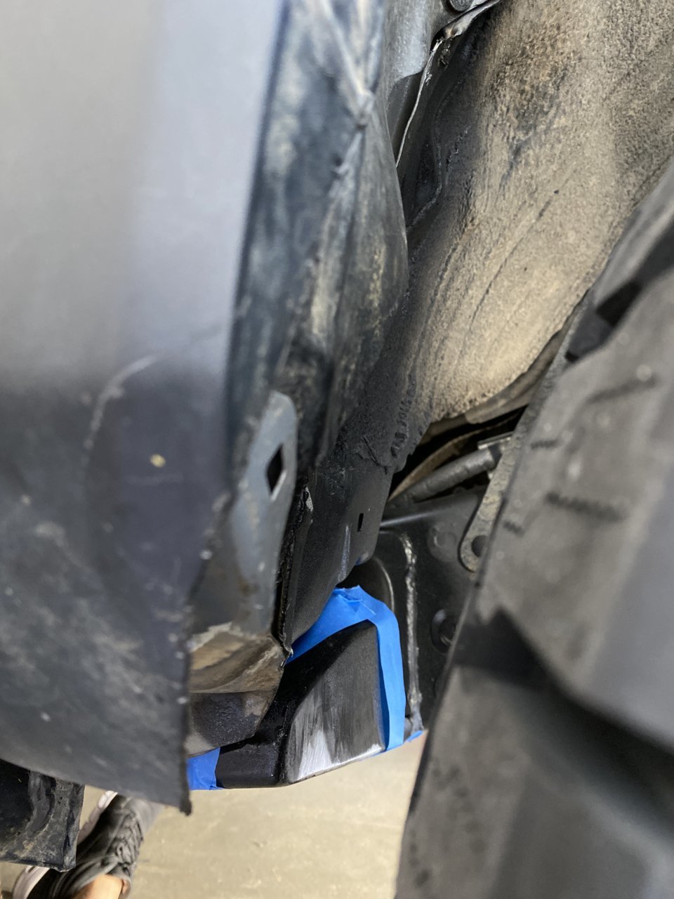

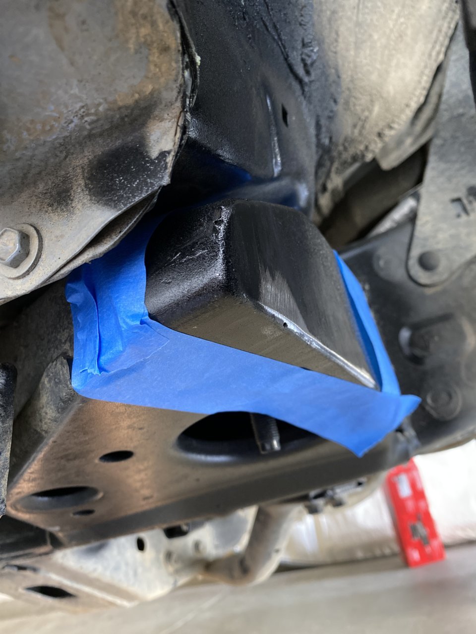

    Something like this? I know you said you cut the entire end off. Does that make it easier to cut? Don’t really see the benefit unless more piece of mind?
    Also, how the hell do you guys cut the top part with the fender wall there? Seems like it’d be difficult to get that part.

    4 inch grinder for most of it then a 3 inch cut off wheel in an air too. Cut the bottom first then work your way up dissecting it. Or find a buddy with a torch or plasma.

    Exactly like that for the most part. I'll go a little further inwards to the frame on the front face. I cut from the top just angle the cutoff wheel so that it doesn't hit. Also cut it off in sections to gain better access. If I have access to a plasma that's the easiest way. I've also used a sawzall for a big initial cut then finite with the cutoff wheel (is a little more crude this way).

    Thanks both. I get what you mean now. Seems like a couple ways to do it. So the bolt plate on top is pretty close to the cut already. I’m guessing the replacement plate will have to be at an angle since I’ll be cutting more away at the bottom than the top?

    Yes. The typical CMC plates we sell are 11ga that's the closest matched thickness to the frame where it is single thickness. I've used 3/16" (a little overkill) and also have just left them completely open. If I'm doing a really aggressive I use paper or like a manilla folder to make the shape then cut it out. Tack it in then hammer it around the corner tack, hammer, tack etc. until it's the shape it needs to be.
