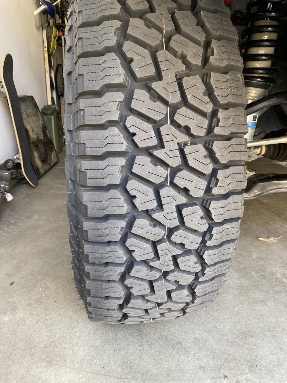

    What’re you guys running on pressure? Currently at 31 cold. I think I’m still too high looking at the dirt collection. Don’t have chalk currently. Running probably 6-700 lbs more than stock.

    So on my 33 E-Loads I run 42 lbs because my truck is a fat pig now. On the 35s run 20psi but that was a chalk test. The tire inflation tables dont go low enough for our load ratings for these size tires but using some general math a 315/70/17 or whatever looks to need about 25-30 psi to meet the load requirements of about 2100

    I run 30 lb air haven't chalk test but I'm just going by feel and handling and stuff like that and the way the tire looks Don't really want to go much lower than that mine are also C load range tires so the max pressure is only like 65 I think or 50

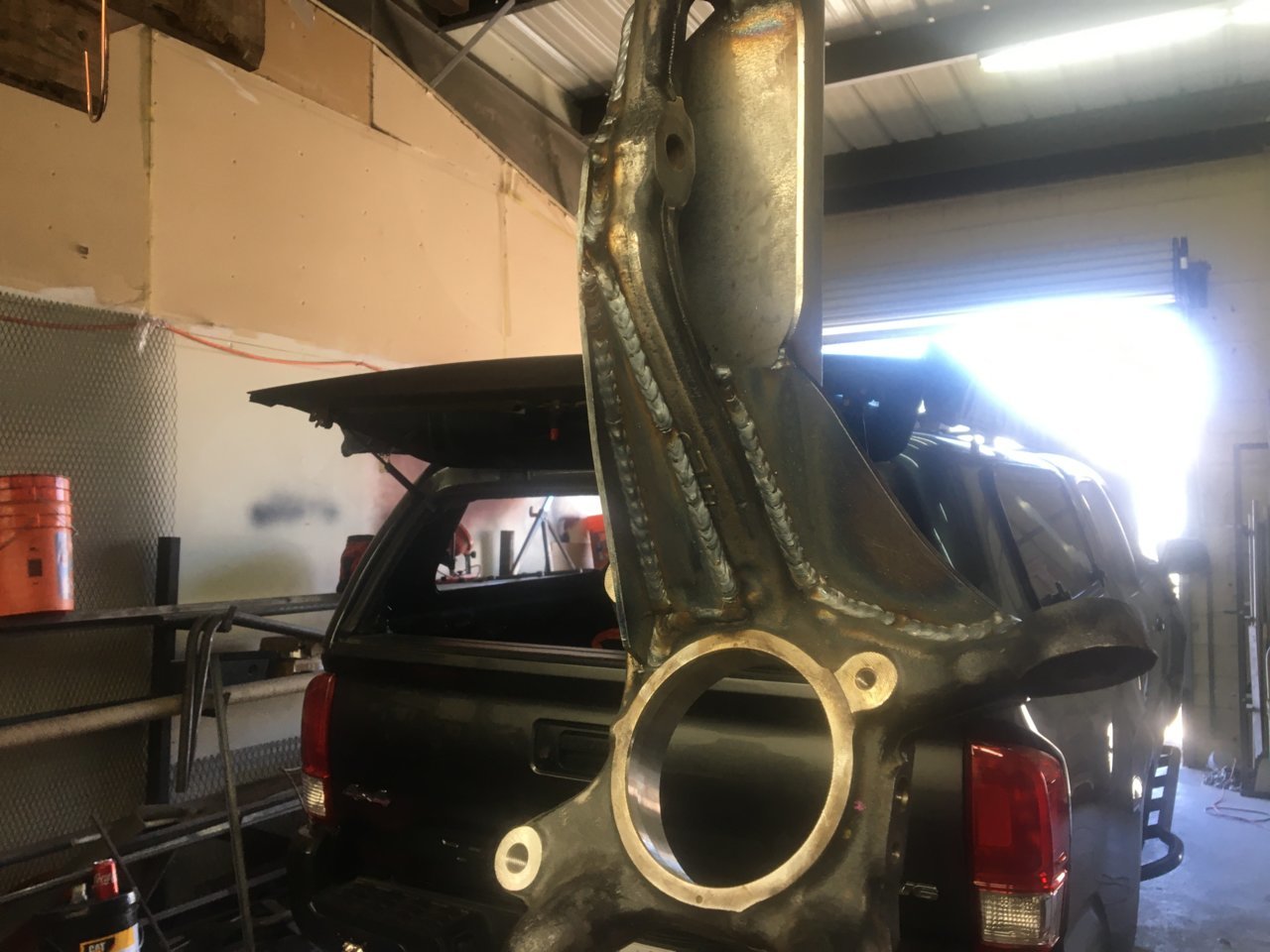

    I welded up the total chaos spindle gussets today.
