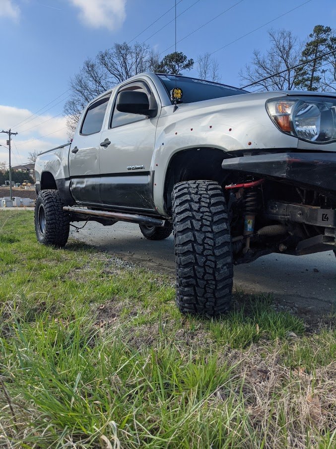

    2018 Tacoma TRD DCLB
    Too many.
    Before and after

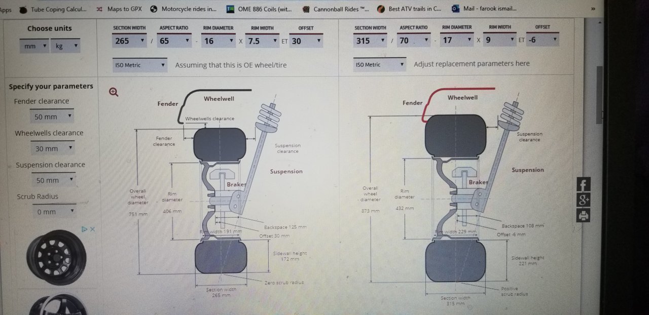

    anyone running a 17x9 with a -6 offset? with there 315's or 35's?

    This shows it might work.
