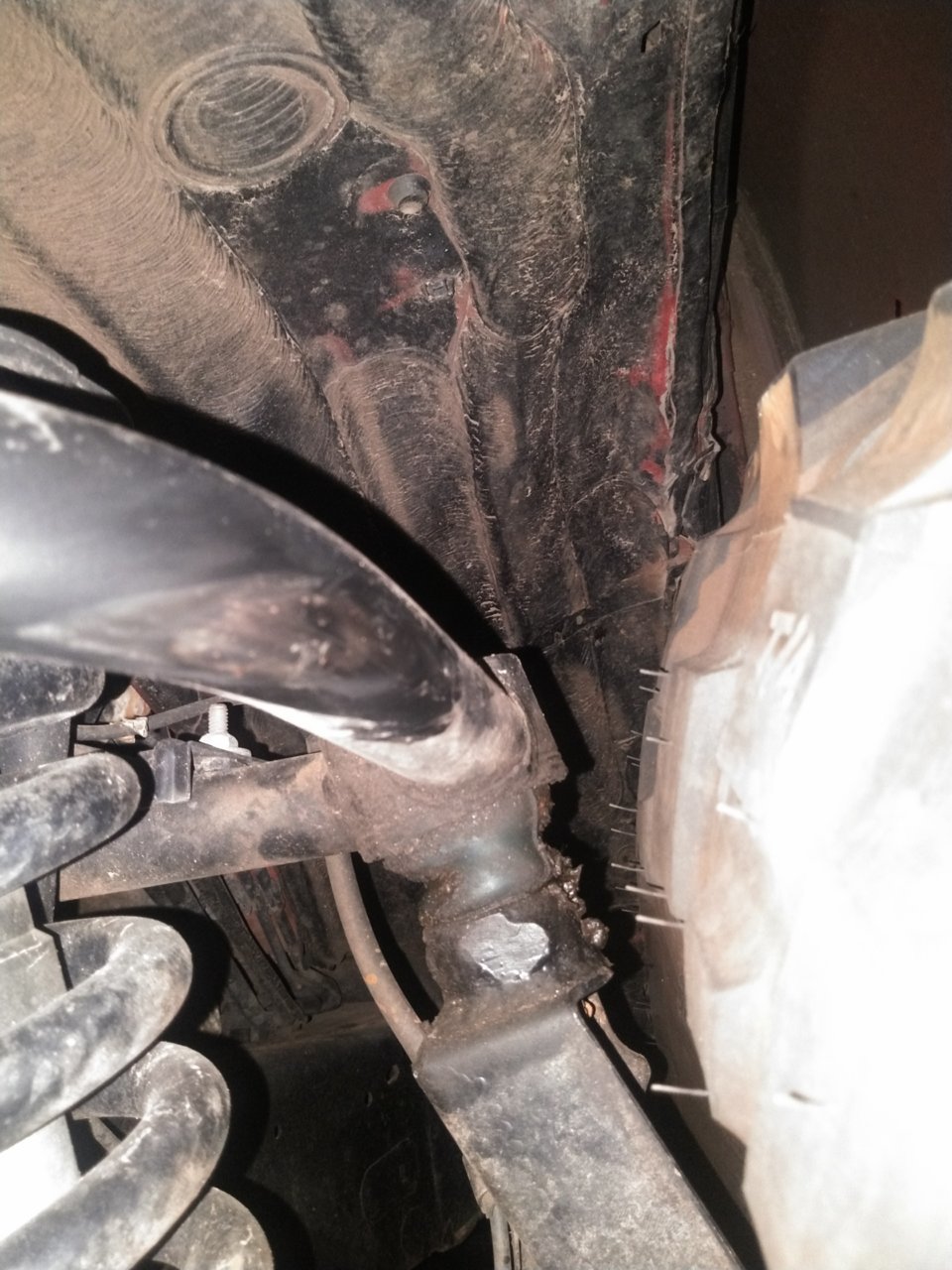

    You've got plenty of offset.

    Mine's been off for i don't know how long know. I still hang clover leafs on and off the hwy at 35+ it just feels kinda like a trophy truck lifting the inside wheel off the ground now (doesn't actually do that, I save the air time for the trails).
    Yes remove the sway bar if you want more articulation. If you keep the tools with you and want to run it on the street just arrive early before offroading and disconnect. Glorified welder was just saying that the TC gussets that are meant to retain the sway bar are the stronger ones on the market by the big suspension manufacturers. They better support the flimsy stalk and out tie rod attachment.

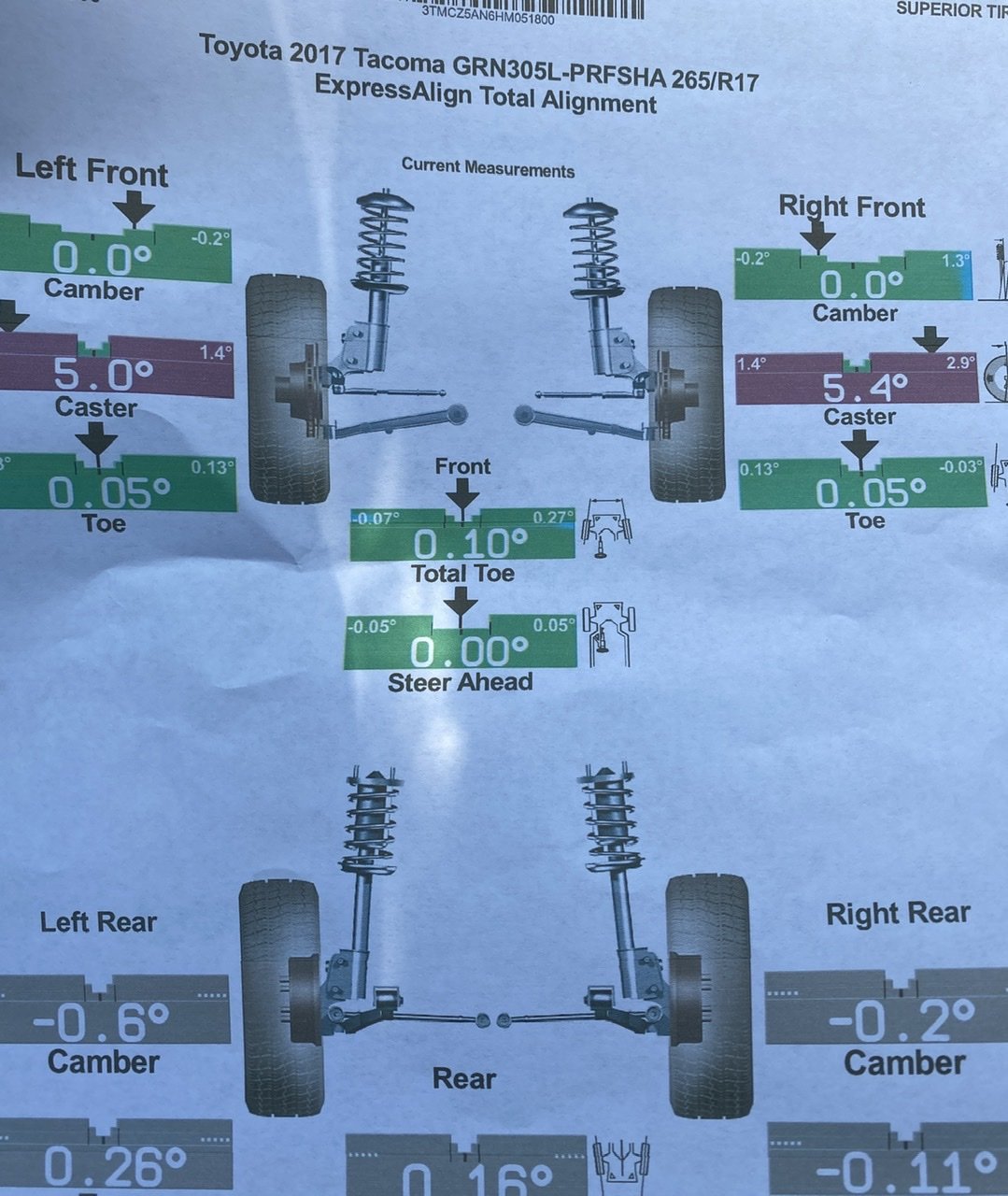

    Ok so 2017, 35” km3s, 3” lift on king coilovers, camburg uniball ucas and cmc done. Alignment tech was able to get me these numbers. Is this ok? I don’t rub the cab mount except slightly at full turn full flex. Seems to drive fine. Am I good? Or is the caster too high?

    I ran it like that for a long time. High caster has alot of return to center, so steering wheel might snap back a little. It might also follow ruts more.

    what do you run at now?

    About the same. A little closer to 6 degrees. I tried 3 degrees and rubbed too much. Im also on 37s now tho but alignment hasnt changed.

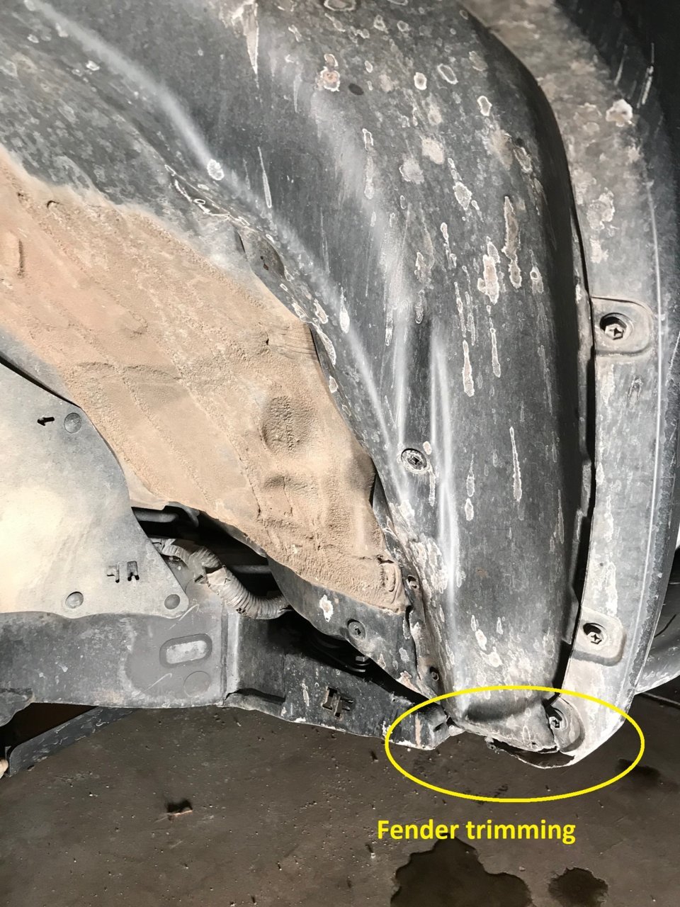

    How are you protecting the intake with the fender liner removed or cut besides a snorkel ?

    My fender liners are still in place so they still provide a lot of protection. With the snorkel however the intake is completely protected.
    I never trimmed the fenders so ...

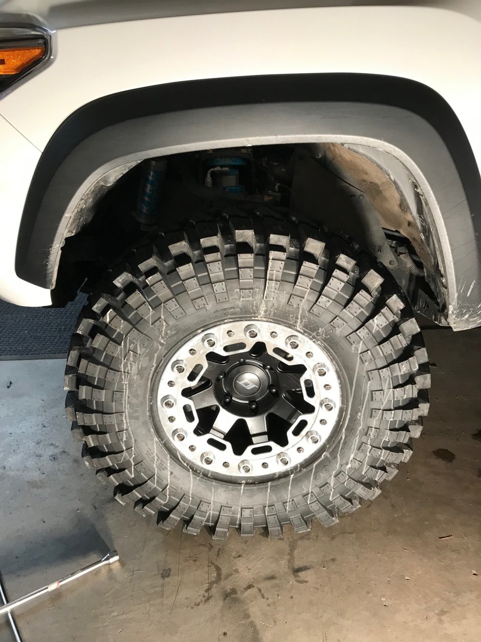

    Okay guys I am stoked! Probably need to trim more with the grinder but that’s easy while it’s open. I can full lock around town, it’s so nice :rofl:

    Good work man!
    AND your jack stands arent being recalled like every single set of mine!
