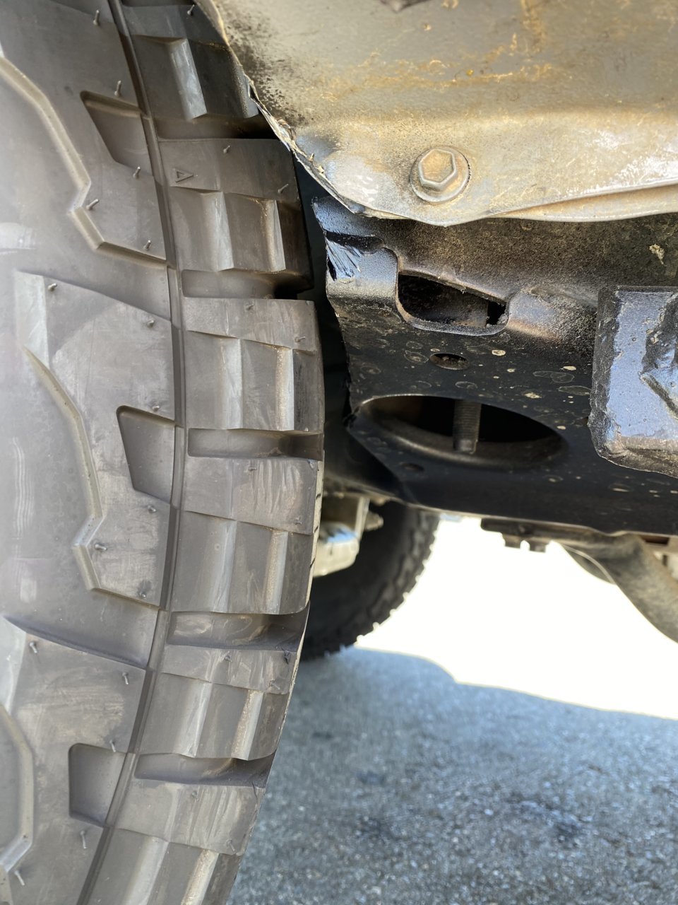

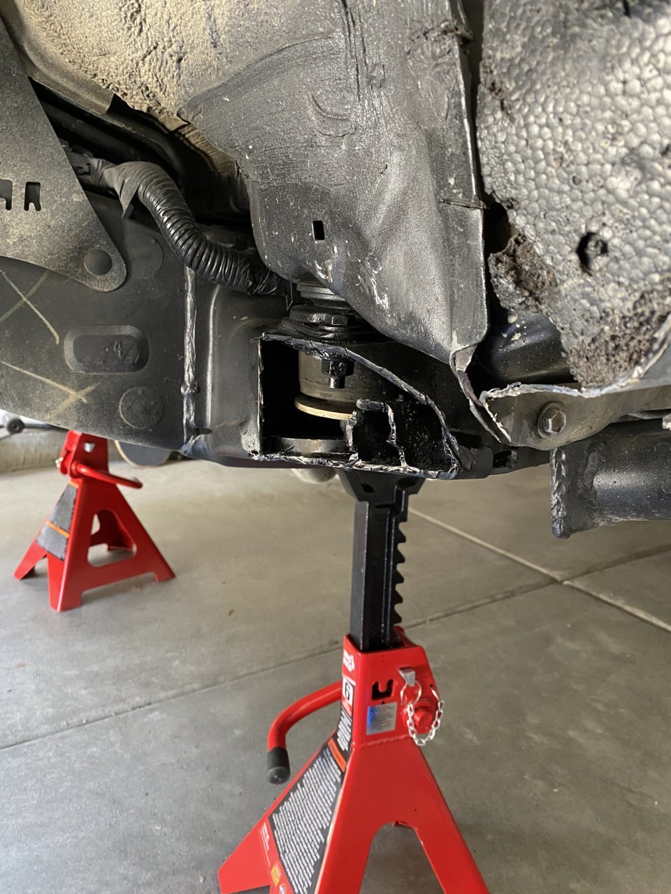

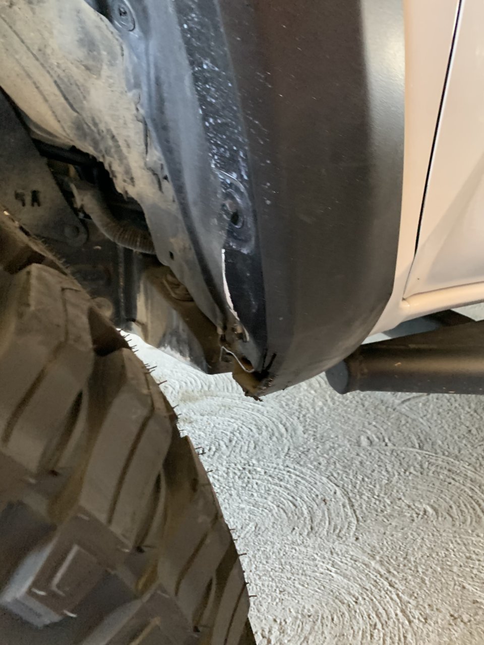

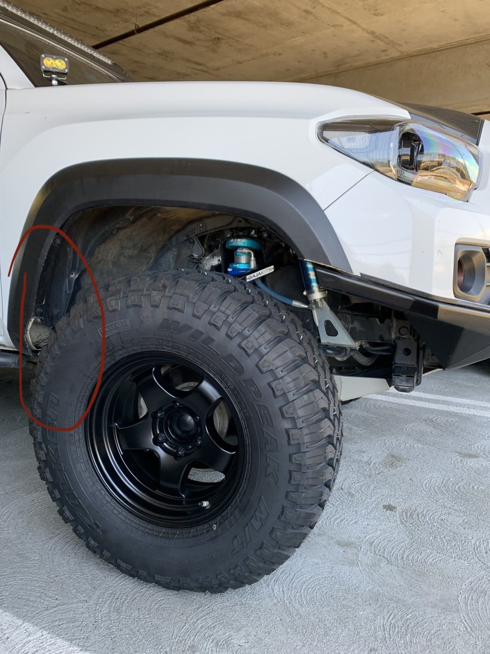

  13. Jun 3, 2020 at 2:21 PM
    #853
    Thorian
    Thorian Well-Known Member
    Mar 14, 2018
    #247330
    641
    Marco
    Los Angeles, CA
    2017 4x4 White Tacoma
    Kings 2.5 Front and Rear, Baja Kit UCAs, Dakar Medium Leaf Pack, SSO Slimline Bumper
    Oh boy! So I just upgraded from 285/70/17 falken at to 315/70/17 falken mts and work wheels....I couldn’t leave the tire shop
    as soon as I tried pulling out and turning the wheels a bit I started running smh!
    I was naive to think I’d be ok.
    so the shop was kind enough to loan me a grinder so i chipped away at the area on the fender next to the cab mount...
    not very pretty but good enough to get me on the road until I can get a pro to do it for me.
    Edit: I already had a cmc but I’m now rubbing a bit non the cab mount and that’s on pavement, so definitely going to need a more aggressive cmc.
    so thats my warning to those looking to upgrade. I can’t wait to get the cuts cleaned up and the more aggressive cmc then it will all be worth it....I hope

    Haha went through the same thing. But I only had to make about 3-4 turns to get home to my grinder. Looks great! More :sawzall: is needed I’m sure.

    Thanks man, I’m a little bummed about having to do the cuts myself and want to get it all cleaned up, I should be ecstatic but i like you hit trails and I know I can’t until I get my clearance fixed.
    So let that be a lesson to those considering it, don’t be stubborn like me. Make sure you get your trimming down prior to getting for the tire shop lol
    other than that I’m happy and will be regearing soon (that re gear group buy better stop messing up though)

    Yup your wheel and alignment combo will contribute to how much you need to trim. Will be slightly different for everyone.

    Also I have wheel spacers. That probably made it worse
