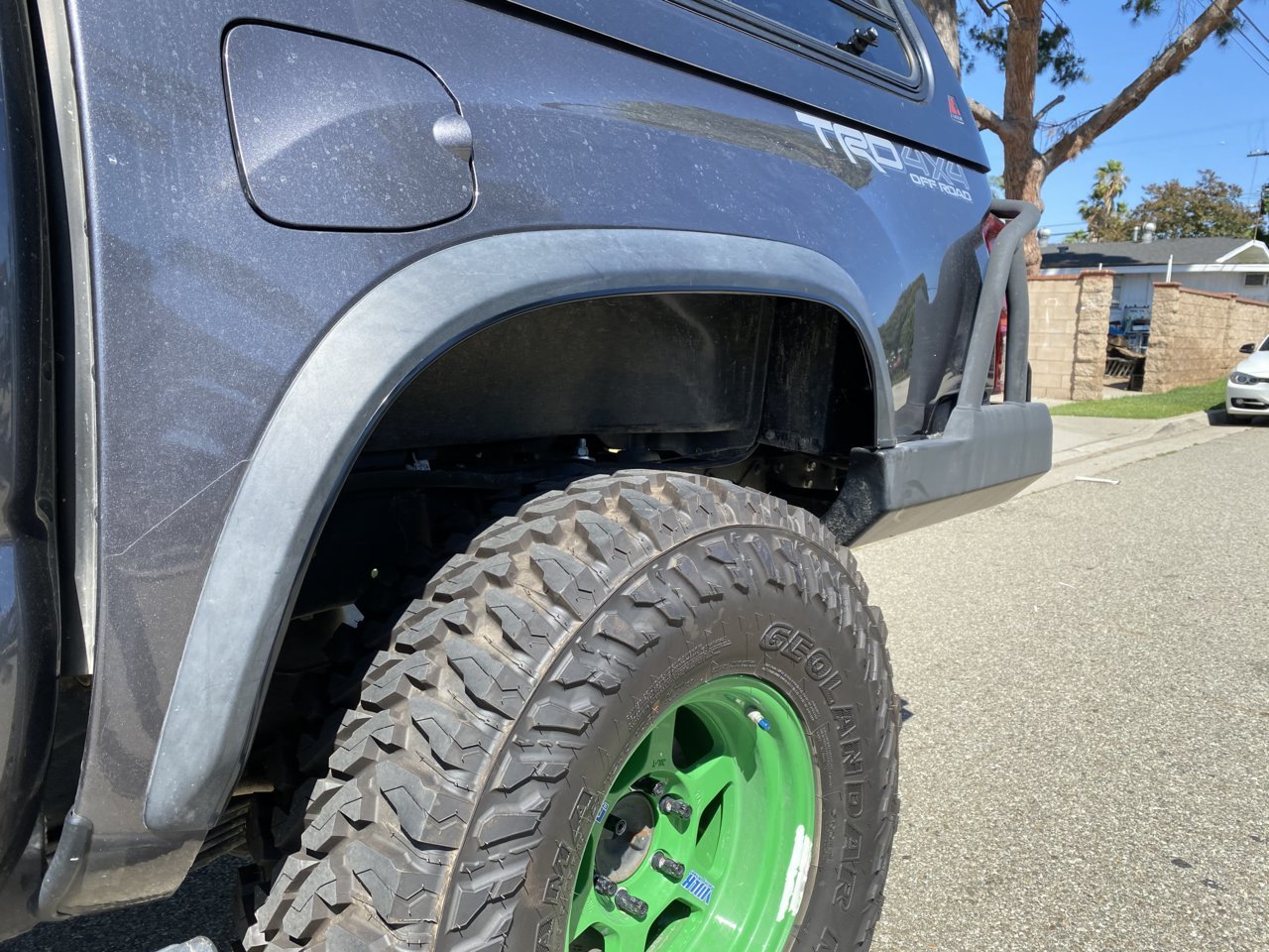

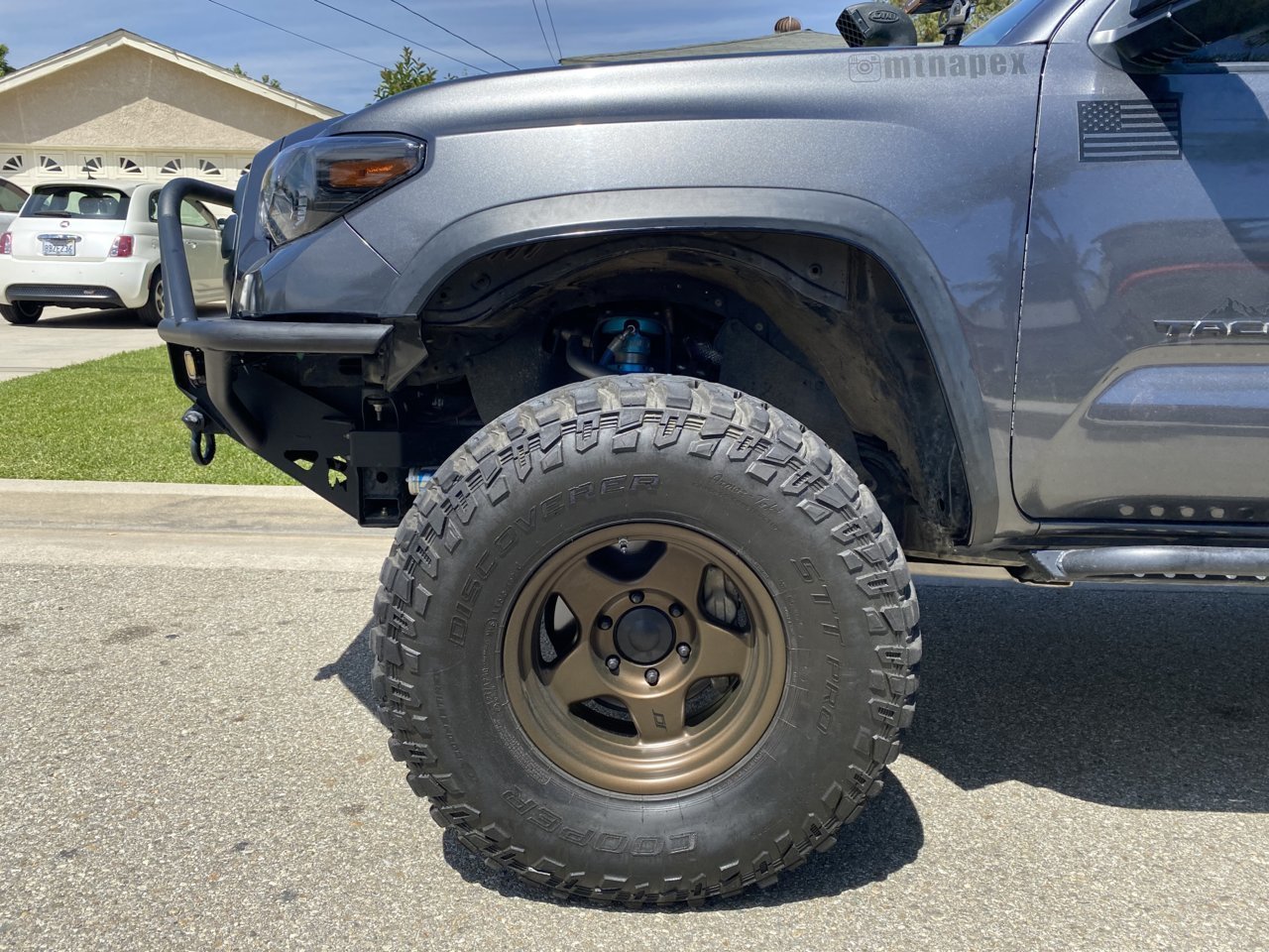

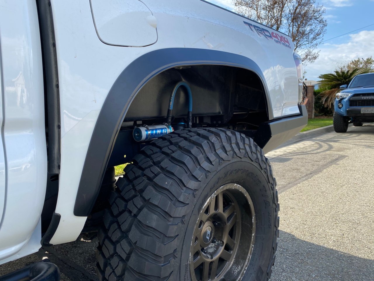

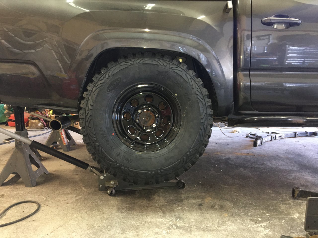

    Hey guys. I just wanted to drop these pics of a couple 3rd gens I trimmed the fenders on. Both on ~3" kits with 35's and now have full clearance at full bump, lock to lock!

    Yea... I like these more than a friend.

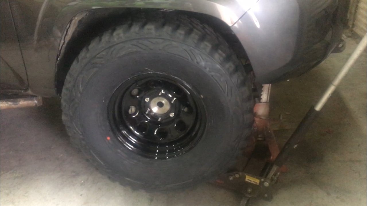

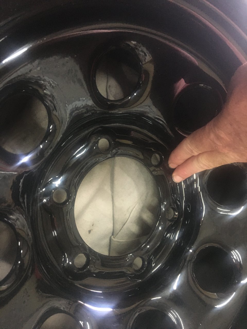

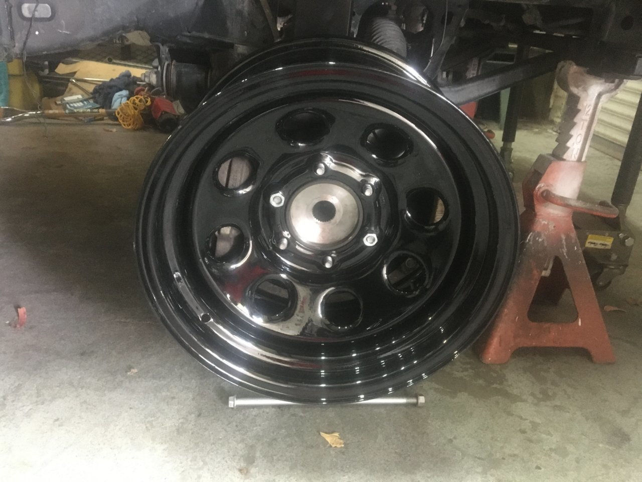

    My custom steel rims came in yesterday!!! Here’s a few pictures. No shim or spacers needed to clear caliper and USA :oldglory:made. 16 x 8 with 3.75 backspace. I couldn’t be happier. Rims weigh 32 pounds each. Will update total weight wheel and tire later today.
    Indoor photos suck, waiting on parts to revalve fox 2.5s and icon rear springs, which have no eta and back ordered.....
    you can see the deep dish here for caliper clearance.
    ample clearance from spindle gusset
    Only sticks out an inch on my SR. I think factory or aftermarket flairs will cover them.

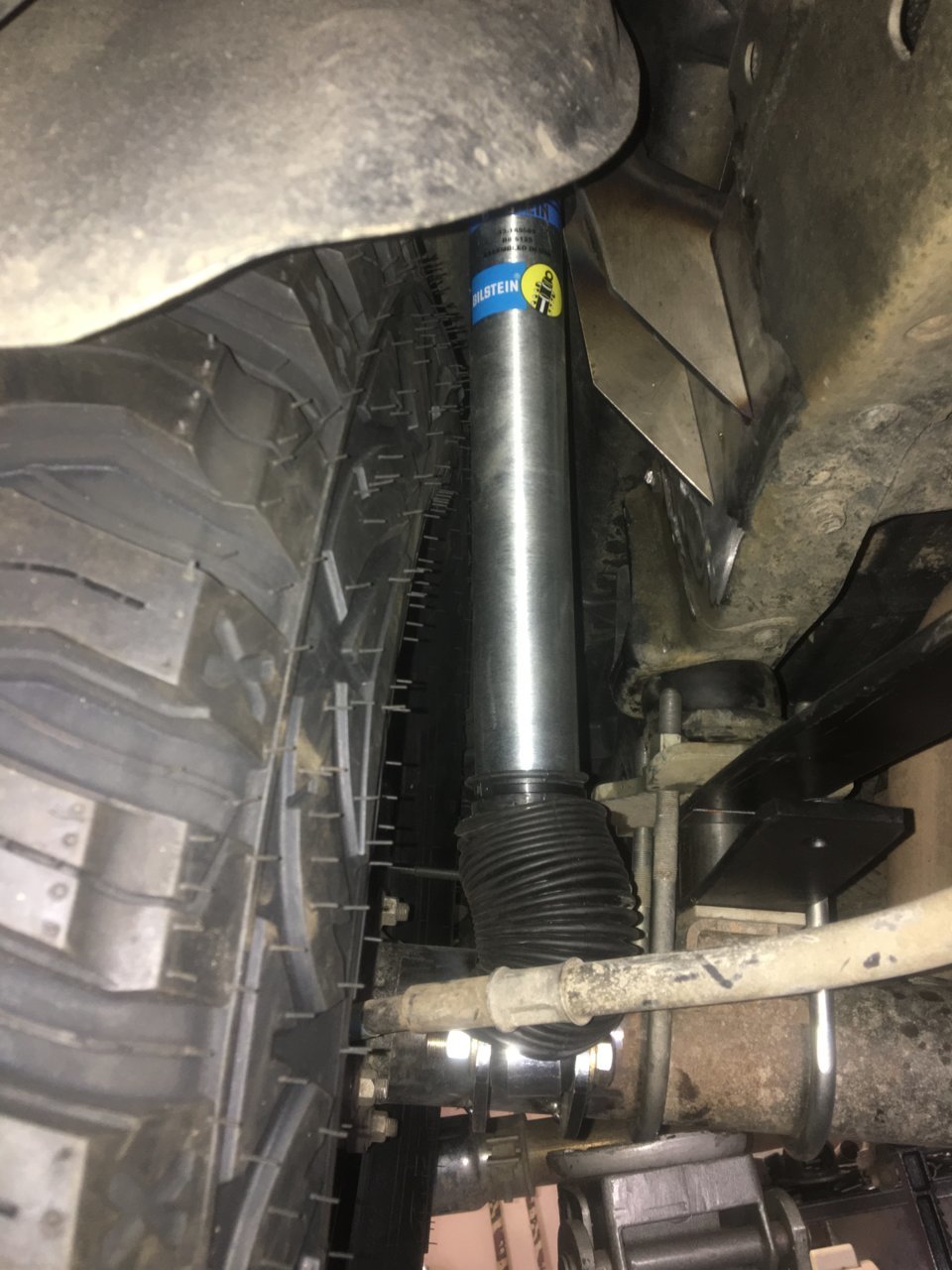

    Out of the blue my back ordered icon springs came in, I was able to cycle suspension and weld in the BAMF @JLee shock relocation mounts today. Bilstiens will be replaced with fox 2.0s once those are off backorder...
    Clears with 3/8 of an inch.

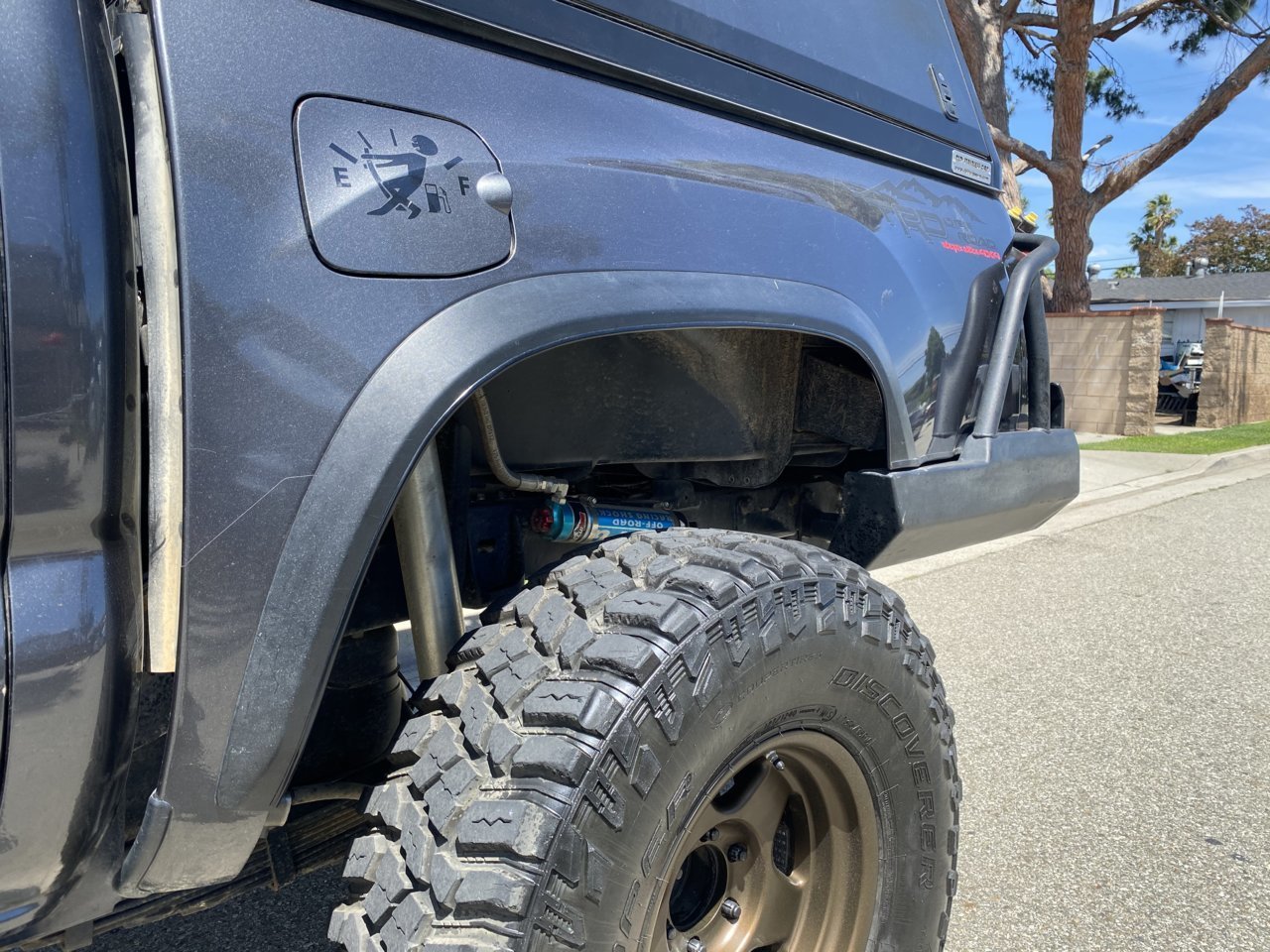

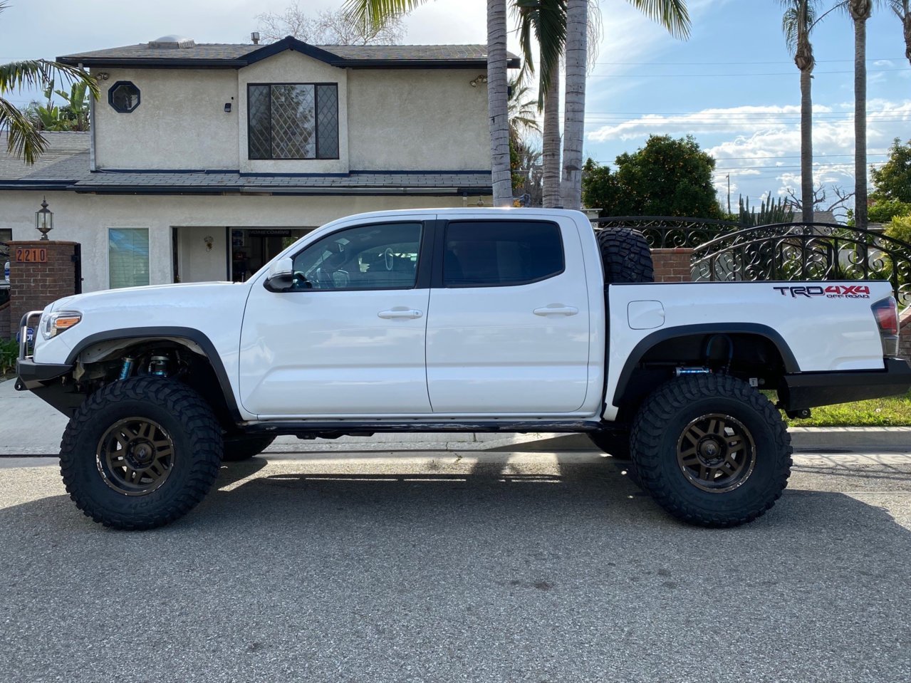

    Did another third gen fender trim to clear 35’s. 2”’off the flares and 2.5” off the body.

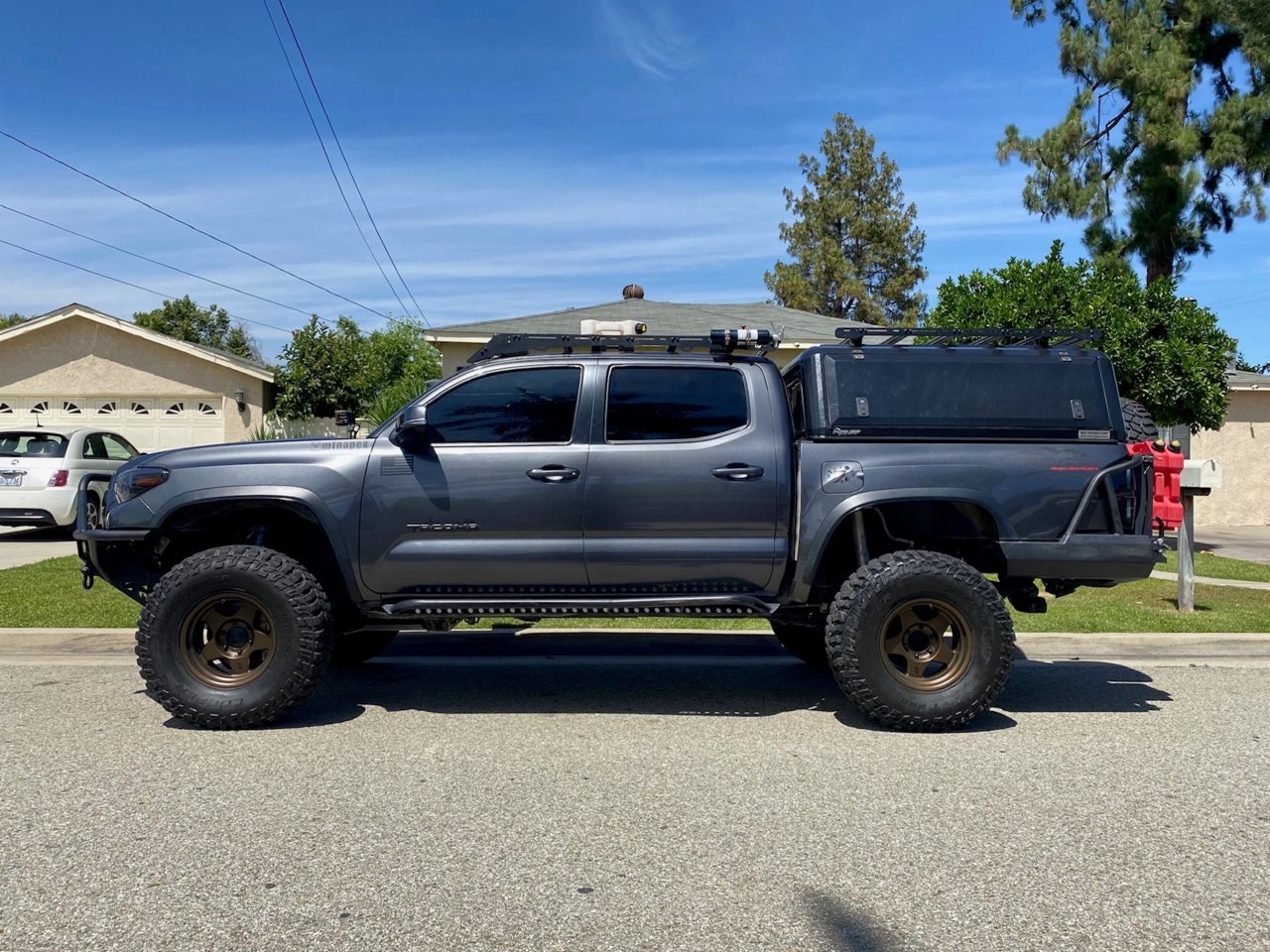

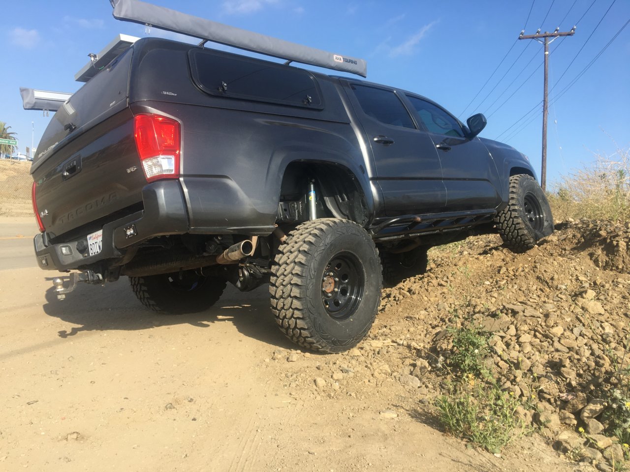

    35’s are flexing nicely, truck gets an alignment today!

    No more rubbing for @Thorian :cool: 2.5" Fender Trim and I cleaned up the previous cuts a bit before adding the final molding.
