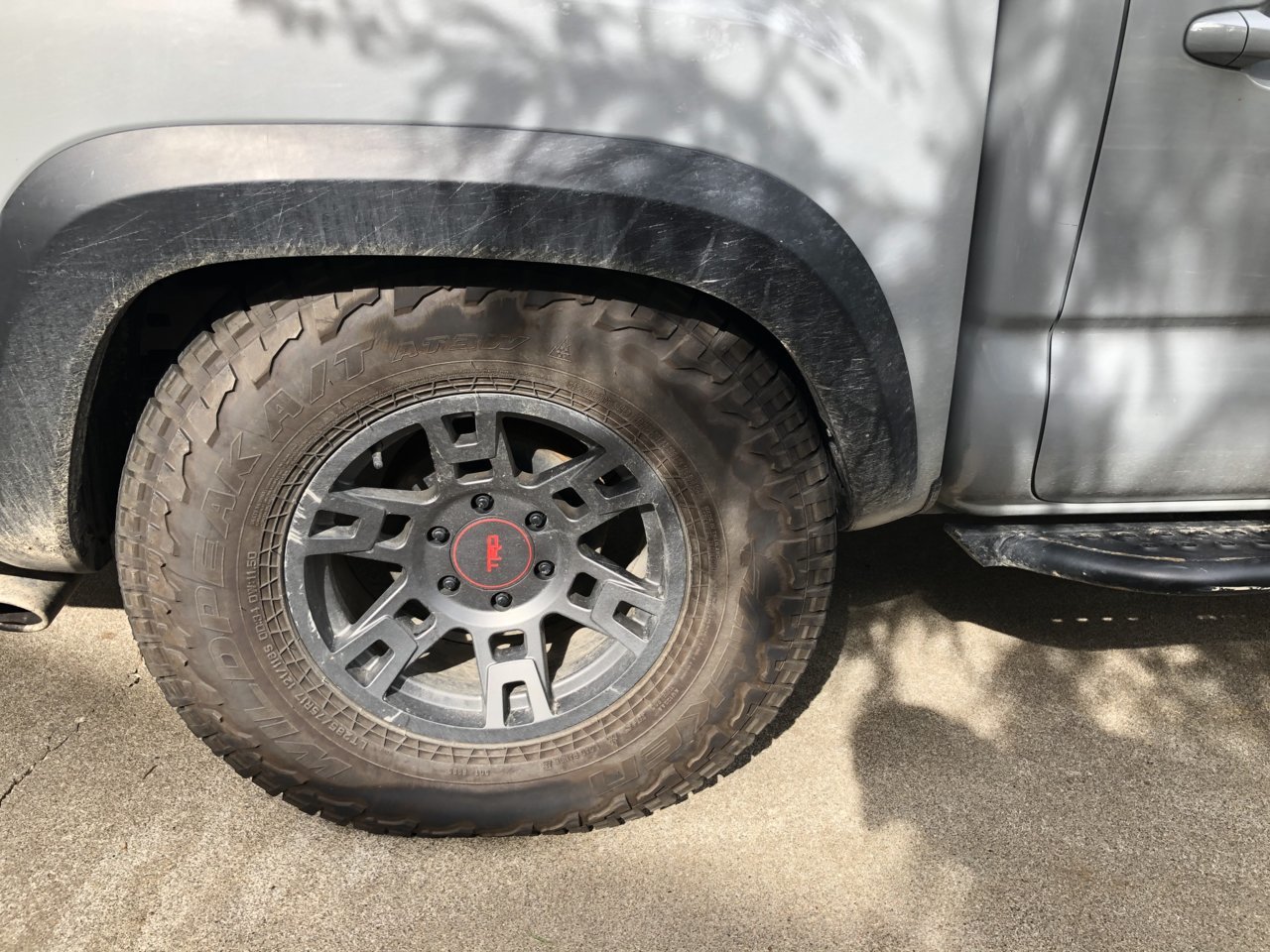

    How do you not rub the front of the rear wheel opening? It’s super close for me with 34’s. I would be shocked if I could clear anything taller but I still want to try.:bananadead:

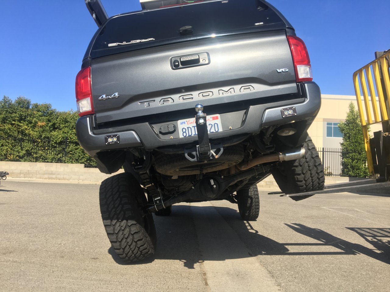

    It kind of looks like the face of your wheel is angled forward :confused: and does it look like your exhaust is about to touch your fender? Did you bend it upwards?

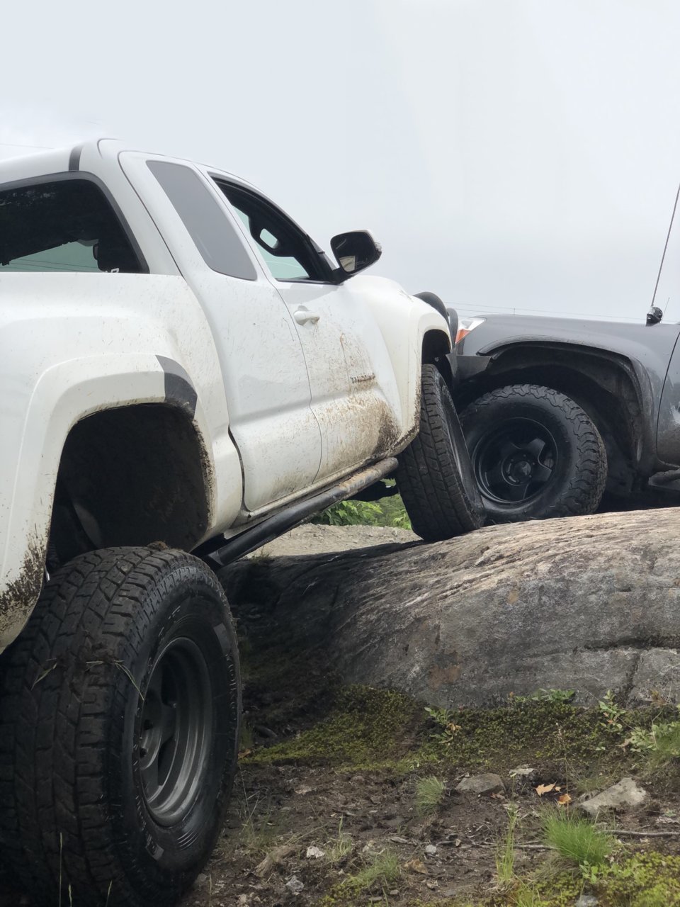

    Here’s mine. Not even fully stuffed in this but plenty of room up front.:notsure:

    The camera wasn’t completely square to the truck. Wheel is not bent or angled. Exhaust exits normally.
    Stuff that tire and see where it ends up. Looks like you have tons of bump travel left.

    Yeah maybe another inch at bumpstop. Running wheelers bumps and not sure how much they limit travel compared to stock. That’s the only pic I have close to the front with some up travel.

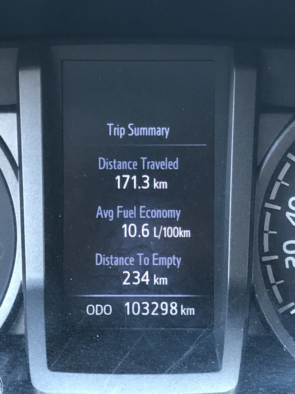

    21.5 on stock gears or 370 miles per tank roughly, my computers are adjusted to a tire size :anonymous: 4.30 gears.

    lol i have never got that good mileage on stock tires. You must be driving it like baba.

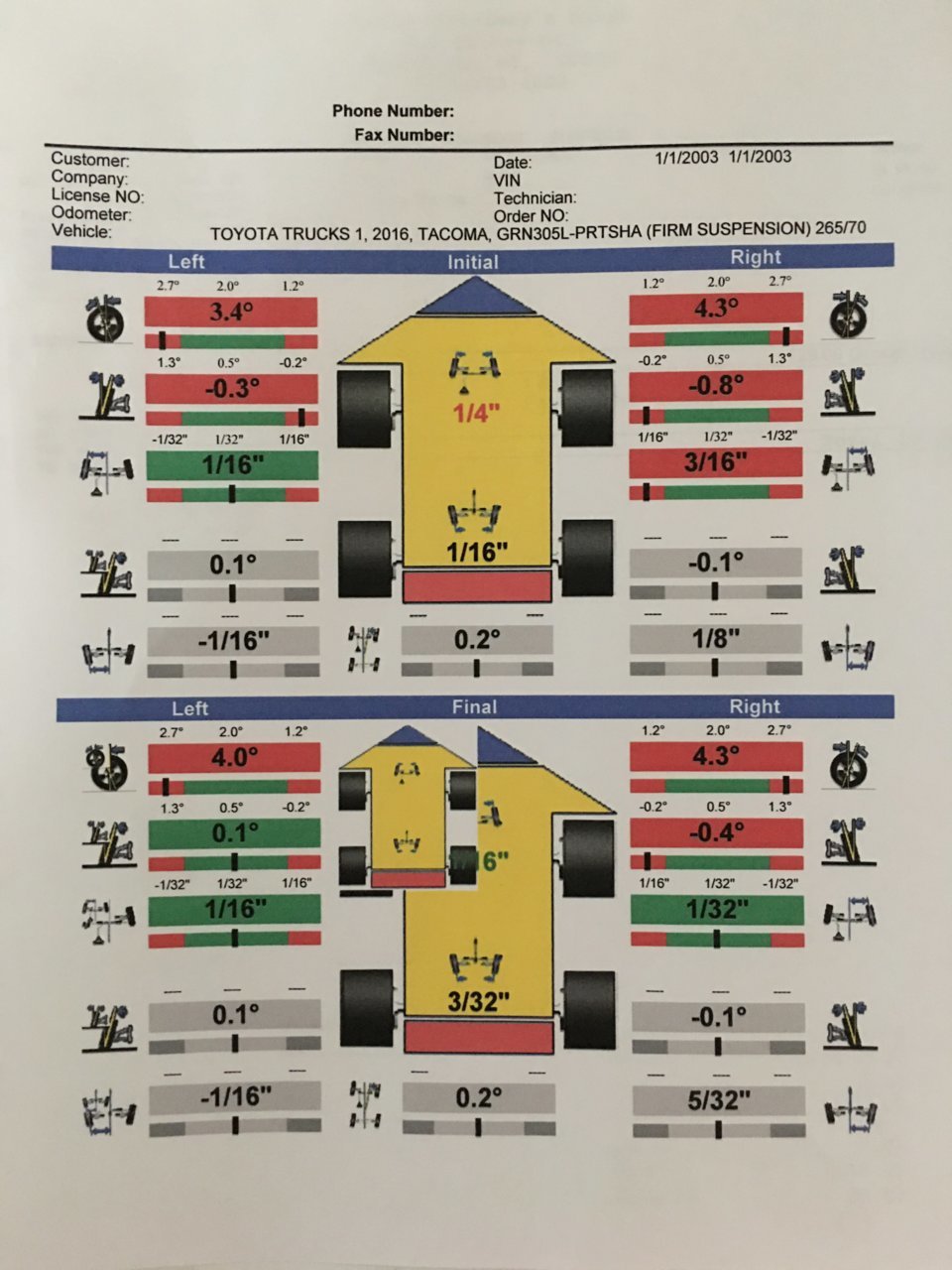

    Slow AF granny*
    Key is to keep it at 2,000rpm and it goes long way.
    Here is my recent one right after I twisted steering shaft and had to move steering wheel 1/2 an hour at the column and adjust tie rod.

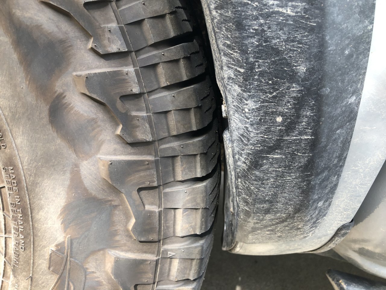

    Yes, they still rub more or less against the cab itself, my cab mounts are gone and replaced with alpine.

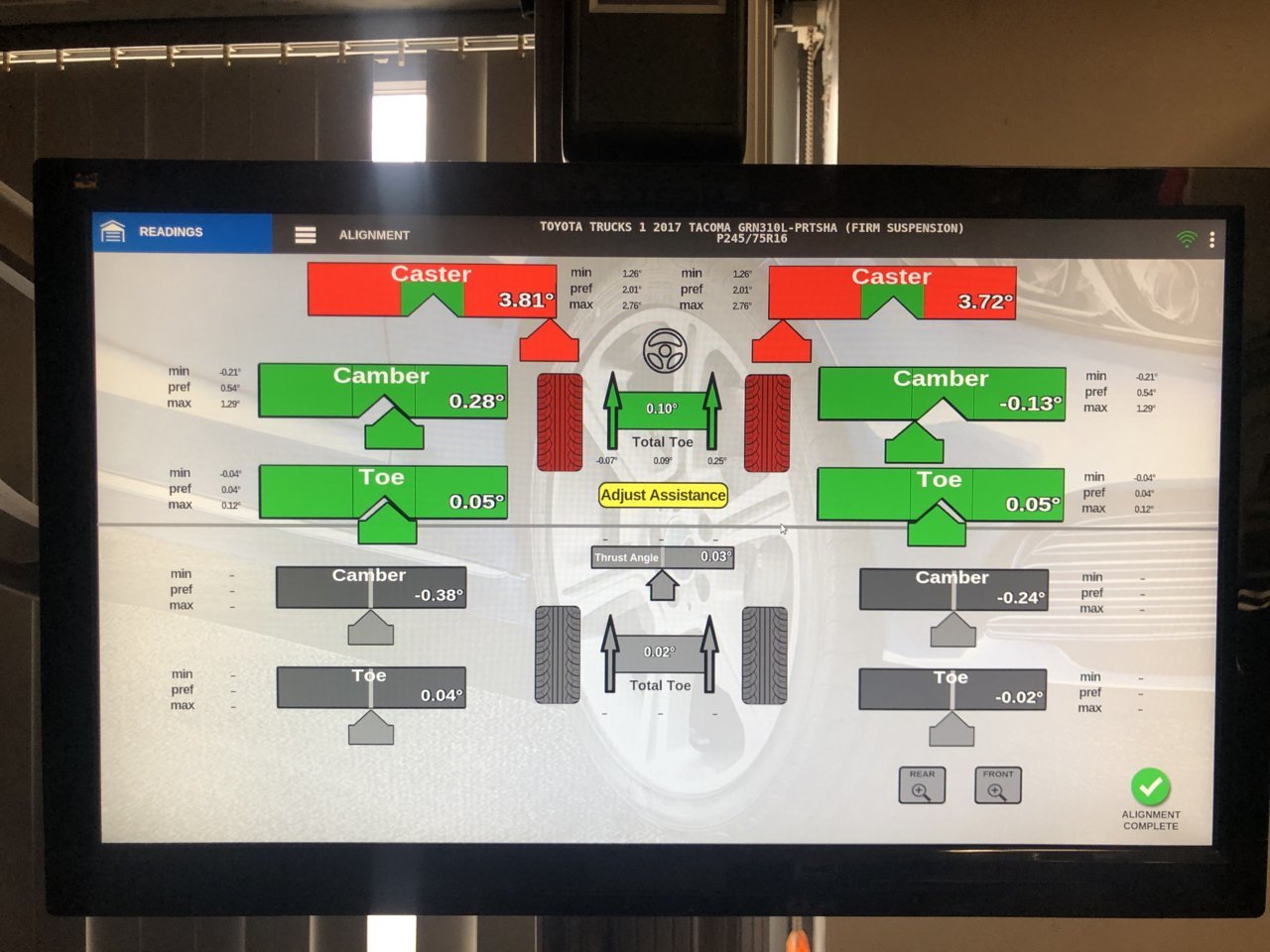

    35’s mounted earlier this week and alignment, after adding UCA’s and ADS front coilovers.

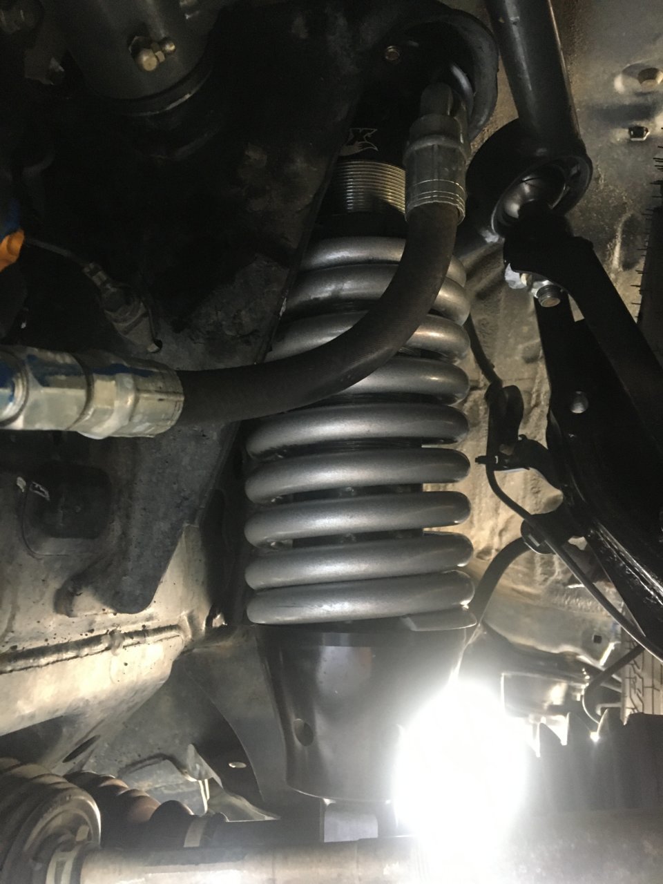

    Final testing before this weekend’s camping trip. 29 inches to 30 inches under the tires rear/front. 14 inch coil with plenty of travel left.
