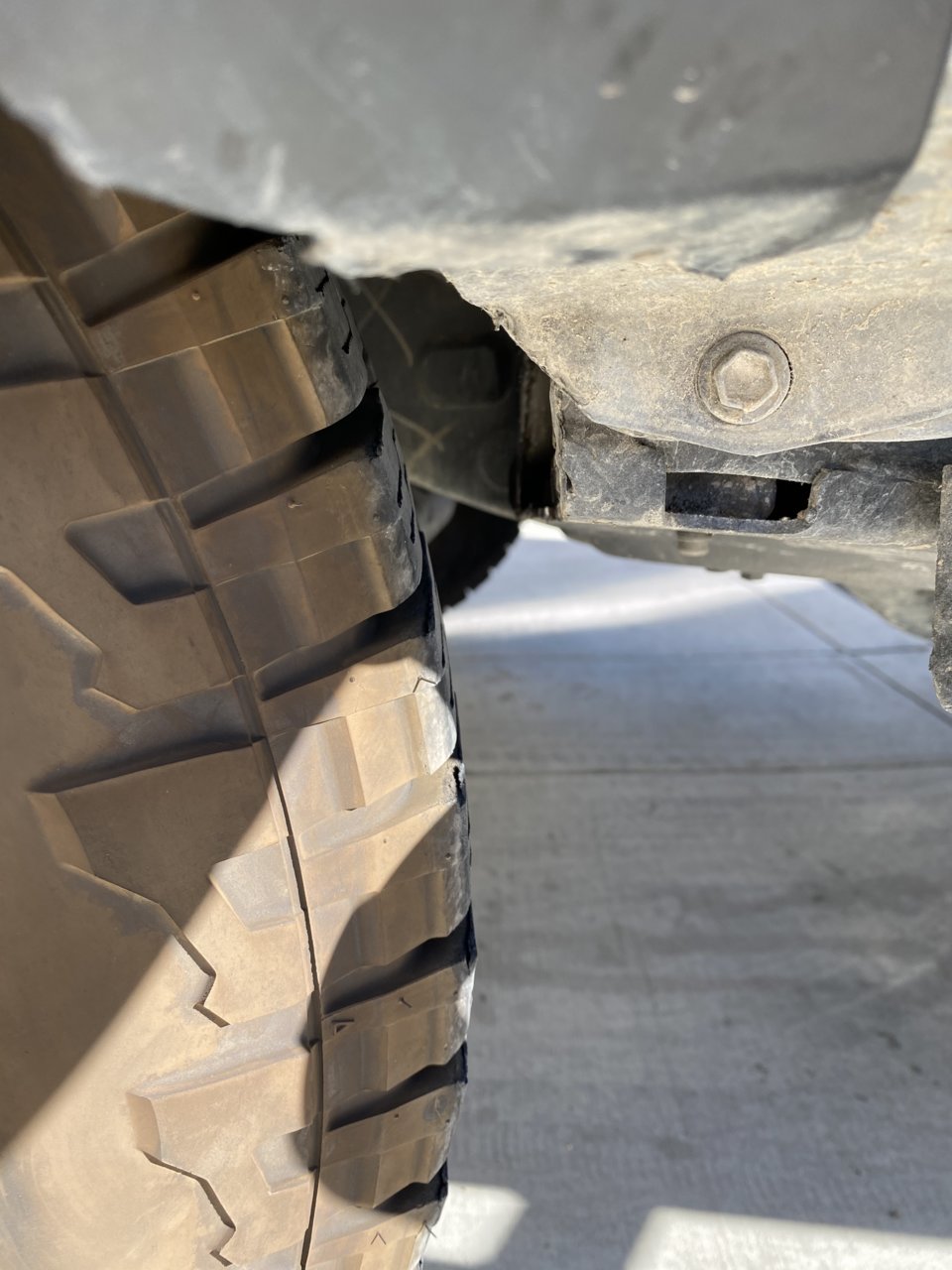

    Wow, I got an alignment and the world has changed. Talked to the tech about the LCA and all the good info here to move the tire forward. Such a big difference. Thank you for the awesome info here

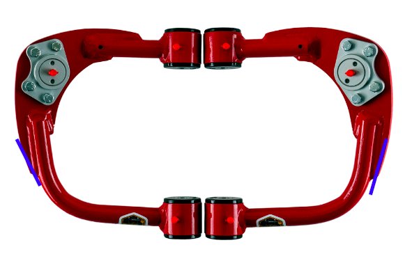

    @JoeCOVA, are you running SPC UCA's? No rubbing on full turn? I know we have similar offsets, I am just barely rubbing on the JBA UCAs at full turn. But I almost think I can grind a bit and get away with it.Screen Shot 2020-07-19 at 12.44.44 PM.jpg

    Correct on both. Running SPC no rubbing on the UCA. Should be pretty easy to take those down a bit.
