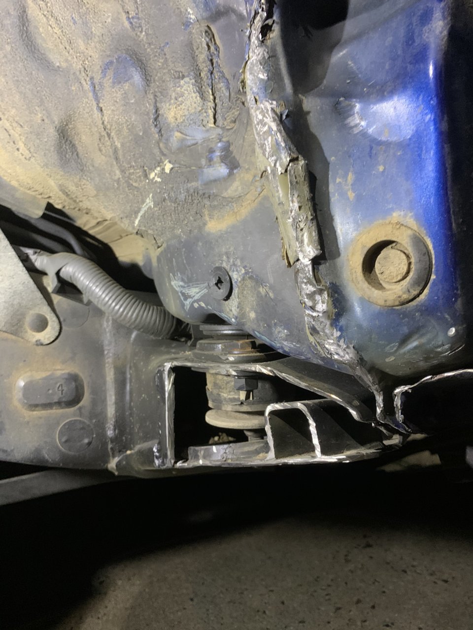

    What I got, my cam bolts are frozen so I gotta fix that and push the wheel forward a bit and I cut the cmc wwwaaayyyyy back

    Also did a lazy job on those pinch welds so I could go to work easier the next day I hammered those in better

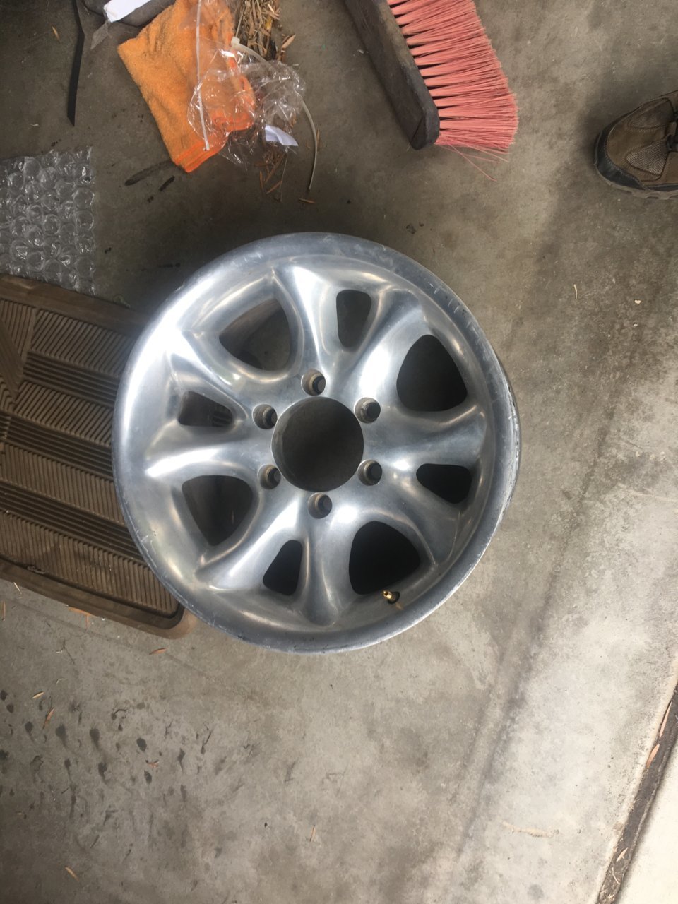

    I’m finished with this mock up rim. If anyone wants it for test fitting tire on your truck hit me up, you pay shipping or pick it up. 16x8 4 inch backspace.

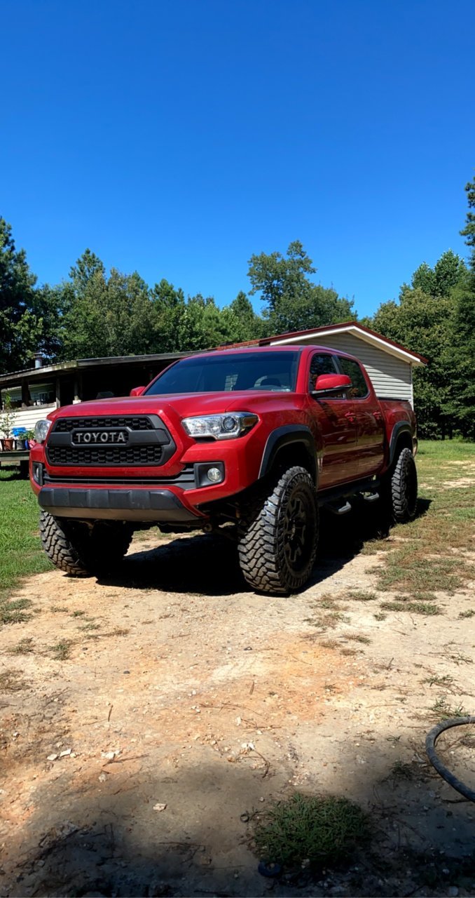

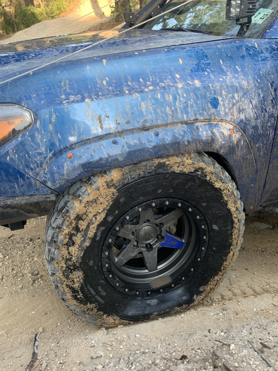

    49D83C59-ACDF-43B0-AD16-3239E07E284F.jpg Just finished stuffing 35s on mines

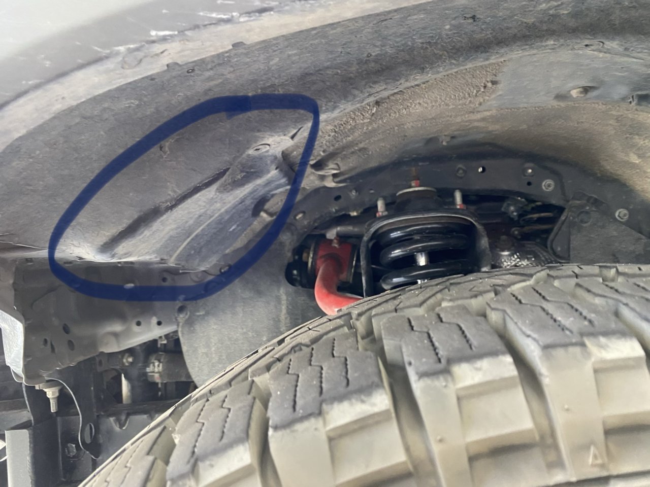

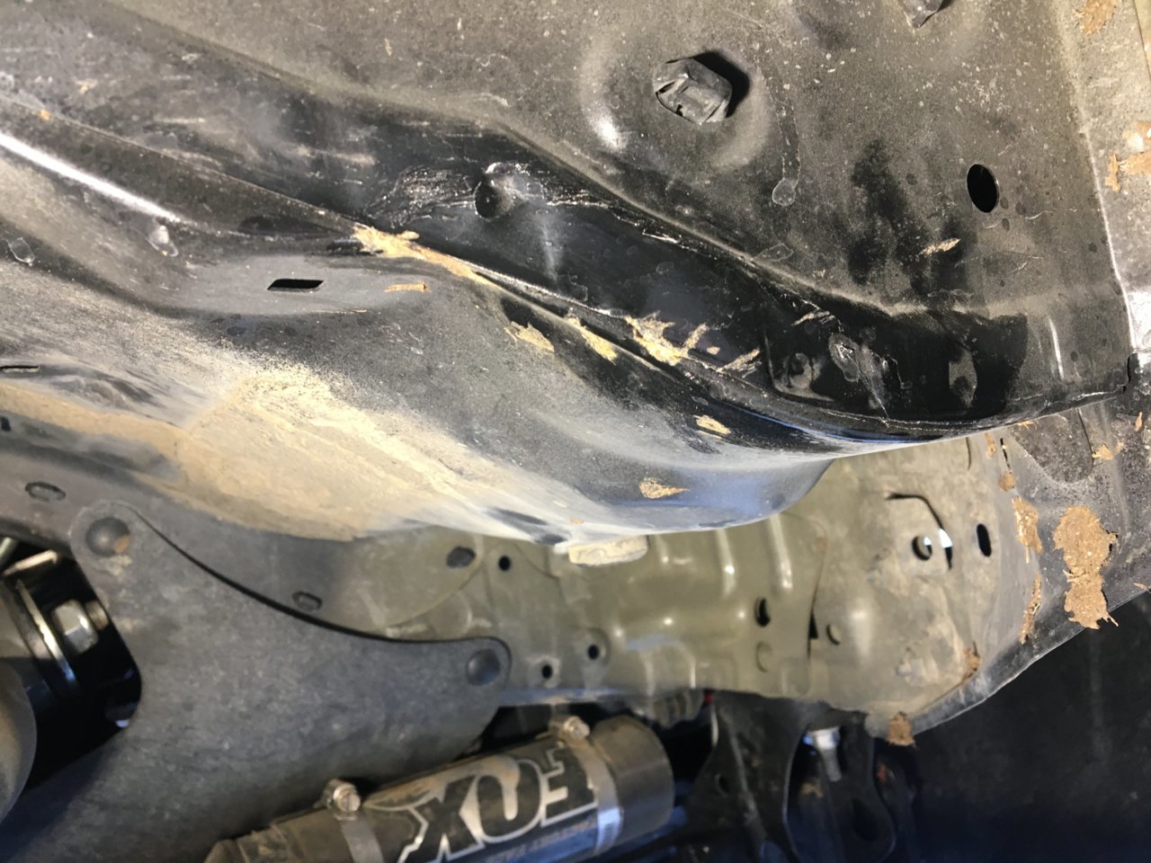

    Put 3/8 bump spacers on but still hitting fender liner underneath on both sides. What’d you all do? Hammer metal above the liner?

    You're going to hit that no matter what you do if you drive aggressively offroad without gimping travel worse than you already have. I've got mine partially tubbed and still rub a little under the windshield fluid reservoir area.

    Gotcha, just wanted to see what was already tried. :thumbsup: I’ll just leave it.

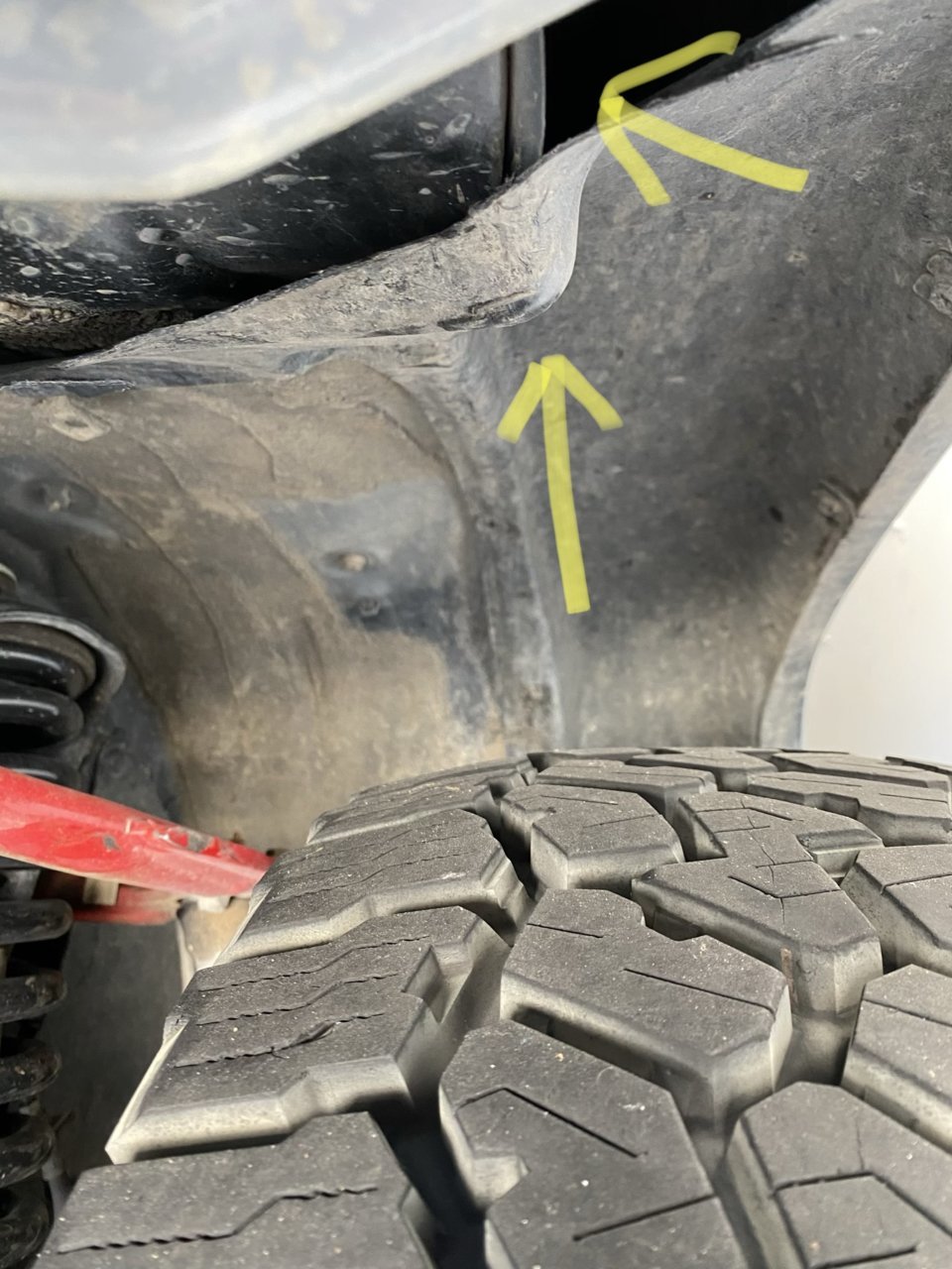

    I have wheelers super bumps and 16x8 with 3.75 backspace rims and I don’t hit there. I grinded the lip off of the steel fender there and pulled the plastic liner.

    Any pics of the metal you shaved down? Is there a weld there or anything I’d want to avoid.

    I grinded down the lip that was in between the two spot welds. This is the passenger side.

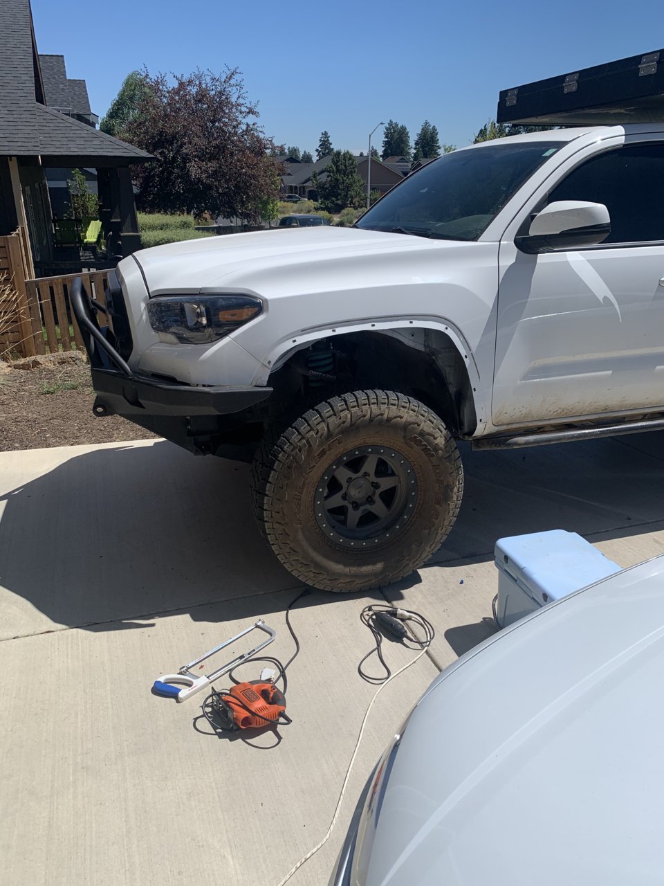

    Fenders are done. Now I just need to tackle the flares
