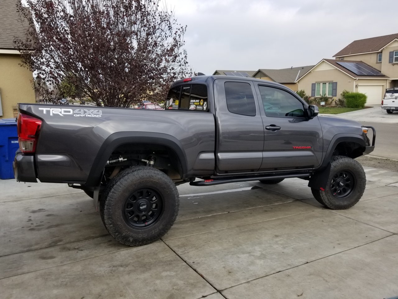

    OvTuned 4.88 R&P Hypertech speedometer calibrator Rough country 6" lift Toyo open country 285/75R17(old) Cooper STT Pro 315/70r17 Archive garage shackle flip Tough country uni ball uppers Icon 2.5 6" front coil overs Icon 2.5 CDC 6" rear shocks OME cs047r rear leaf packs AllPro HD Sliders Tom woods double cardin single piece drive shaft Magnaflow exhaust Black rock D window rims(old) ICON 17x8.5 Rebound CBI T3 full guard front bumper Smittybilt x20 10k winch HEISS 20" single row light bar ARB on board air compressor
    So would more back space just change where you rub? I'm looking at getting some icon wheels with some 35 cooper stt pros. After reading these post though I'm second guessing it. They run 5" of back space on the rebounds and 4.75 on the compressions. Anyone have any experience with this?
    Side note, I'm currently running a rough country 6" lift lift with some tuff country uca, tires ate currently 34x11.5 with no rubbing and no cutting.

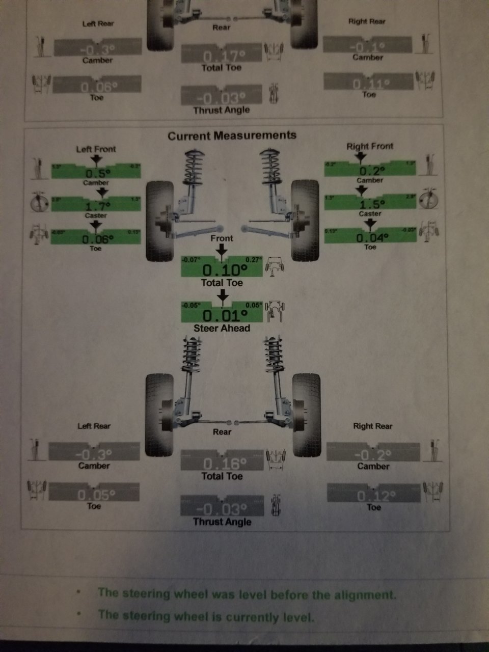

    Current alignment:

    Ok maybe I’m chasing numbers but with the uppers set at ‘E’ and the lowers maxed out all i can get is a little over 2° on drivers side?? Does this make any sense? Explain it as if you were speaking to a 5yr old so i can understand lol

    That's about right which in reality will be about +4 since the SPC uppers add 2*.

    It is my understanding that the machines can't calculate it because the +2 added by the uppers doesn't register in the system.
