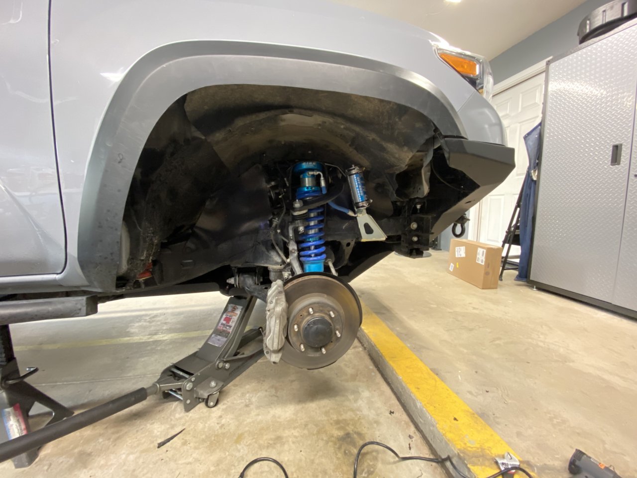

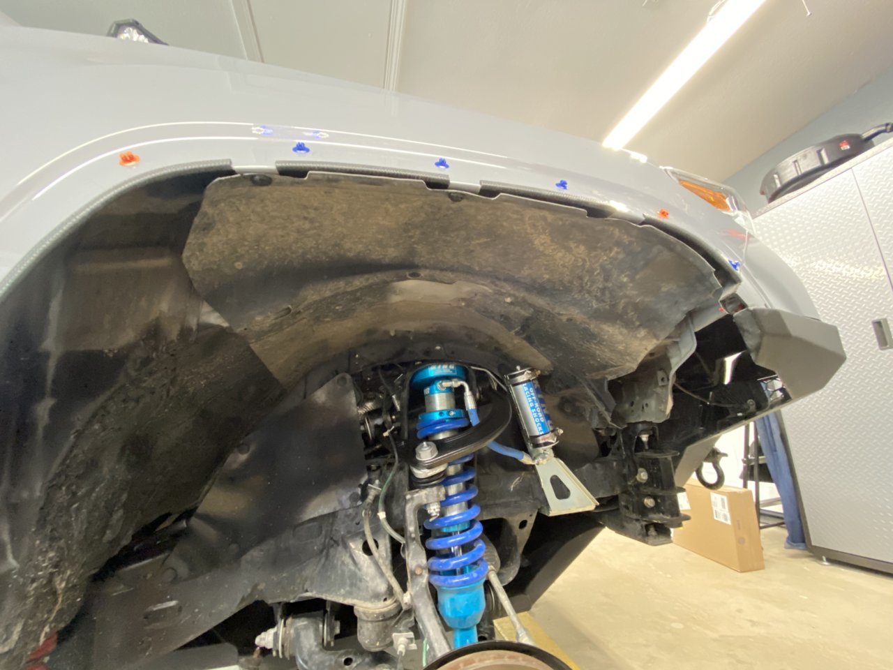

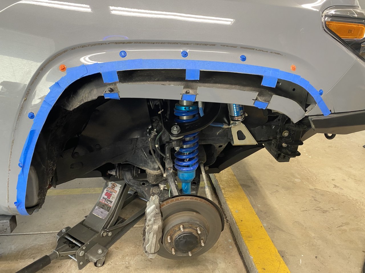

    39E3624A-8F01-404B-BE5A-55971516F7E2.jpg 1F68FA64-CF2D-491A-8A15-3AA1D2296EEB.jpg 6A431FA4-3830-4055-B123-1CC8BEAFDB9E.jpg Idea i had for keeping the fender well liner since the intake inlet is up there. Havent gone full stuff on the 35’s yet so im hoping i cut enough, only time will tell when i get out there with it in the near future. Most likely more kinks to work out but i like the way it came out.. for now.

    Looks factory. Lol

    Someone else said the same thing lol. Hoping i dont have to cut more of the fender flare... will probably end up cutting more lol.

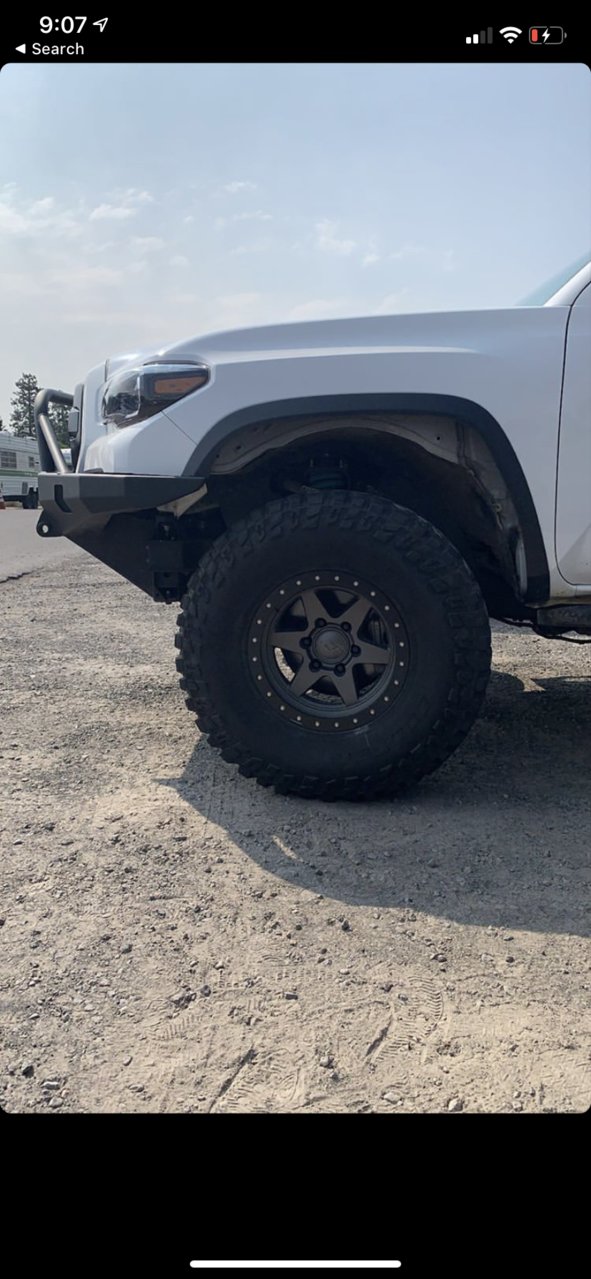

    Bend, Or
    This is how much I had to cut to clear. I’m running spacers though so that doesn't help
    rlx02 and Rockefelluh like this.

    Yeah i had to toss spacers back on because of wheel rub on the control arms. Mentally prepared to cut more off lol. Expecting to go that far with it

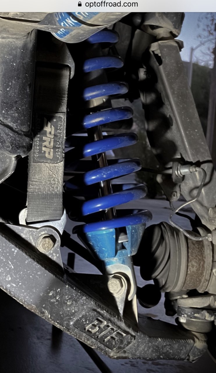

    Quick question, what are the cv angles looking like and are they holding up?
    I noticed this full droop pic from a link in one of the posts a few pages back, to me it looks pretty severe.

    That’s when the truck is in the air. The cv angle people are talking about is when the truck is sitting normally. Most people agree 2.5” is as high as you want to go before the fins touch and likely will get cv boot wear prematurely.
    good rule of thumb is that the fins shouldn’t touch when the truck is parked.

    outer fins touching is fine. its the inners that shouldn't
