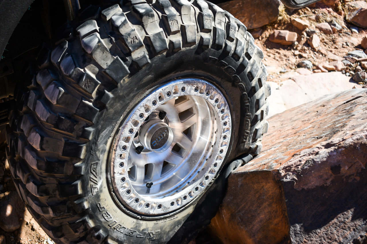

    These Geolandar MT’s r nice.
    35x12.50R17’s

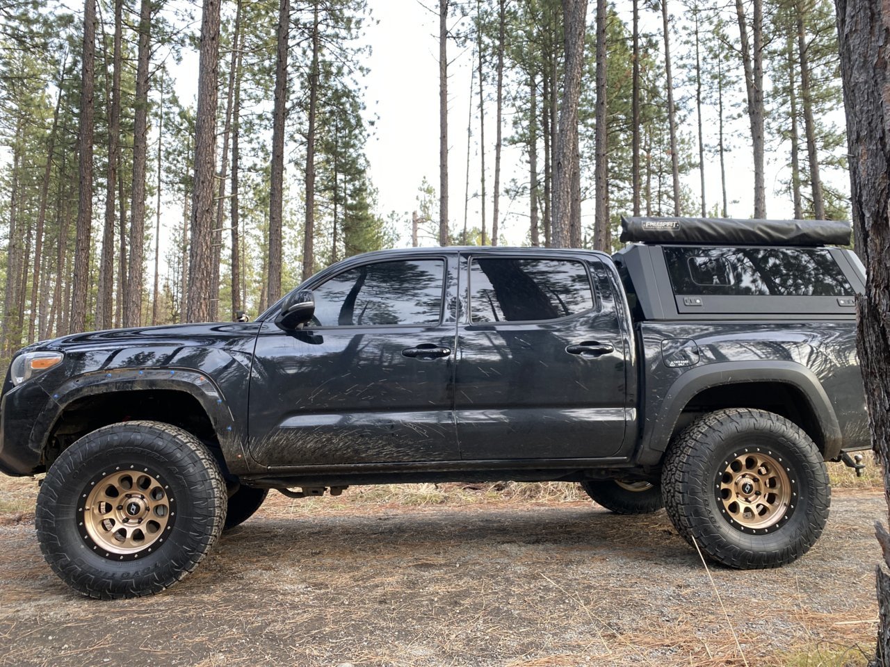

    7C1843ED-4BB9-48C0-A7E8-98EAE5BC33CD.jpg Finally joined the club.
    35x12.5r17 toyo at3 on scs brushed copper ray 10s -10 offset 4.3 BS. CMC...pinch weld...yaddayadda...

    That brushed copper on black looks awesome

    Thanks. I was all black before on 16” trd pro wheels and I liked it for a long time. Just needed a change. Also those ray 10s in black went crazy fast! :rofl:

    Your truck is looking nice man! What kind of bed rack or camper top is that? It looks really sick

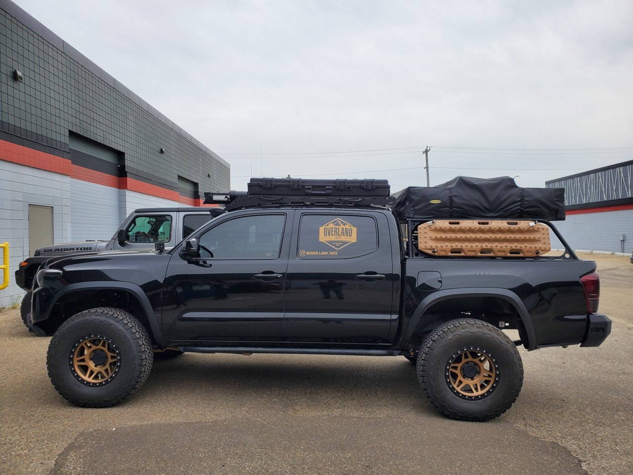

    2" lift running 315 70r17 ko2s and jba UCAs.

    Looks like you're running spacers?

    Yes I am, they are 1". Ideally I didn't want to have to go that route but I was given the tires for free and the only way to clear my UCAs was with a spacer or pay a few thousand again for new wheels with a negative offset.
    I'm sitting around 25k km now with them with some hard miles and they are holding up well.

    Yeah I have -12 offset and rub on full lock on my JBAs.
