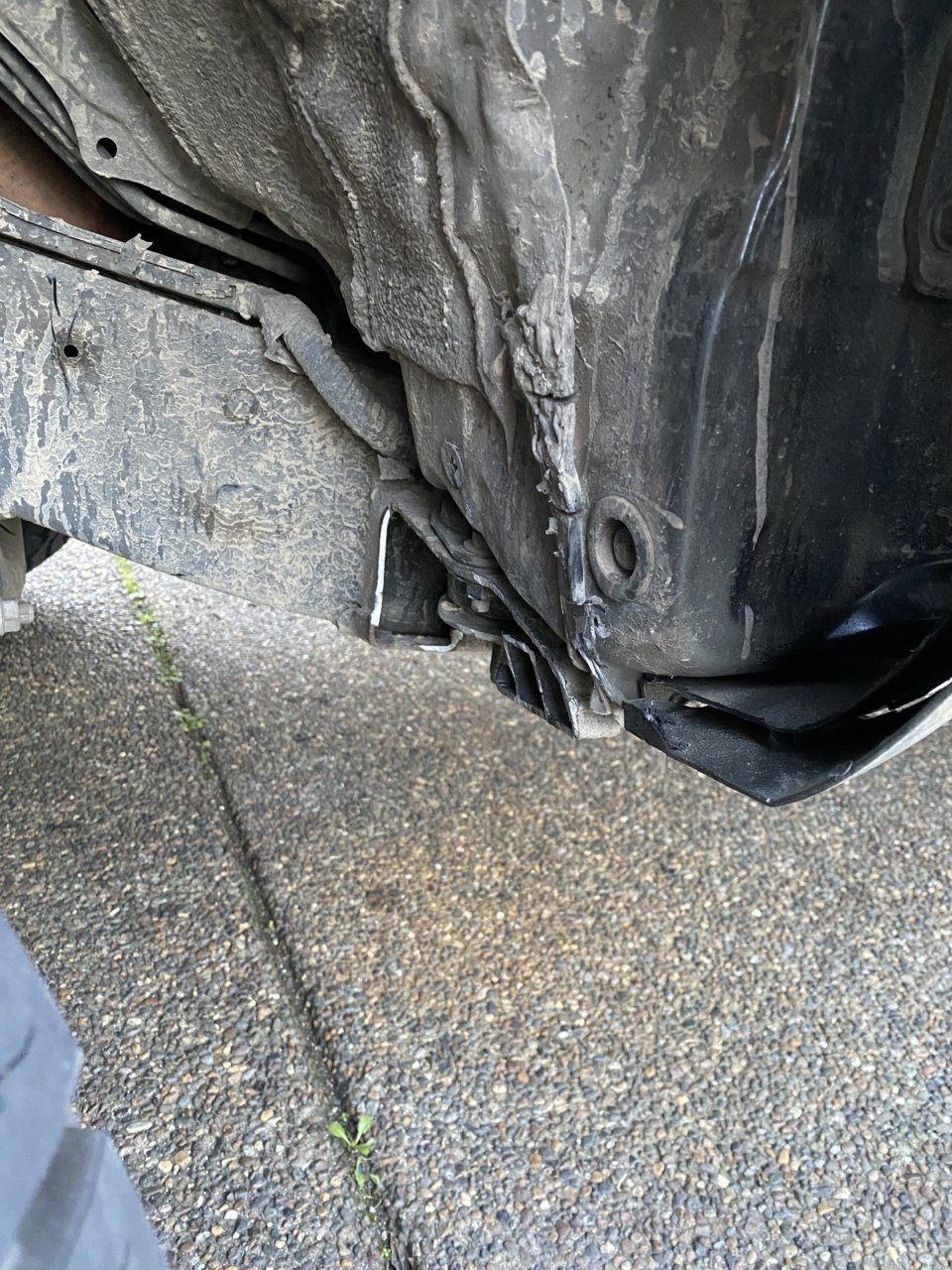

    25% done with my fender trimming. Also added a dorkel because I was done F’ing with the wheel well liners. 4911F706-D2B2-42AD-8F88-2F4C3018CFBF.jpg

    7CE90BA0-3D98-4BBD-BF3E-383AABD0691F.jpg BCE206B7-DC0B-4B55-BFD8-A4A841F455D8.jpg Round 3 at the CMC. If you’re wondering it still rubs :rofl:

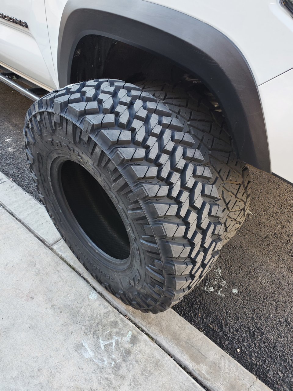

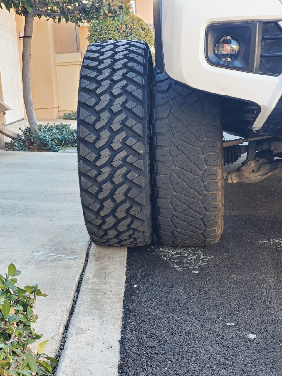

    20210125_155127.jpg 20210125_155127.jpg 20210125_155155.jpg 20210125_155204.jpg so I added gusseted spindles, smashed the pinch weld and will be doing CMR on Friday. I did a test fit today with the spare and I roughly cleared the uca by 1 inch, but it seems I'm definitely going to rub my rr. Specs are 17x7 with +4 offset and 4.5 bs. I have some 1 in bora spacers coming in. 2 questions, any way to clear the rr without the spacer and 2 if I run the spacer can I assume I have to cut my fender?

    tires are 35x11.5x17 btw

    7" wide with +4mm offset is 4.16"bs, just FYI.
    And I would just relocate the rr rather than use spacers.

    yes, I get that with the bs, but what am I missing here? And is there a way to relocate the rr, it doesn't have much wiggle room to move.Screenshot_20210125-185522_Google.jpg
