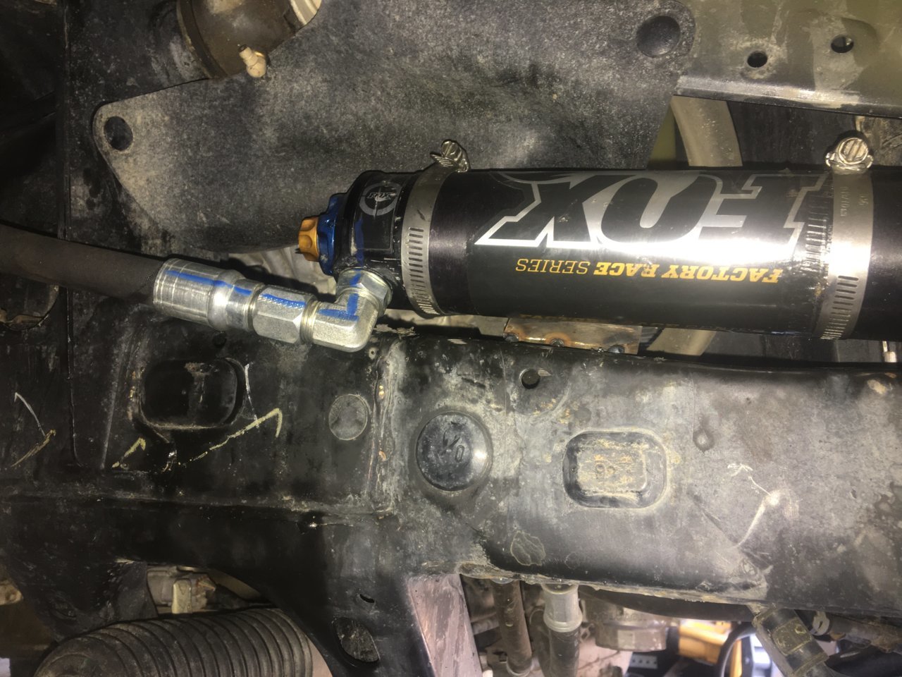

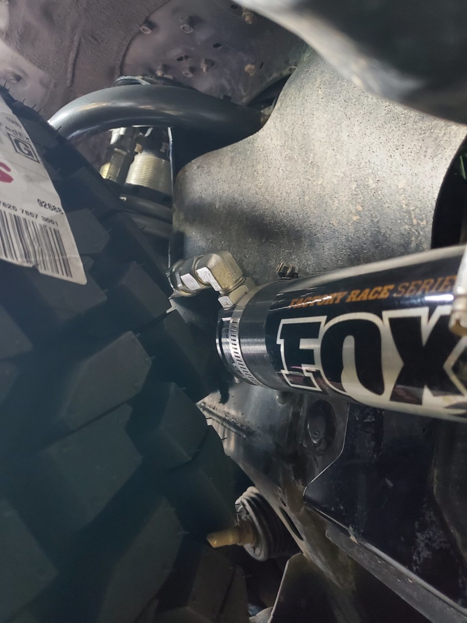

    Try to not run a spacer. With that backspacing you’ll likely hit the fenders. Anyway you can use the king mounts?

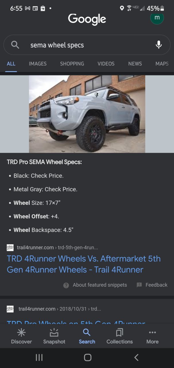

    The website you're citing is just wrong, Google a calculator and plug in the dimensions yourself. You'll find it isn't 4.5"

    yea I'd rather not use them spacer, I got a set for last ditch effort. And I'm not sure if King mounts will work. I can looking into it but I have a feeling it won't. The hose on my fox are pretty set on how much they will move 20210110_153924.jpg

    got it, But I always thought OEM Sema wheels had a 4.5 bs. Guess I should have paid more attention to that.

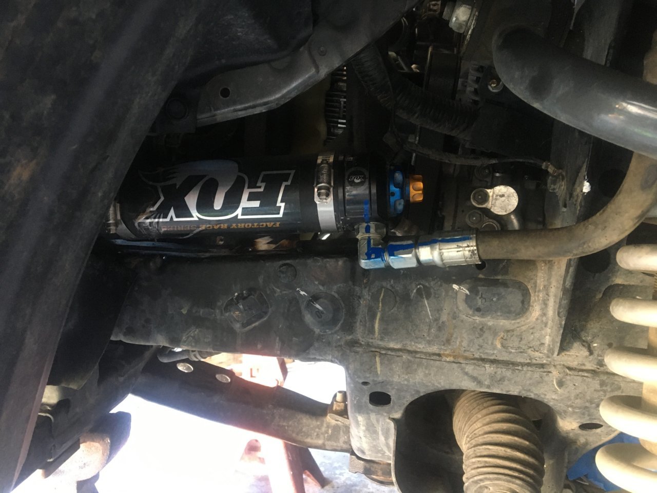

    Mount the resi’s on top of the frame. Cut the bracket and weld it to top of frame, lots more tire clearance. On drivers side Rotate the clamp on the lower radiator hose 90 degrees to keep res. from hitting radiator. Leave minimum 3/4 inch clearance.

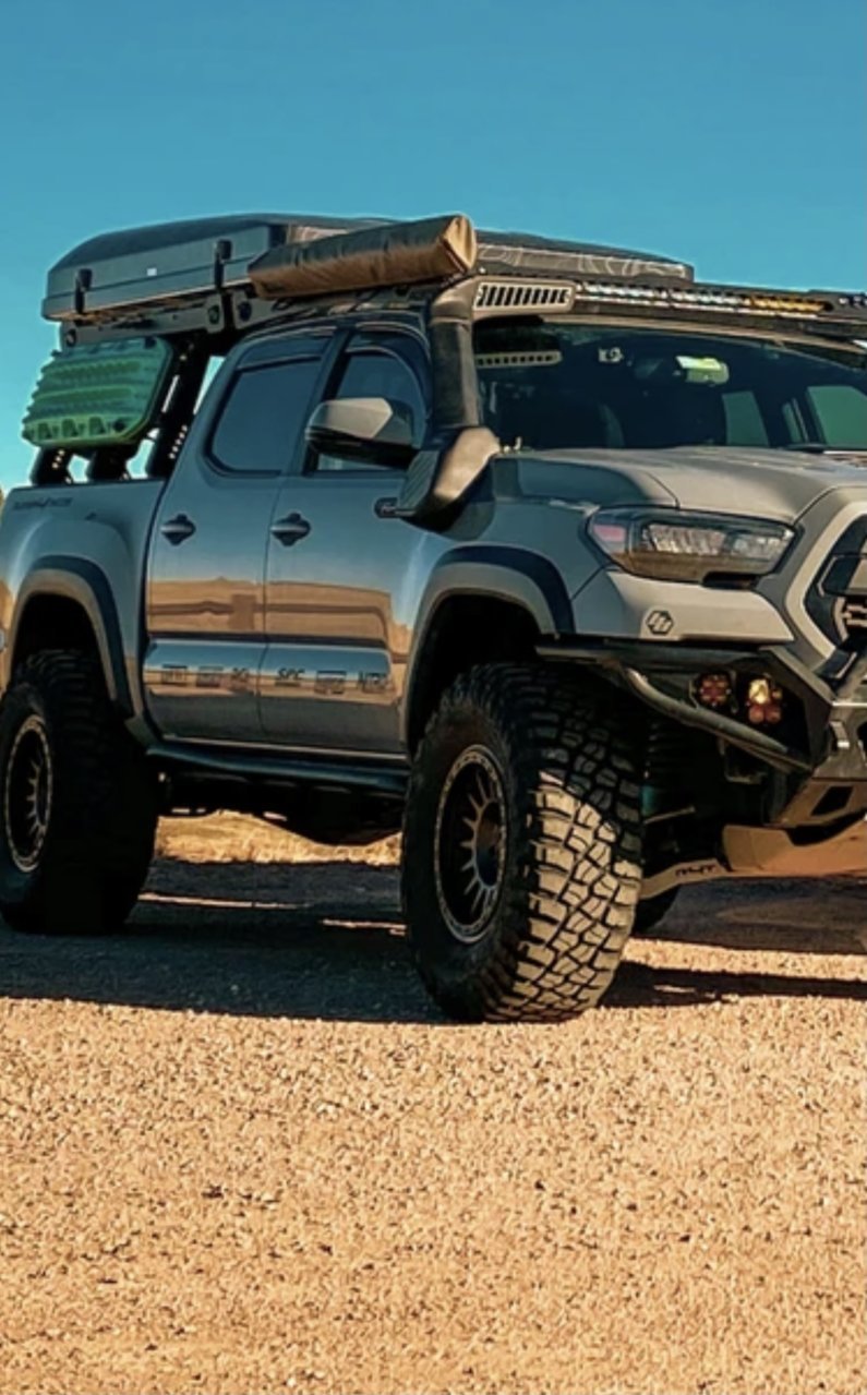

    Looool dorkel. I am going to add one too when uptop releases theirs I'm so over those plastic wheel well liner POS's.

    Appreciate that, I don't weld but my buddy that's helping with my CMR this Friday should be able to do that.

    I went mega dorkle. I’ll probably redo the end by the roof later, this gets me through king of the hammers and some mud snow trips with the family for the next month.

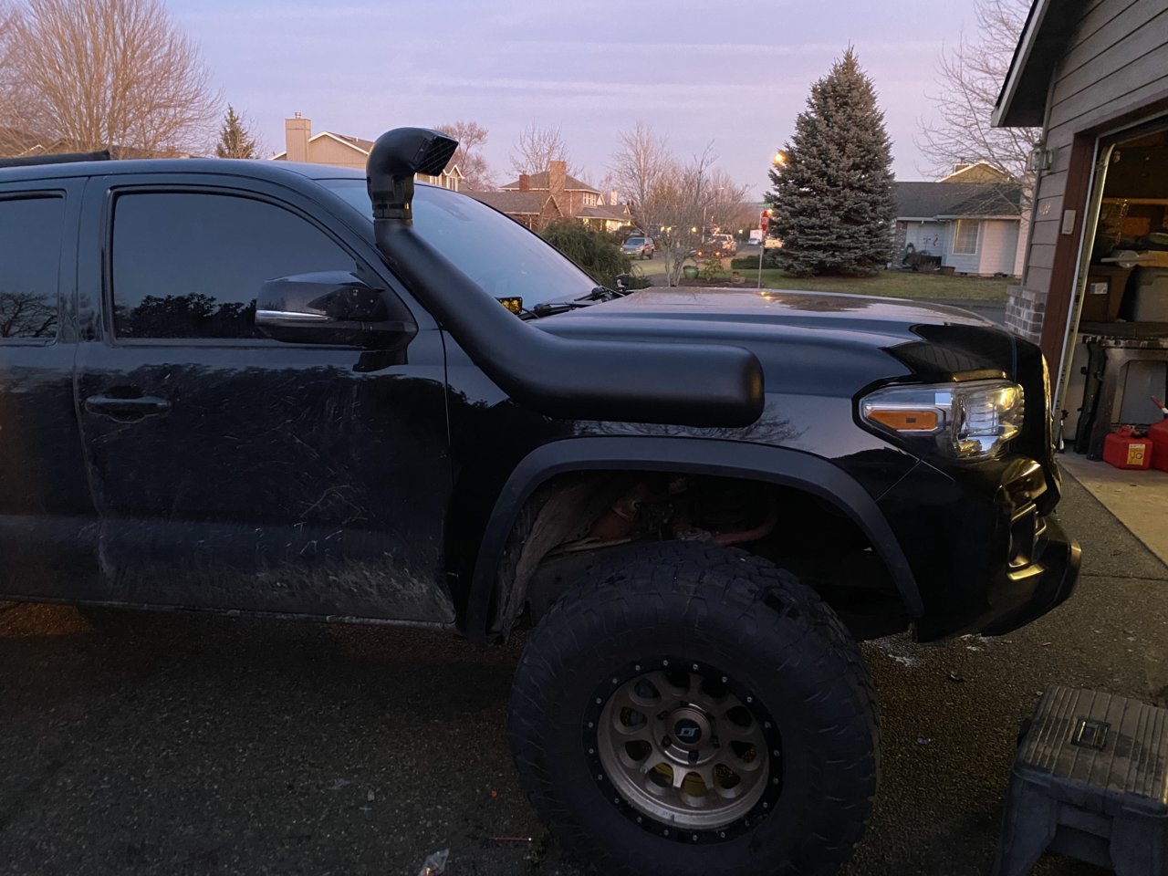

    Uptop is releasing a snorkel?

    It’s already gonna be extremely hard to get the first batch as a ton of people want them so guess I can let the cat out of the bag more. Yeah they are and it’s the only design I’ve seen where I wouldn’t feel like a total dork(el). Been waiting for a whiiiiile now

    Denver, CO
    2017 TRD OR MGM DCLB
    Lol yes it’s absolutely absurd. But I still want it/don’t want to get a whole bunch of crap in my intake. I got tired of heat molding the liners so I just started chopping, there’s probably less than 50% left lol. I haven't seen lenzdesigns I’ll check them out.

    For that price I'd rather get this stainless one. Plus why does it have that big bulky box on the fender?
