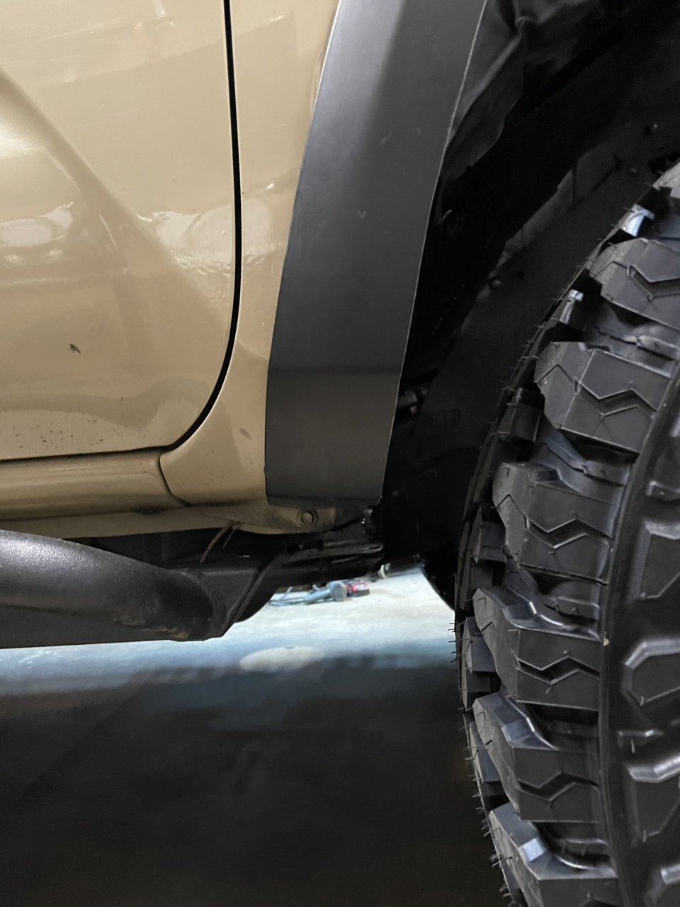

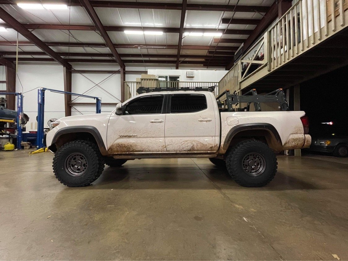

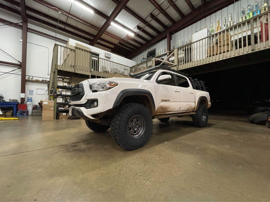

    Just joined the 35s gang!
    16x8 +0 fifteen52 turbomac with 1/4 spacer
    315/75r16 yokohoma geolander
    Cmc,pinchweld
    48180454-A1A6-48F9-A7AD-09E7B5BA1A85.jpg B23407D0-5C3D-47A4-9480-BFB0B1E36CFE.jpg

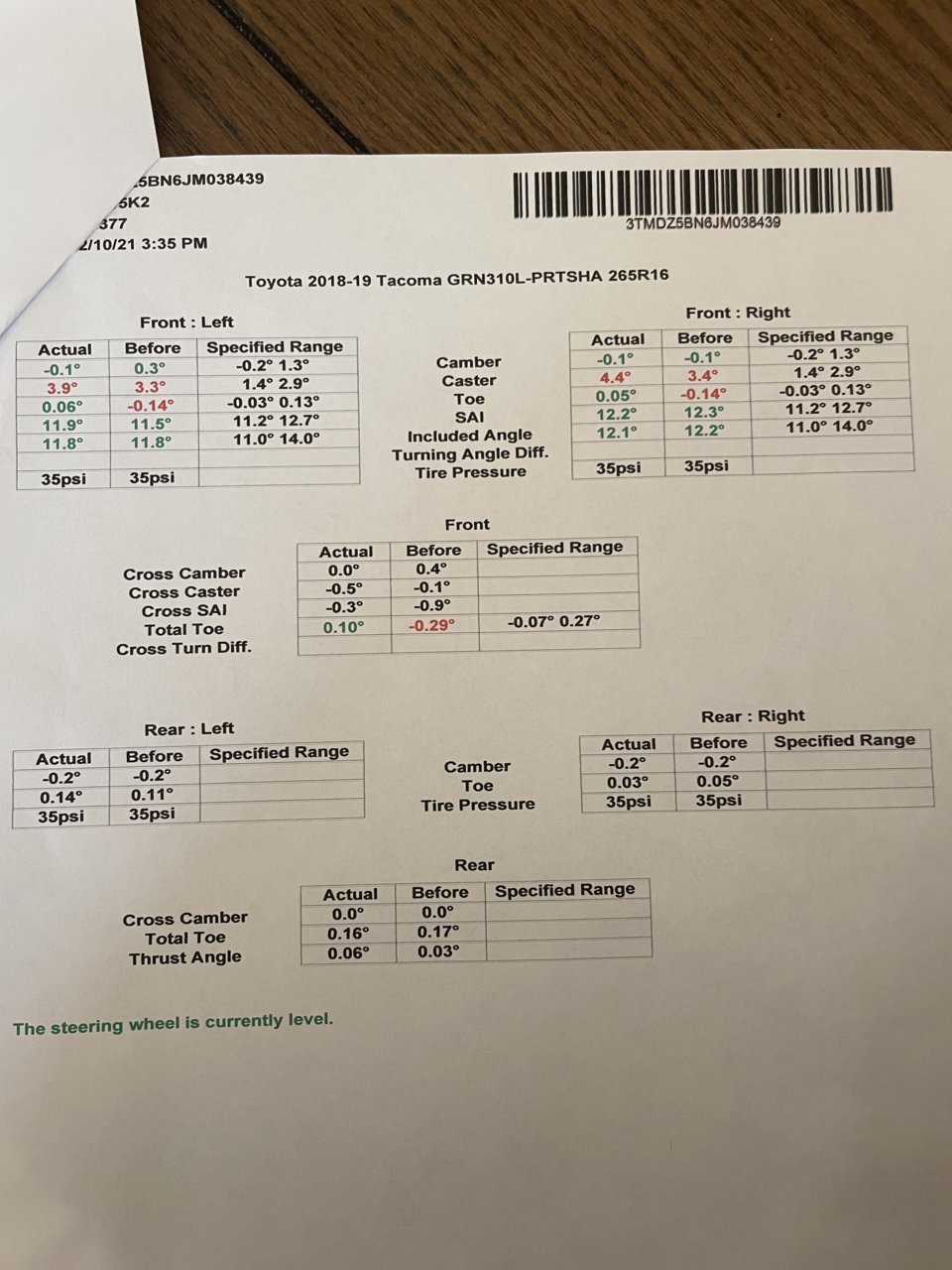

    Ya I was trying to find fj’s for a long time and after some research found out 4Runner spares are pretty much identical but run cheaper and are easy to get.
    As far as alignment I’m not really sure, that stuff is all like a foreign language to me. I just took it to a shop that looked like they worked on wheeling rigs and figured they’d know what I wanted. Here’s the numbers they gave me back

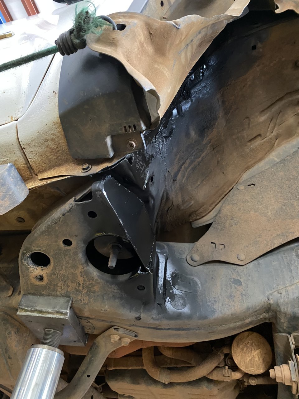

    Got this done last night, it's the one part of fitting 35's I wasn't comfortable with. I'm happy I decided not to do it myself cause it wouldn't of came out so clean lol. 2.5" was cut off for the win!20210307_194341.jpg 20210307_202616.jpg
    We left some tabs so I could have attachment points for when my fend ex liners show up.
