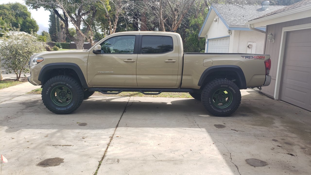

    Got my Kenda’s mounted. No rub lock-to-lock at stock ride height. I’m very happy. Took an aggressive CMC, pinch weld, some hammering and a little cutting on the lower fender, flares and bumper. Installed SPC UCAs and played with the alignment.

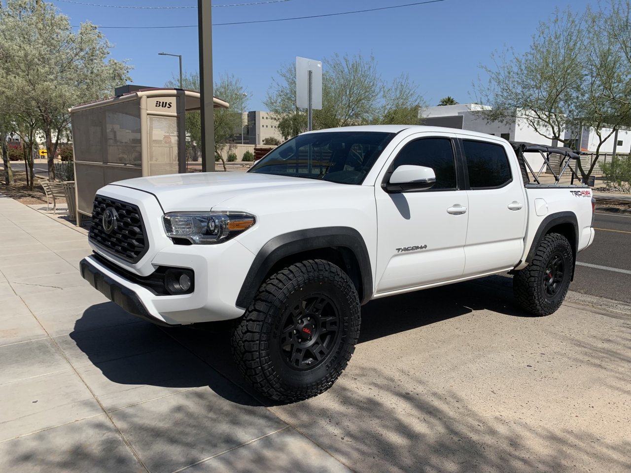

    picked up my 35's on Sunday.

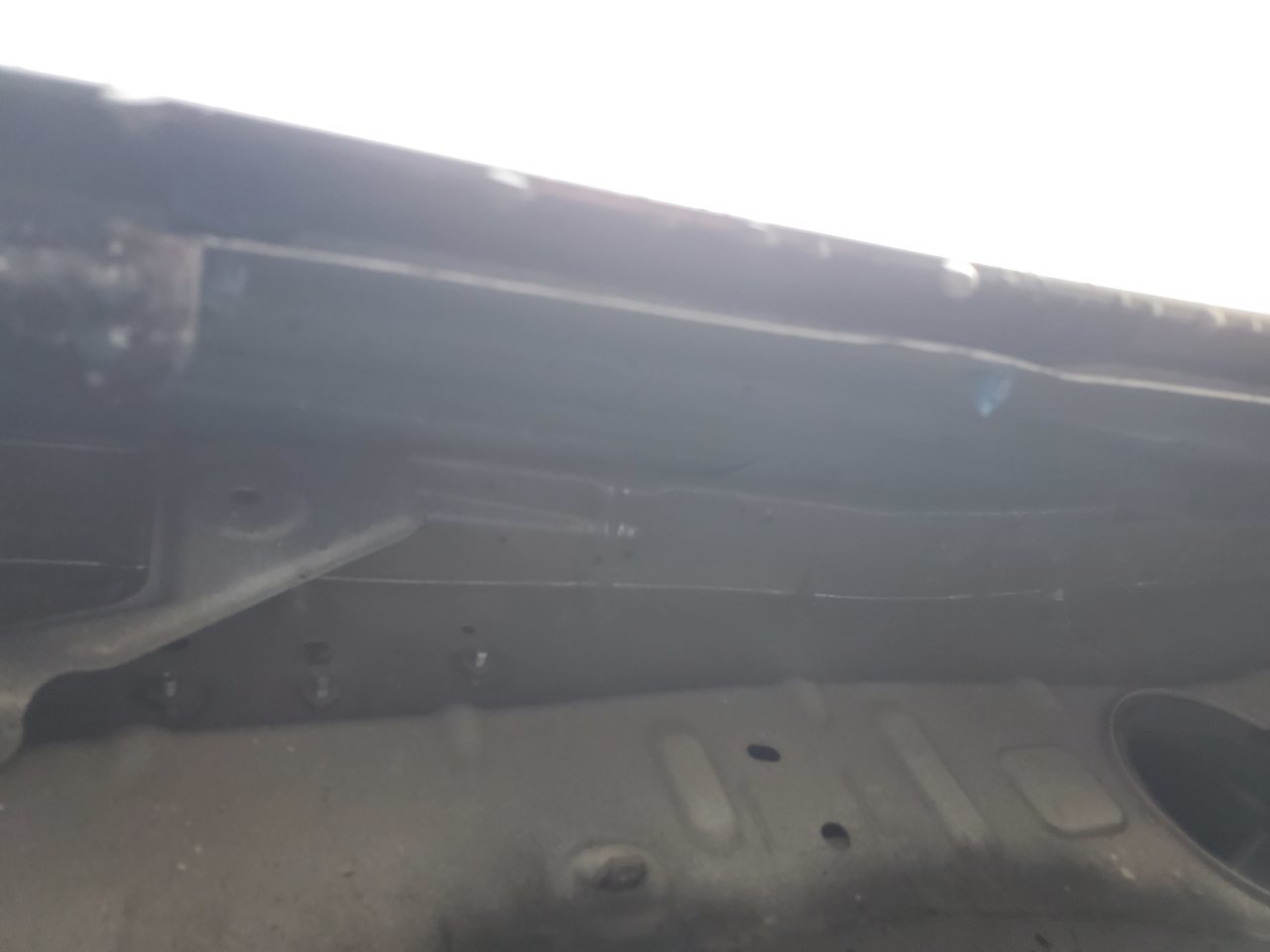

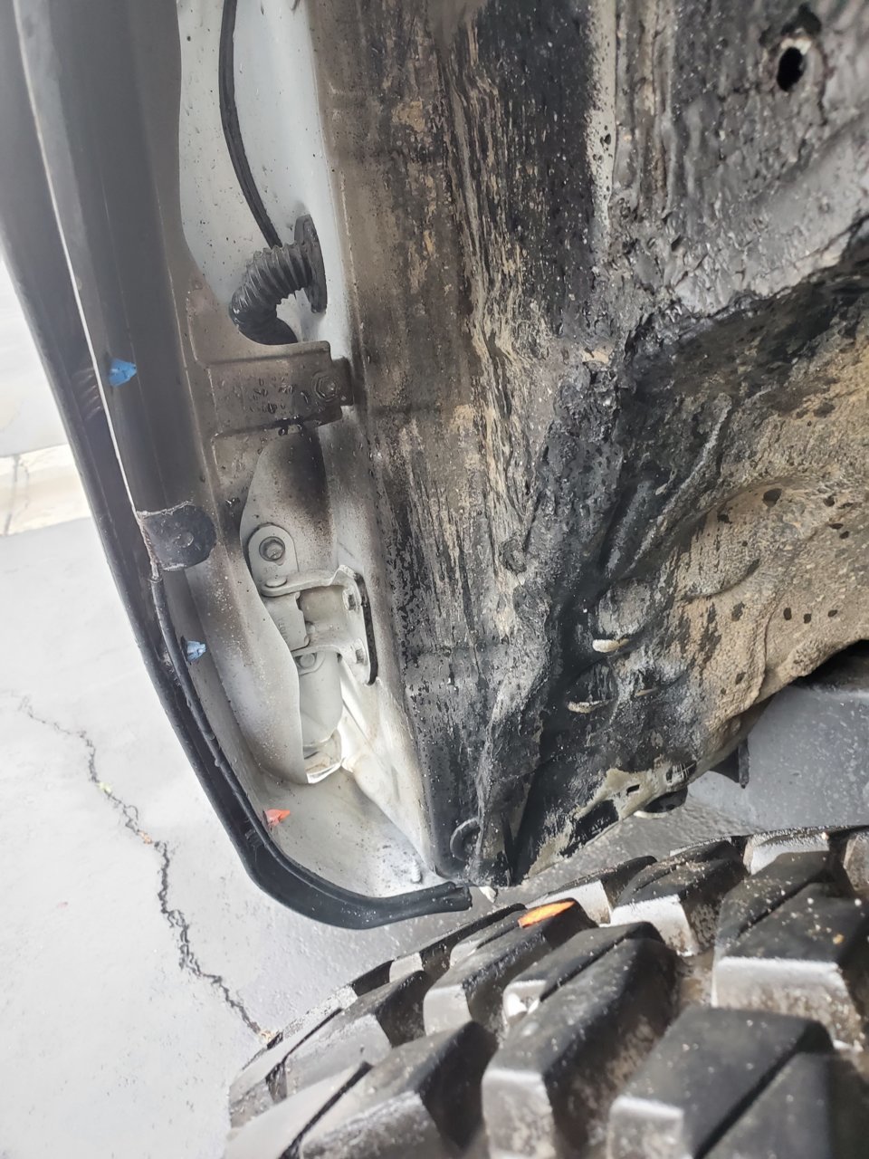

    @Dampahee would you post a few pics of what the fenders look like from the wheel looking up? is there a gap between body panel and flare, and do you guys keep you fender liners installed?

    Yes there is a light gap, and there is no fender liners. I do have fend x liners however that work with trimmed fenders coming at some point.16155965164711692092046551793836.jpg 16155965467058471363104473938088.jpg

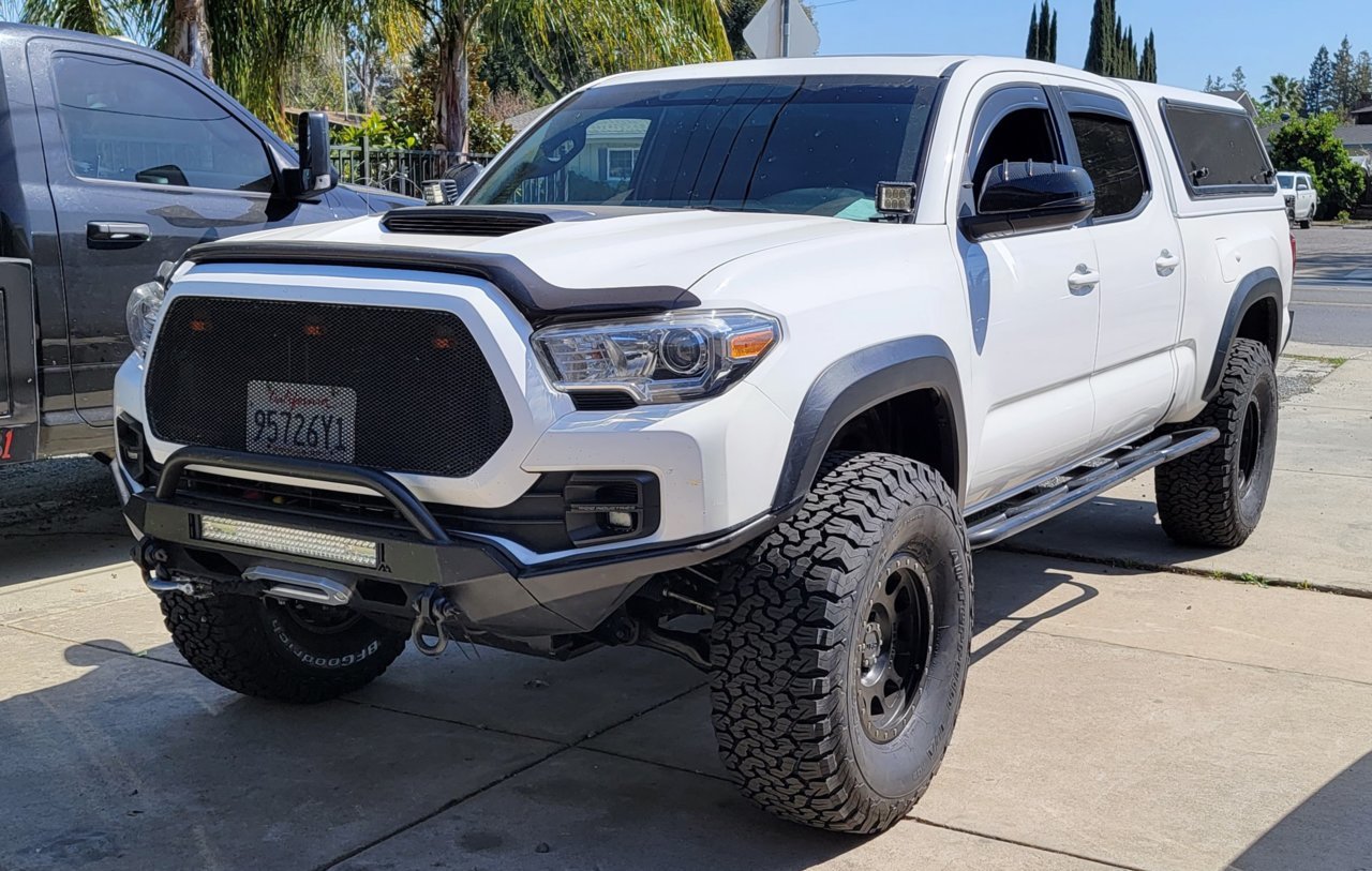

    Finally got the 35x12.5x17 on the 2.5 lift. Cmc done and some trimming on the fenders.

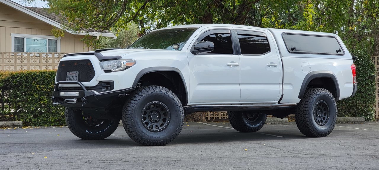

    Finally joined this club. Is anyone running +2 or +3 fiberglass fenders? 20210401_144440.jpg
    Blayze214, bizarrocolin and JDSmith like this.

    Man that looks good! Love the bumper also. SSO?

    Be careful of the front bumper wings to make sure the tire doesn’t hit them. I think it was @Thorian who ripped one off.

    Yeah I was looking at that too. Looks like it's good. I'm going to pull the shocks and cycle the suspension here soon

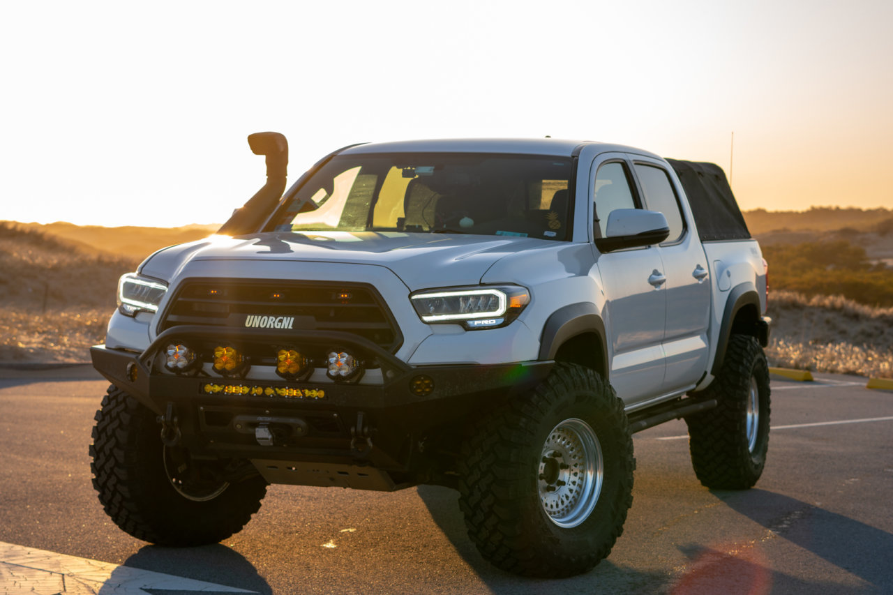

    I've had 35s for some time but just changed up my setup.
    Icon suspension set at 2.5" of lift. 16x8 -33, 315/75/16.
    Not pictured here is a 1.5" fender cut that I recently did and hammering above the cab mount to push it back an extra .25" or so. Cab mount to be relocated soon.
