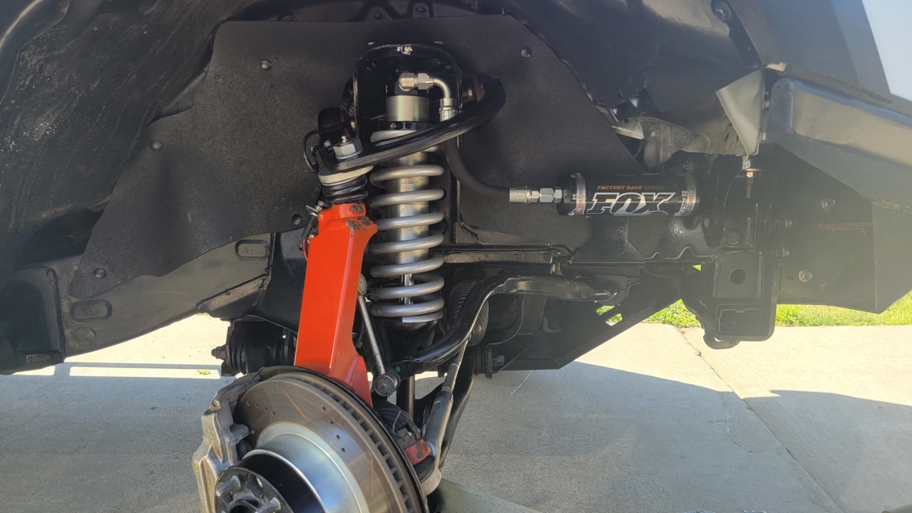

    I have some. They don't interfere with my wheels but is definitely close. 20210306_132342.jpg

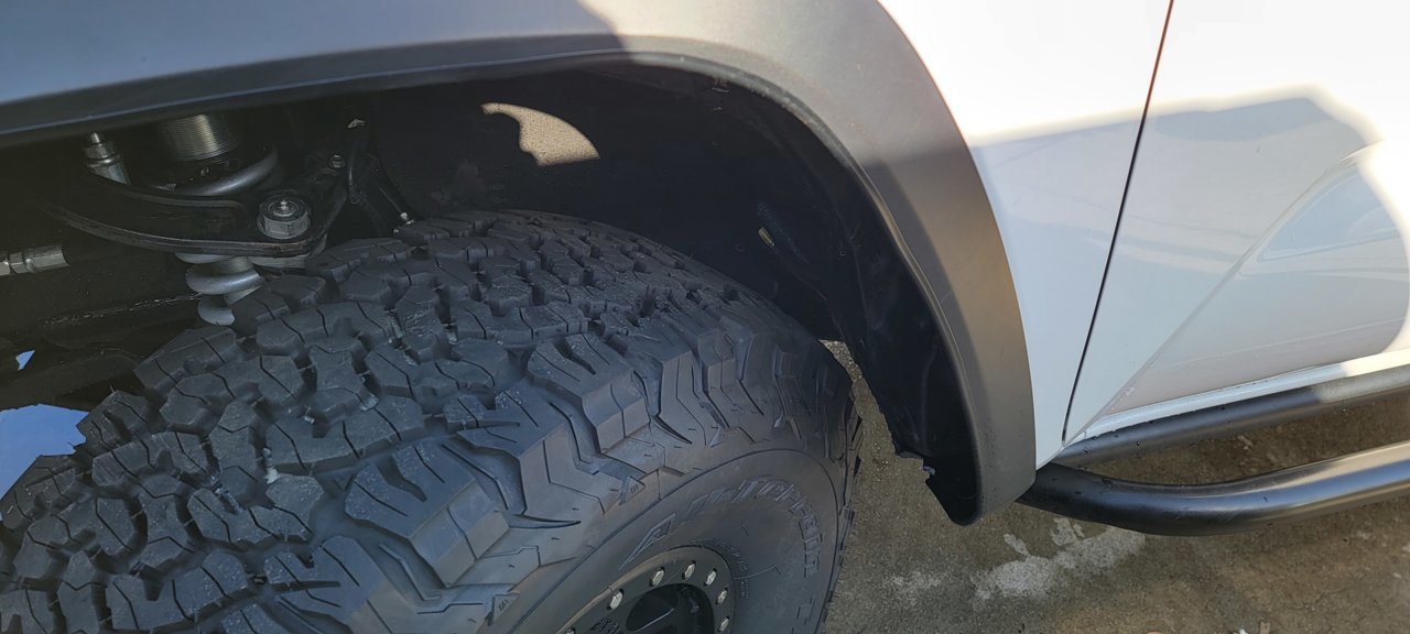

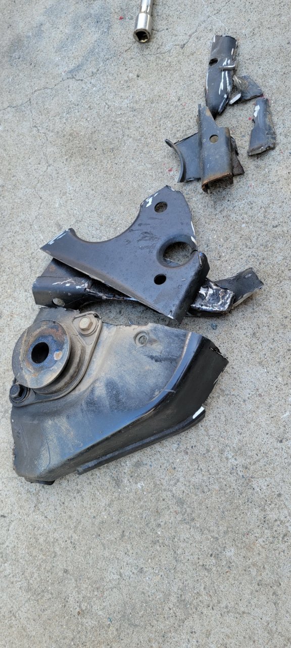

    20210409_164251.jpg4 hours into it. Lol. One side is getting welded now

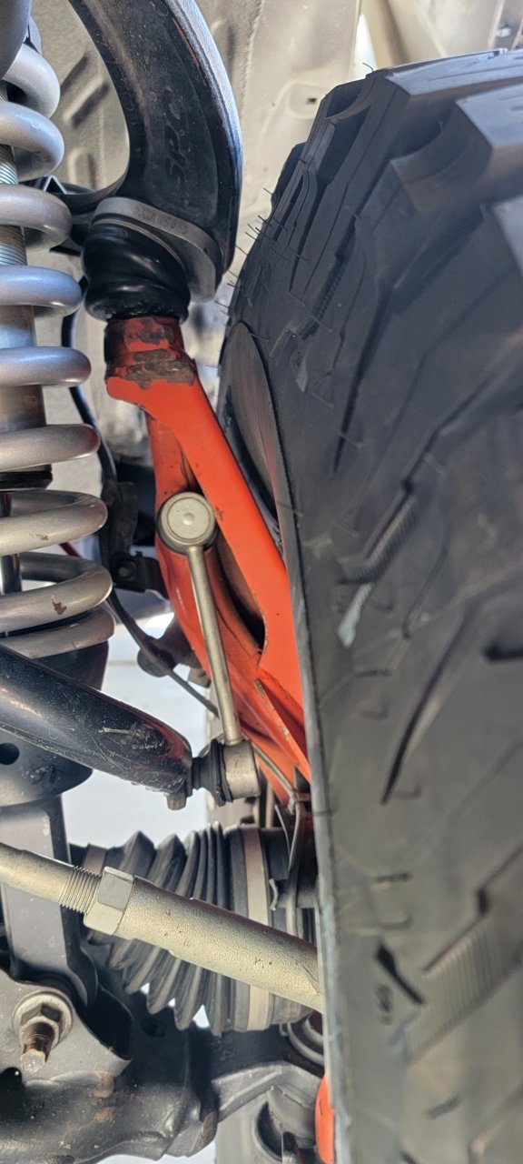

    This is with 1.25 spidertrax spacers. Looks like I can go down to 3/4 and still clear the upper control arm 20210409_170300.jpg 20210409_171826.jpg

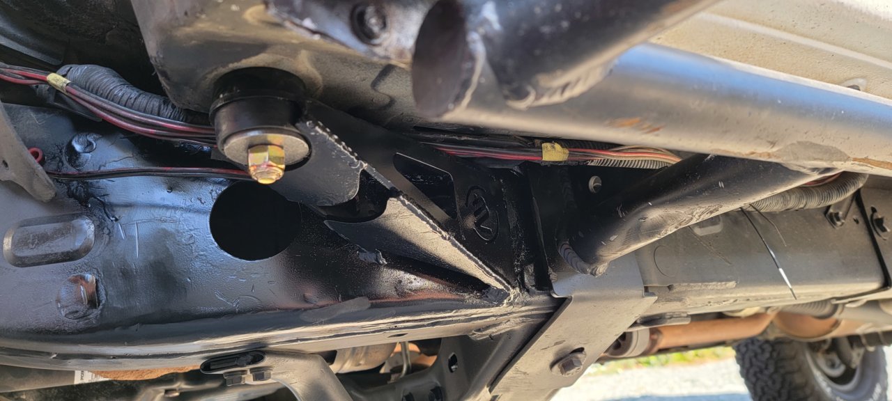

    -OME Nitrocharger lift, Dakar leafs -U bolt flip kit with timbren bumps in rear and durobumps in front -9” bobbed bed -3” cut fenders and cab mount relocation -315/75r16 -LCE long tube headers and Magnaflow muffler -URD maf sensor calibrator -fully skidded with RCI off-road steel plates -dobinson snorkel w/K&N drop in and charcoal delete -Demello off-road steel flat top front bumper w/smittybilt 9.5k winch
    Here’s what I opted to instead of doing a relocation. I haven’t mounted 35s yet but I just found a set of beadlocks for 400 bucks that I’m gonna mount 35s on. We will see what needs to get the hammer when the time comes.:sawzall:

    I'd be interested to see what kinda clearance you end up with.
    I’ve already ditched my fender liners when I got my snorkel and cut the fenders. I’ve got hella room with my 285s right now. A close friend gave me a relocation kit that he didn’t use so if I need it I’ve got it to fall back on.
