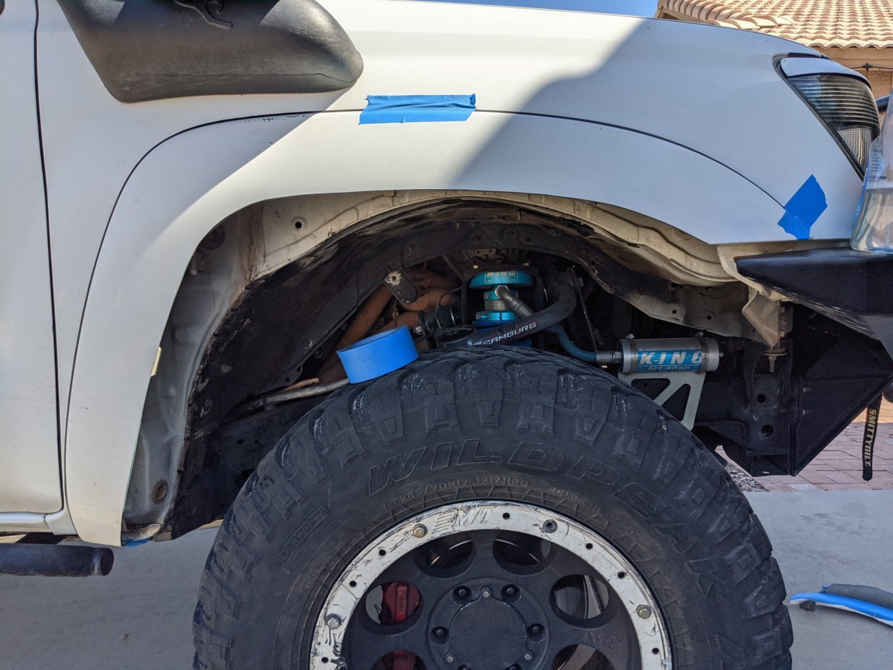

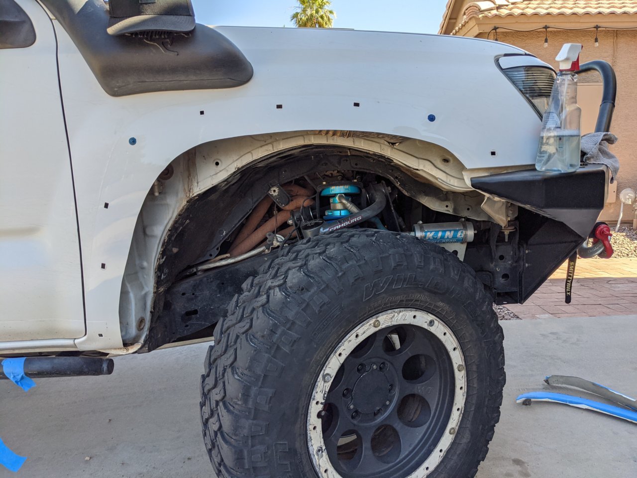

    Got the fronts trimmed up. Took 2.5" out of the sheet metal, and 2" from the flare. Adding some edge trim to the flares when it comes in. Going to do the rears and then undercoat the front fender wells tomorrow.

    Pro tip. Use an expo dry erase marker instead of a sharpie in case you mess up.

    It was all taped off. But.. rubbing alcohol also will take off Sharpie.

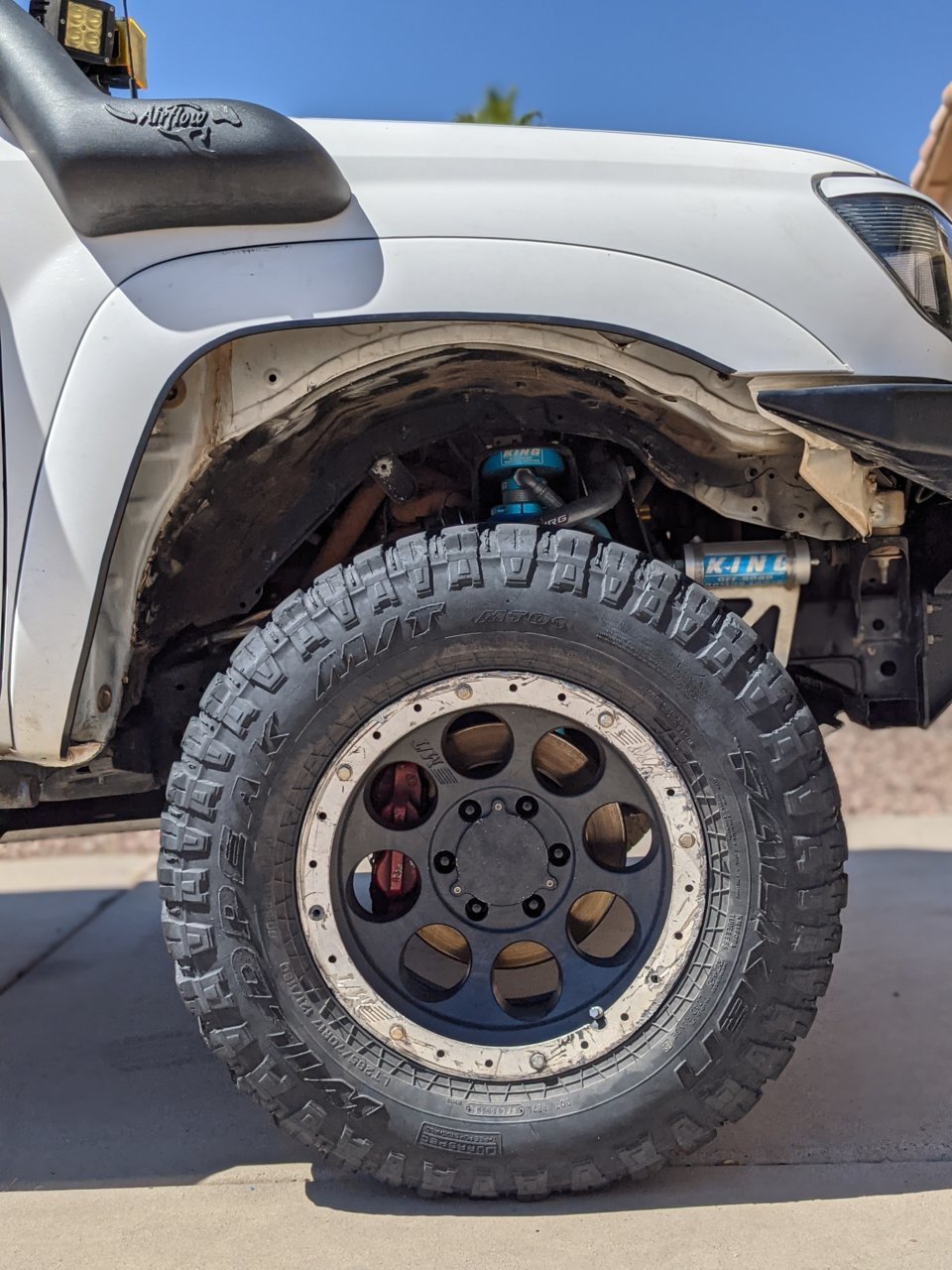

    Done done.

    What did use for the trim?

    Mixture of stuff. 30 tooth metal blade with my jigsaw for the main cuts in the sheet metal and plastic flares. Then I smoothed out the sheet metal with the angle grinder real quick. Did the final detail work with the Dremel on both metal and plastic fenders. Then I sanded the plastic flares to get a smooth line and flow before doing the edge trim.

    I meant the black edge trim :rofl:

    Before and after undercoating.
