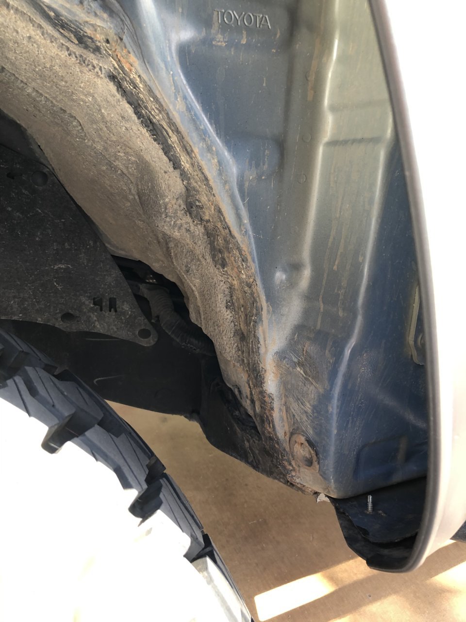

    Sorry to ask you a couple questions in a row but you said will clear uca frame and cab mount. My cab mount clearance looks to be the same as yours, but it appears you have trimmed your fenders and removed the liners. I am curious what areas of the fenders were an issue and prompted you to trim them. Since op has the same back spacing and didn’t find it necessary I was curious. TIA!

    When you hit full bump with wider 35s, you’ll make contact with the flare. You can get away with it if you trim the inside, but you’ll want to space your bumpstop up
    You can run 10.5” wide 35s and not rub without fender cuts

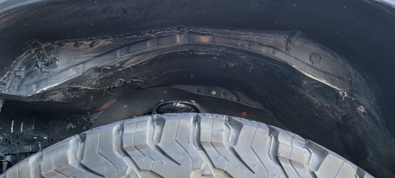

    Didn’t mean to spark a debate here but y’all’s twos difference of opinion is partially what sparked my questioning. I’ll cut liner down a lot and have already, already cut the cab mount. Just don’t really want to cut fenders/bedsides, deal with making my own liners.

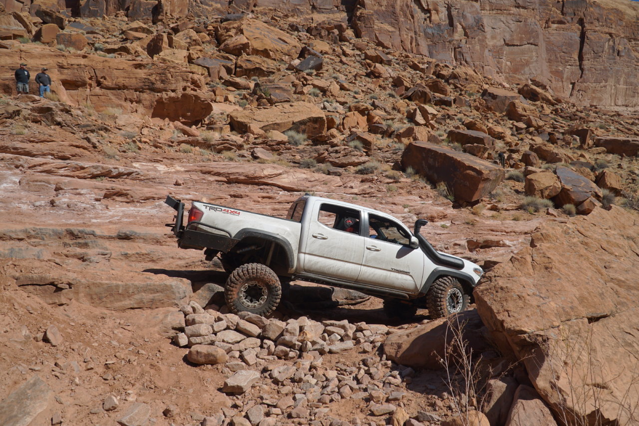

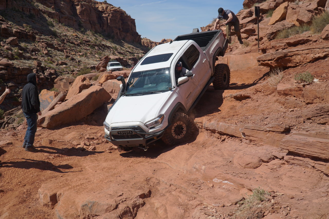

    Here's a couple photos if it helps. You choose. You only have so much up travel. I've never once hit my fender flare or the top of the fender liner in all of my offroading. Do you foresee yourself in this situation?

    Some excellent shots. To be honest with the new baby and my work schedule I haven’t really been able to get my tacoma out there like I would like to. My FJ I got in situations like that almost every weekend for a couple years. If you haven’t cut fenders on 4 inch back spacing I think I might send it for the 35x12.5s and .5 spacers. I think if you be gotten it that flexed out with no issues I shouldn’t be worried about it!

    I’ll save myself time going on my computer and give you a better example
    There’s no way you’re tucking that tire without touching fender liner. And if you are, there’s uptravel to be had. On both of my trucks, I was about 1/2”-1/4” from the actual wheel well.
