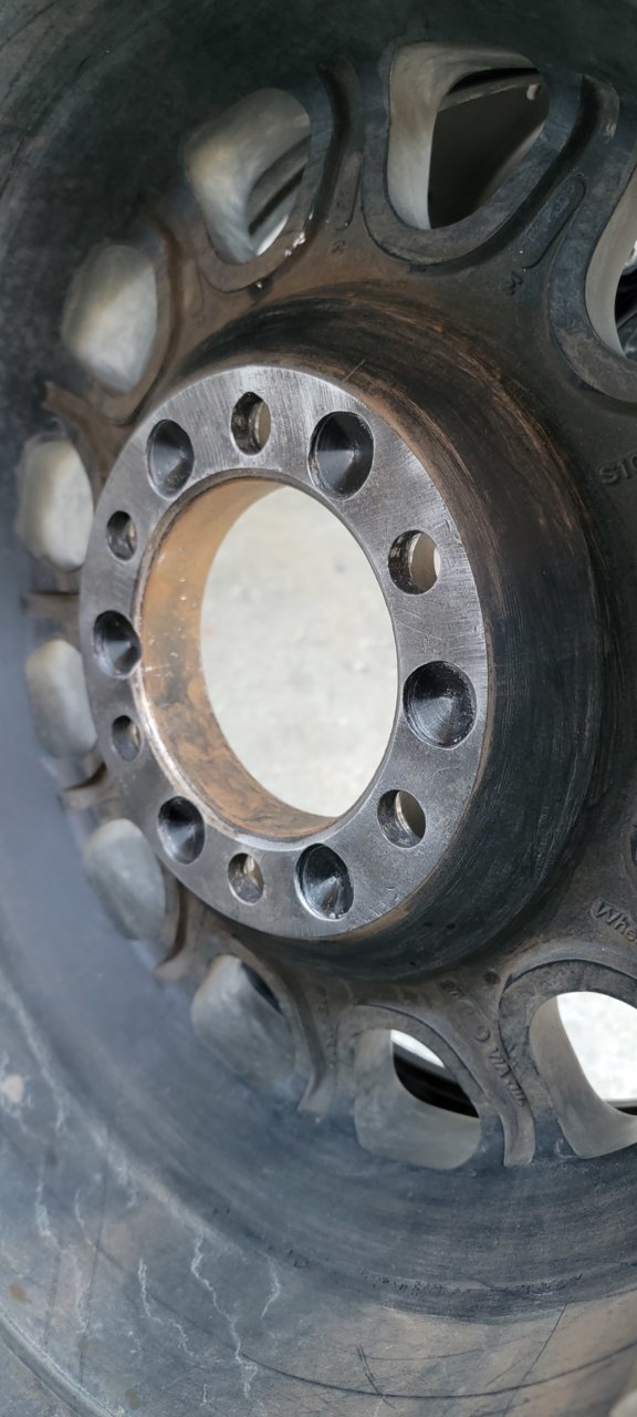

    On a side note.... roast me if you need but it worked. My options were to trim the studs or do this. I chose this. With my spc control arms I don't have enough offset to clear the arm. But 1.25 spacers were creating rub issues. So drilled little pockets into the wheel. Drove the truck a few miles and pulled off to check everything and all seems good. 20210603_192903.jpg 20210603_192933.jpg

    I think it was a good call. For the amount of times we change set up's on these trucks saving the wheel studs is the right way to go..

    That was my thought process. There is a ton of material there. Lots of wheels come with a huge space to begin with so I didn't think it would bother anything. Just need to pull off my rears and do those

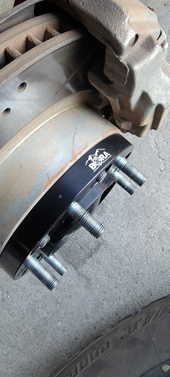

    District 6ix
    3G Tacoma on 35"s, 5G 4Runner
    50% more than what he got with the thinner Bora wheel spacers.

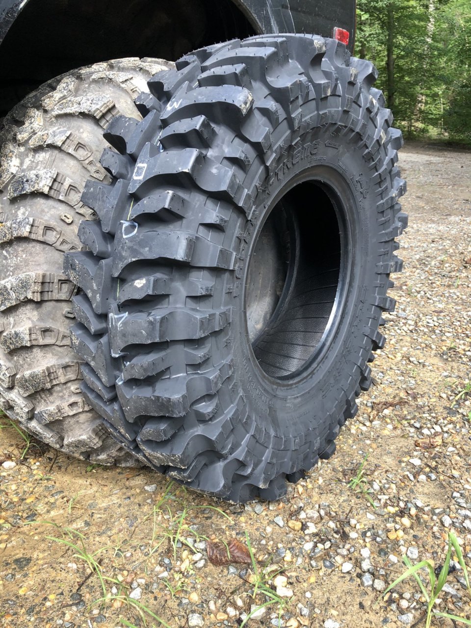

    Here's a nice 35"....
