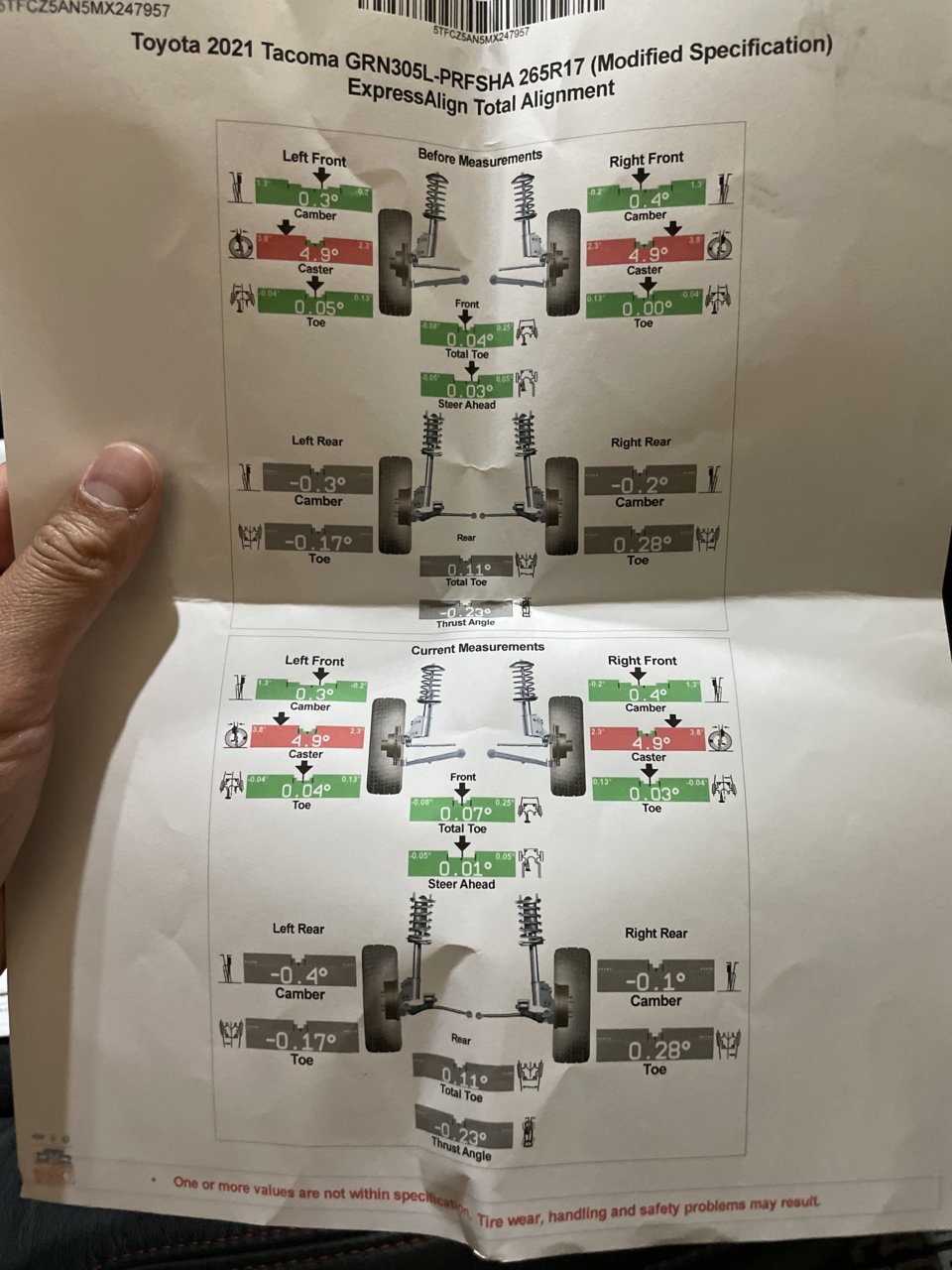

    Stormtrooper taco4x4
    Stormtrooper taco4x4 Member
    Nov 26, 2020
    #347913
    15
    2021 Tacoma TRD Pro
    35’s are on along with fender trimmed and CMR.
    Still rub on the body below the pinch welds. My caster is max at 4.9 already how do I fix this rub!!! Running kings 2.5ext with Camburg arms
  20. Jul 16, 2021 at 8:13 AM
    #1380
    clg
    clg Well-Known Member
    Jun 28, 2018
    #257747
    202
    2017 Off-road
    Have you hammered the wells yet? You should be able to get at least 1/2" clearance with some sledge love.
