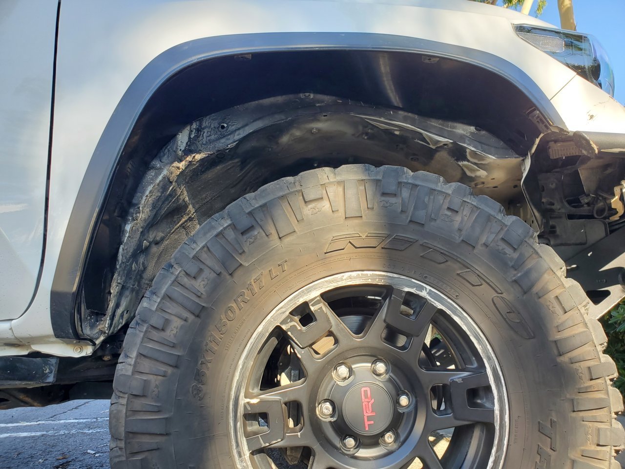

    I hammered the pinch welds but im not sure I can hammer the bottom part below it that's the part that im rubbing

    You can absolutely hammer it, and in cases where someone is wanting to minimize rubbing under articulation and near lock, it'll be necessary. Work the entire area evenly avoiding at trying to max out one area before moving on, you want to avoid creasing and aggressive hammering can open the pinch weld.

    Yes, you’ll have to hammer the firewall. Also, your upper control arms are adding caster by the upper ball joint having been moved rearward so in turn pushing the tire towards the rear. Alignment numbers don’t equal clearance. You could switch to an SPC UCA that uses an adjustable upper ball joint which will allow you get the wheel further forward vs the non-adjustable ball joint uppers. SPC’s don’t have the cool factor but they work and have plenty of travel if still using stock LCAs.

    Get SPCs and run less caster just by adjusting the upper balljoint forward, and yeah hammer that shiot in!

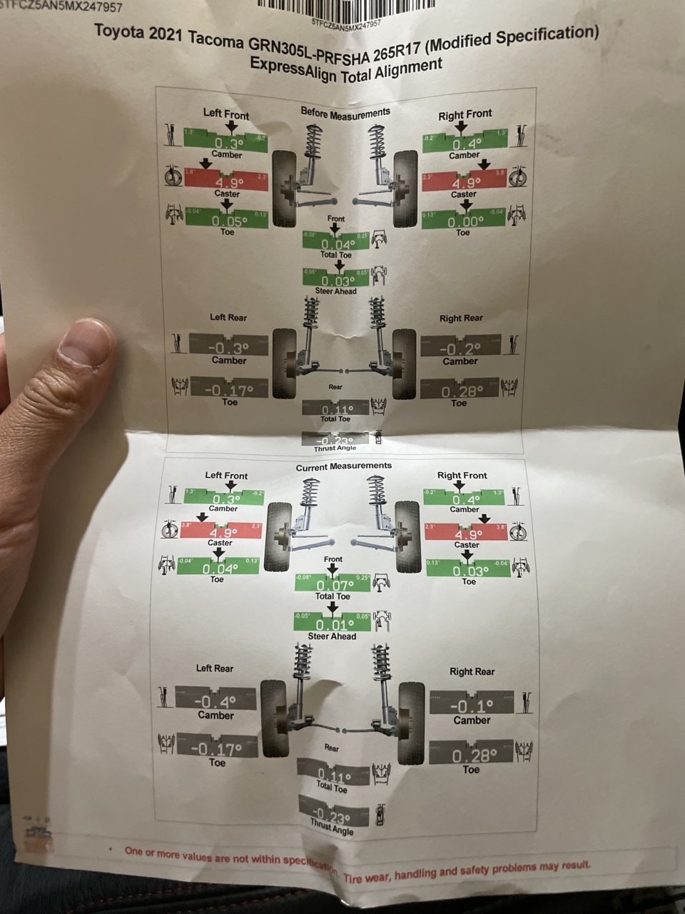

    Can you send a picture of your cams? That’s way too much caster which is probably pulling the wheel back on compression. I’m current at 1.7 caster but we need to see the cams.

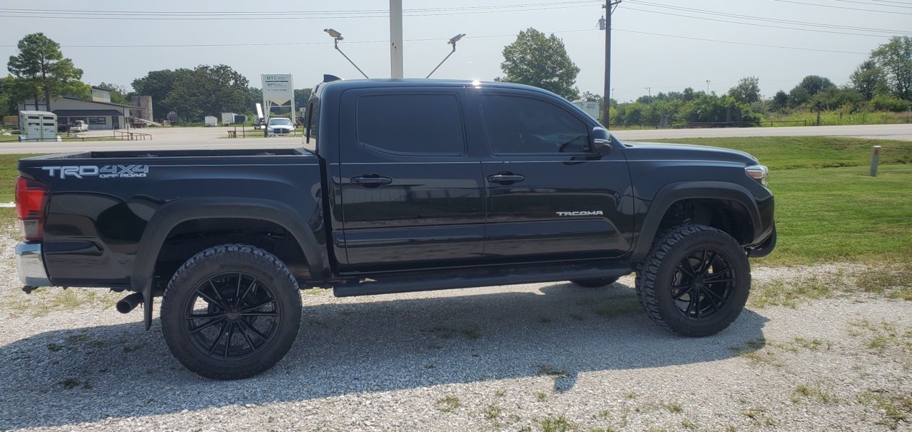

    no rubbing here on 20's
