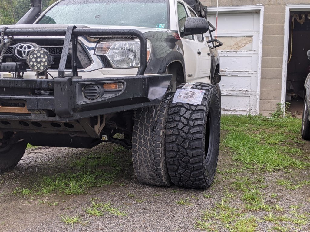

    No turning back now. 4.56 installed this past weekend. Now I just need the wheels so I can figure out where it's going to rub.

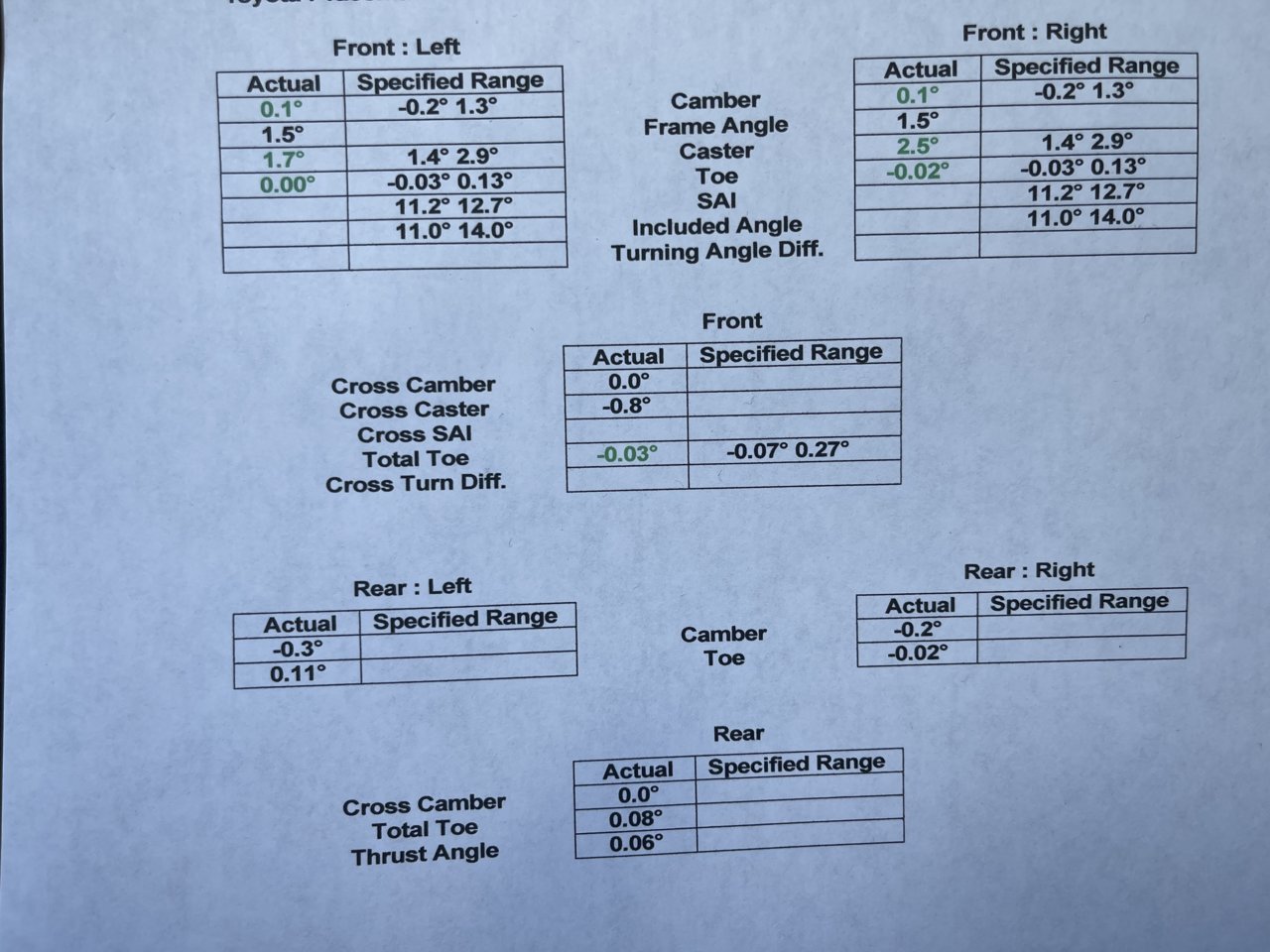

    9CF5D33F-3D0C-443E-83C8-339C701DAC76.jpg 867F5427-38AB-4628-AB0B-E941539730A4.jpg Stepping up to 35/11.5/17 from my 33s. Just told the alignment shop get me as far away from the rear fender as possible this is my alignment #s hopefully it’s enough. I have an aggressive cmc. Fingers crossed

    Dec 30, 2012
    #94017
    1,397
    It looks like they did a good job. What UCAs are you running?

    1,397
    I was more curious if you had adjustment at the UCA. Your alignment tech did a good job. I used my SPC’s to set camber while the lowers were cam’d all the way forward. Your setup looks great! Congrats! :thumbsup:

    Spc
