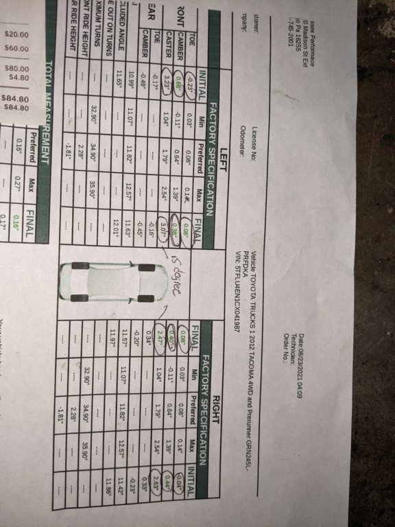

    I'm going to be adjusting my LCAs this weekend on my 2nd gen to gain more clearance at the firewall. After my 35s I had Firestone (with my lifetime alignment) align it, and told them to max the lowers for clearance. They obviously thought I meant just Caster.
    I'm going to max the rear Cams inward (to push the LCA away) to gain max clearance at the firewall. Then fine tune with the fronts.. then go back to have them actually dial it in without touching the rear Cams.
    Here's my before pics after Firestone aligned it. I rub in reverse, cranked.. and it's worse on the driver side.. and you can see why in the driver side picture and the rear cam position. I'll take after pictures once I'm done.

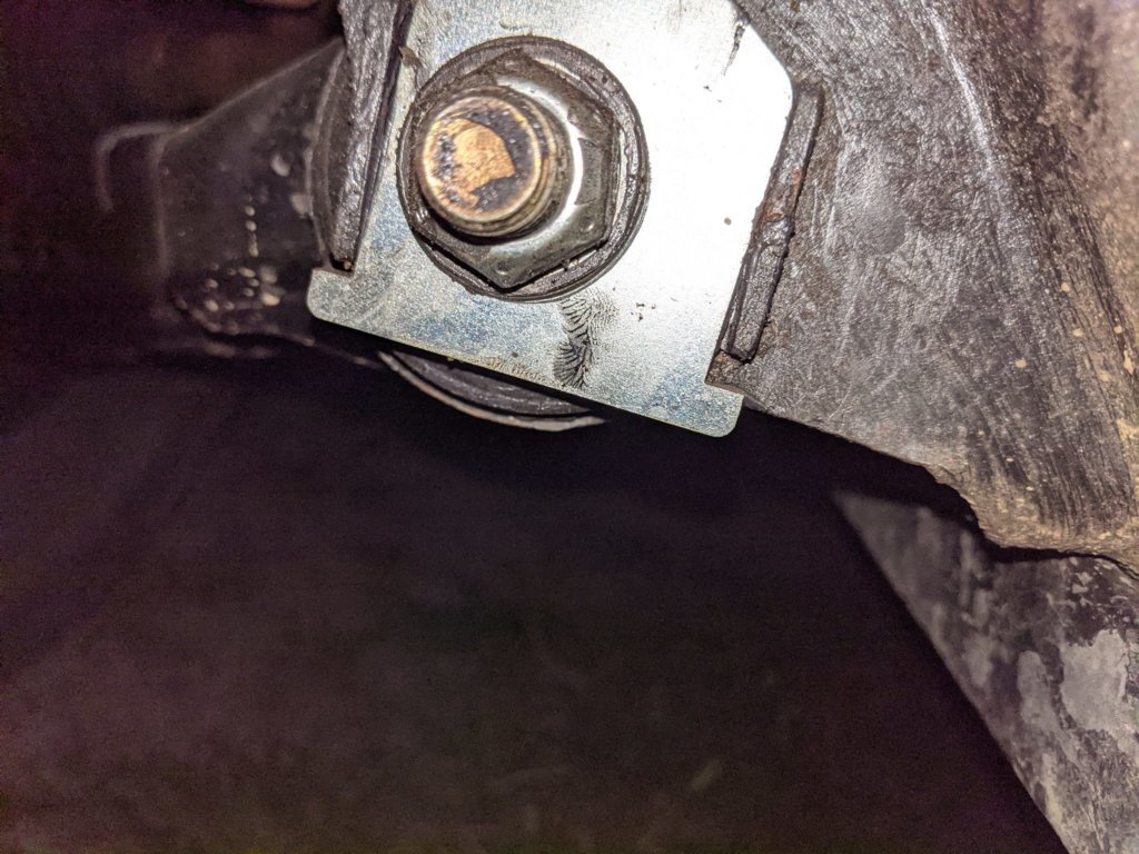

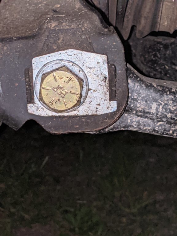

    I got my CMC fixed yesterday. Shouldn't have any issues there. I am running taco tabs with my LCA and have the rear outboard and front inboard. I am rubbing ever so slightly on UCA
    Would moving the front taco tab to the neutral position possibly gain the little clearance I need?
    I ordered some gorilla ET lugs. I'm not sure the extra 1/4" thread engagement is enough, but it's better than nothing. Hopefully get these mounted up this week. Can TPMS be deleted with a computer. It is no longer a daily driver and I check the air for most trips. With my sensors being almost 10 years old I don't think I'm going to swap them over. I'm running a 5 tire rotation and don't want to add the extra tpms if I don't have to. I also don't want the light on perpetually or build a canister.

    Hmm that’s interesting. So not to confuse terminology but the tab portion of the cam bolt should be outboard in the front and inboard in the rear. Just making sure cuz it could be backwards.
    There is some adjustment as well in the UCA that rotates the ball joint around. What setting are you at?
    I have 4” backspace wheels as well and I can stick my hand in between the wheel and UCA.
    Not sure what you can do about the TPMS light. I just leave it on and ignore it. I don’t run TPMS on mine either since I can’t reach the valve stems anyway on my wheels.

    Perhaps I have these backwards. I'm pretty new to all of this and jumped in way over my head. One way to learn though. I certainly appreciate the words of wisdom and experience.

    Looks right to me.

    Yup thats right, only adjustment is the SPC, do you know what setting they are at, C,D,E,F etc?
    Otherise a 1/4 Bora spacer will move it out enough
