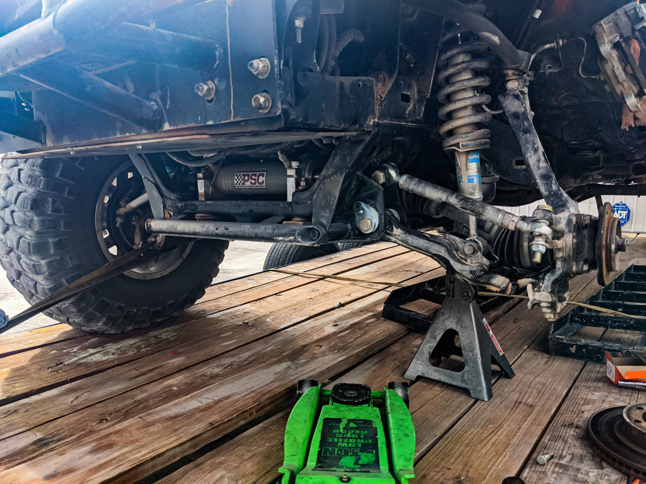

    yes. again... depends how you wheel. I've gone through 2 racks, multiple CVs, tierods, and LCAs, and even spindles with 33's.
    I have been rebuilding the front end and beefing it up during the swap to 35's. Fresh spindles and Gusseted everything.. Dirt King LCAs with Delrin Bushings (the rubber bushings in stock lowers tend to go with heavy wheeling).. Back to Toyota Tierods (they last longer).. DRT Fab Cab mount relocate.. Need to finish my alignment and add my Bison cam tabs or get some Taco tabs instead. Upgraded to 6 Piston Wilwoods.. lots of clearancing.. etc.
    Now I keep spare CVs, tierods, etc in the truck. Next big upgrade is steering.. Howe kit and upgraded rack.

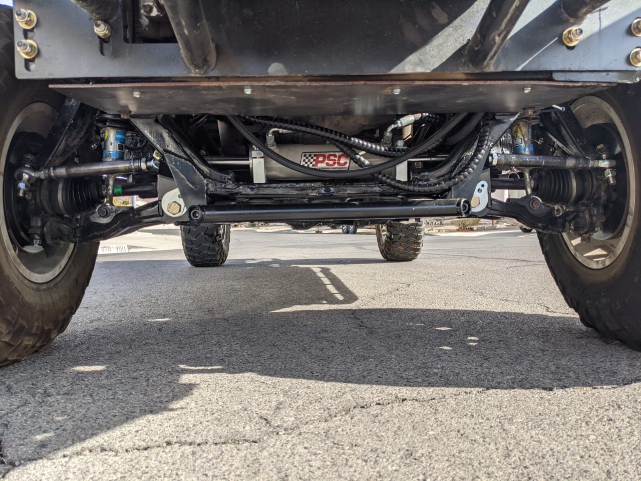

    Theres always going to be a compromise with steering, you wont find anything bomb proof without alot of custom fabrication.
    Howe rack and pinions are probably the best youll find, but fitting it is extremely difficult.
    Lc200 and tundra racks are fantastic and paired with hiem tie rods they will take alot of abuse. But turning in the rocks is still difficult.
    Or you could go full race truck and do full hydro
