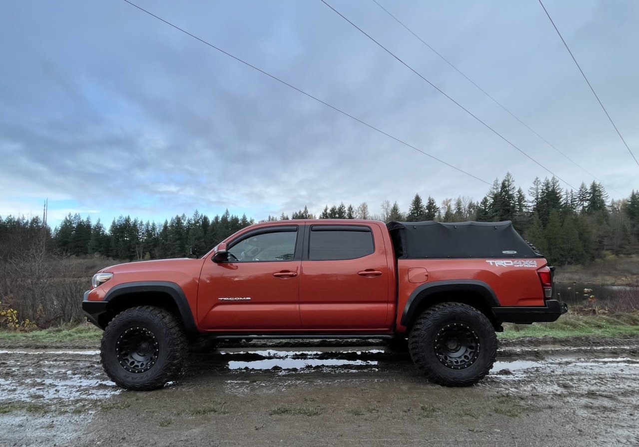

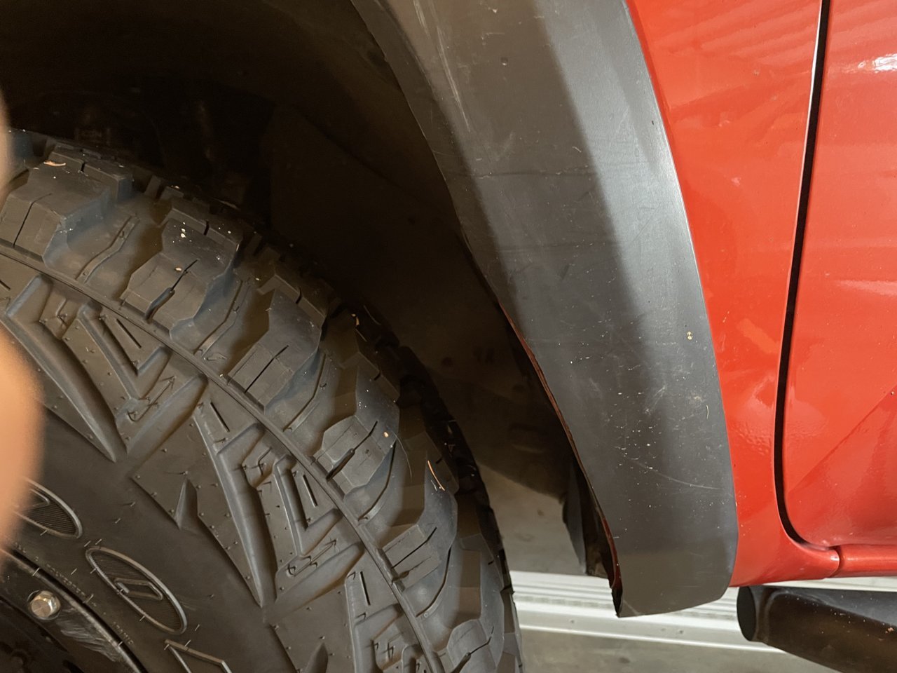

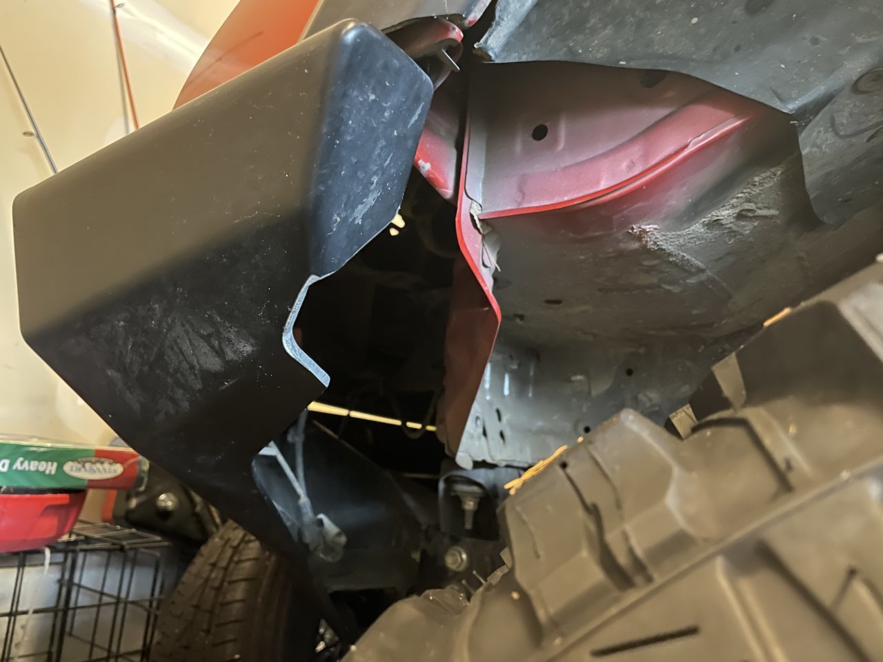

    Some pics of the cutting I did to get rid of most of the rubbing.
    I have the LCA caster bolts all the way forward. That definitely helped a lot in clearing the cab mount (even with a CMC). I had to trim the rear of the fender, parts of the pinch weld (will re-seam seal over it), and a little bit of the fender flare at the top. I also started to rub the front bumper after pushing the tires forward with the LCAs. It still rubs at the very top of the inner fender but I would have to do a minor tub to fix that. I think I will lengthen the bumpstop by just maybe 1/3" or so to prevent that from rubbing.
    And pic of it before the cutting.

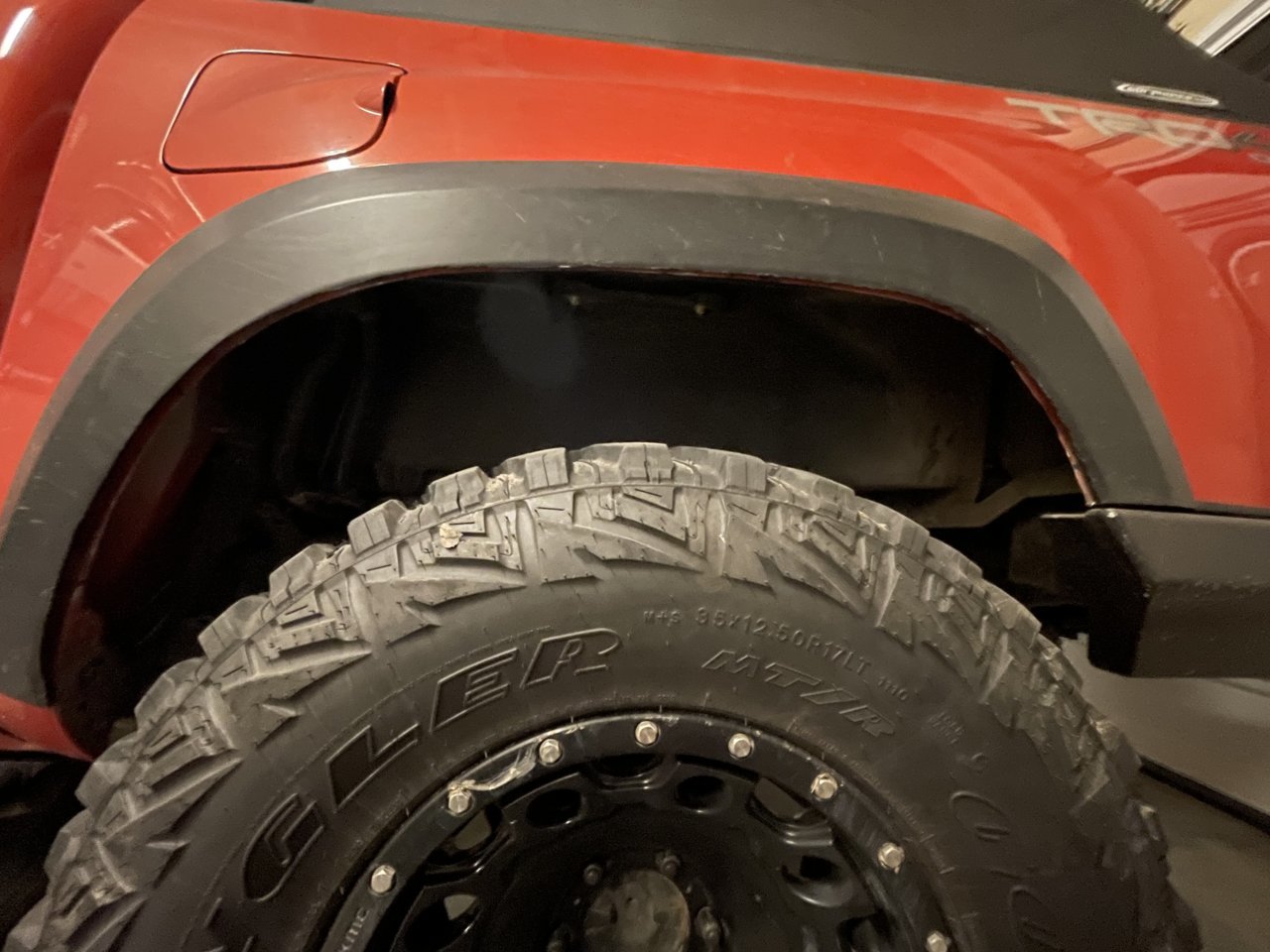

    Trimmed my rear fenders, haven’t fully cycled the rear but I might need to cut more.
