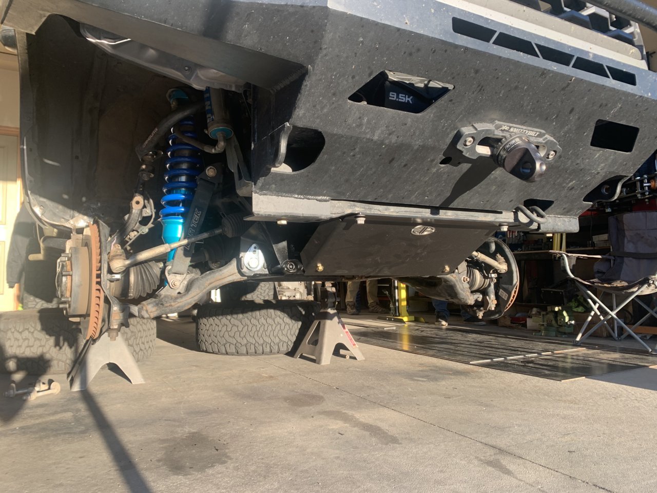

    Havent checked in for a long time. Still running 315/70-17s but on to my 3rd different wheel. RRW RR6-H 17x8.5 -25. Last weekend finished my JDFab install thanks to @snowsk8air2 (also installed 700lb springs and revalved my Kings because my truck is a fat pig) and was able to take the truck on Broken Arrow in Sedona today. I haven't done any additional trimming lately and had almost zero rubbing. Only on full lock left turns climbing or dropping a shelf/ledge. I think it might have been rubbing on a bent up piece of wheelwell liner thats still in place. Its really nice to be able to drive normally and even wheel some pretty decent obstacles with essentially no rubbing. It was quite an expensive route to get there and I still need to trim more.
    Because of my Camburg UCAs I have 8 degrees of caster that cant be "aligned" out. Im not sure if I will get the JDFab UCAs that have a slightly different offset to accommodate the subframe and get my caster back to ~4 degrees. This will definitely give me more clearance at the firewall but I might just go mid travel and 37s instead hahaha.
    edit: forgot to mention its SO EFFING NICE to be able to turn the steering wheel lock to lock, offroad and actually drive the truck forward and reverse without rubbing :rofl:

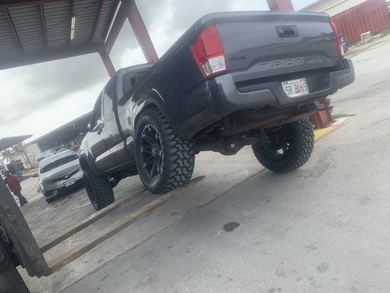

    Finally said screw it and slapped on the 35s now. 61982B42-4F6B-49DC-88C8-3A1D2F87A85F.jpg
