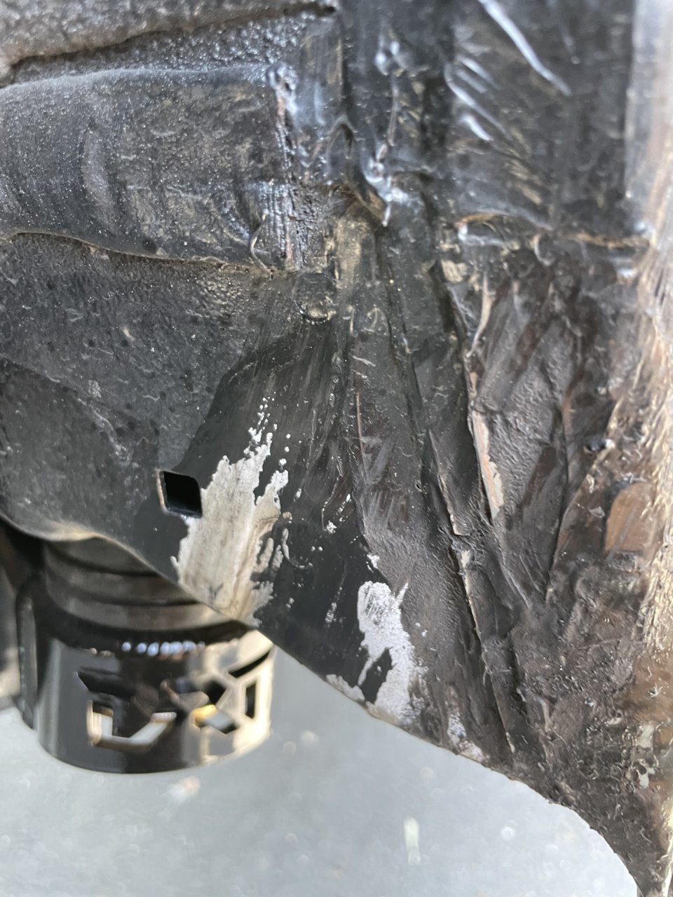

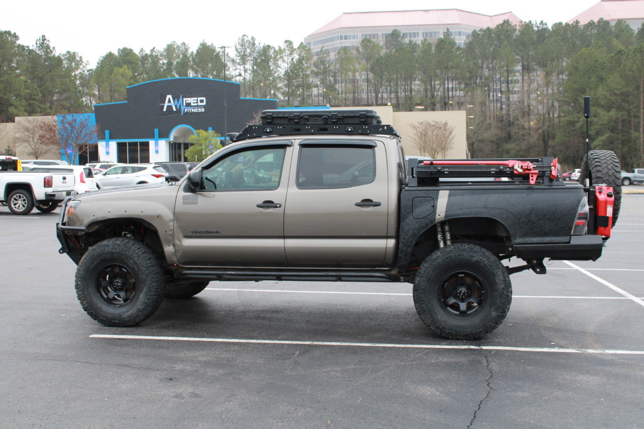

    Forgot to post in here when i slapped my 35's on a couple of months ago. I finally have the whole thing dialed in and don't rub anywhere on or off road. Im running 16X8 -12 4 inches of backspacing wheels. 315 75 16 tires. Ive got the caster maxed out on the LCA. Ive got the SPC arms set to +4. This gave me a good amount of clearance at the cab mount and with this alone it was good for street driving. I took it to the alignment shop and told them to just set toe and camber and they got it spot on. If your just street driving you should be good to go with no extra modifications. But going off road its a different ball game that takes some extra massaging. First i did a more aggressive CMC and angled the cab mount further back. helped with getting it away from the cab mount. This is actually needed for on road as well my bad lol. But the i also to about 2.25 inches off the flare. Lastly i cycled the suspension and found where it was rubbing and beat that part in with a hammer on the fire wall. Took it off road and full flexed and after the first couple of ruts what was left self clearance and now 0 rub! SPC really the only way if your not wanting to cut the whole sub frame or cut and tub fenders for other arms.
    CMC Redo
    [​IMG][​IMG]
    Driver before and after alignment adjustments.
    Passenger Before and after
    Fenders cut
    [​IMG][​IMG]
    flex testing
    No rub even turning in rut! Suspension full flexed!! :D
    eddjaure, Jseda845, DoulosXP and 6 others like this.

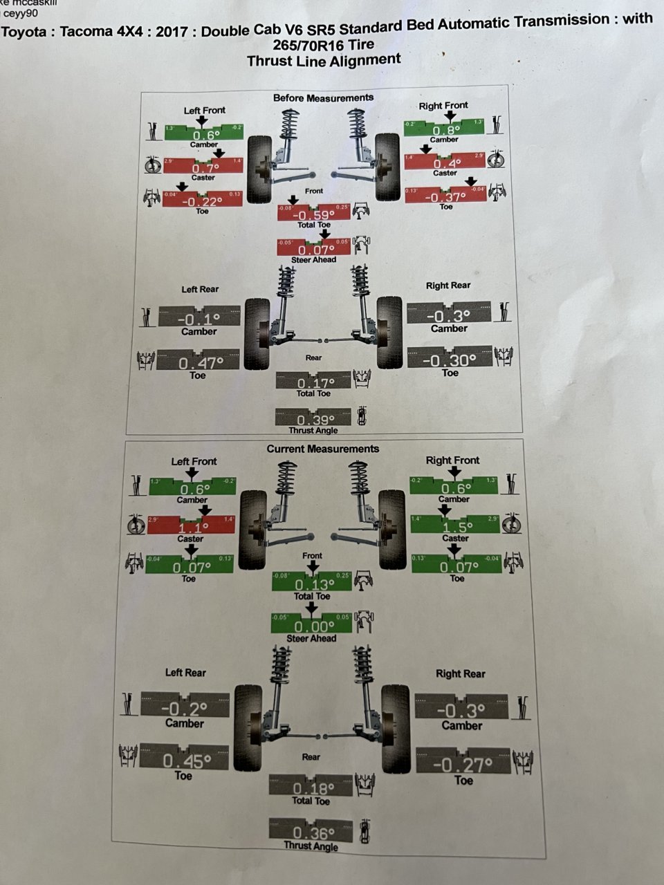

    Hey guys, thought I’d get yalls input before I started bashing my firewall in with a BFH.
    Some background- Right now I’m rubbing in reverse while turning and when I’m leaving my neighborhood (slight flex while turning). Haven’t even gone offroad yet to really test it, but if I’m rubbing onroad can’t imagine what it’ll be like in the dirt.
    I had the shop who installed all my gussets adjust my SPCs to push the wheel all the way forward, and it looks like they put it on setting G? Here’s a pic
    And this is the alignment they set my truck to-
    From my research in this forum, SPC position E is ideal with front cam tabs maxed outwards and rear tabs inwards. With my SPC position on G and none of my cam tabs maxed, it seems like my alignment could really be improved. am I tripping? I will probably need to hammer the firewall anyway, but I want to dial in the alignment before doing so.
    Any input would be greatly appreciated!
    RoaminRoman likes this.
  11. May 7, 2022 at 12:57 PM
    #1551
    Maxx
    Maxx Well-Known Member
    Dec 30, 2012
    #94017
    1,397
    Set LCAs all the way forward. Adjust upper ball joint until caster and camber is around 3-4 degrees, setting D for me. Fine adjust at the bottom but if you have to do too much in the bottom, add more caster at the upper until it’s where need it. Pull coilover and cycle and lock to lock. Hammer and cut as needed.
    Colorado_Taco17 likes this.
