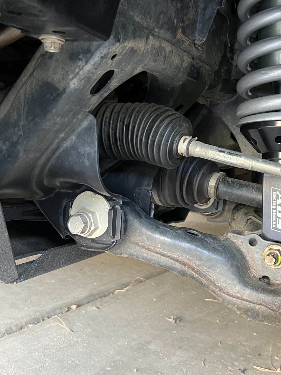

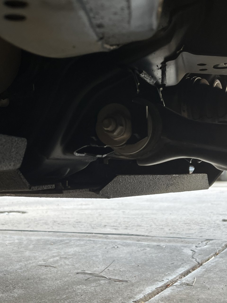

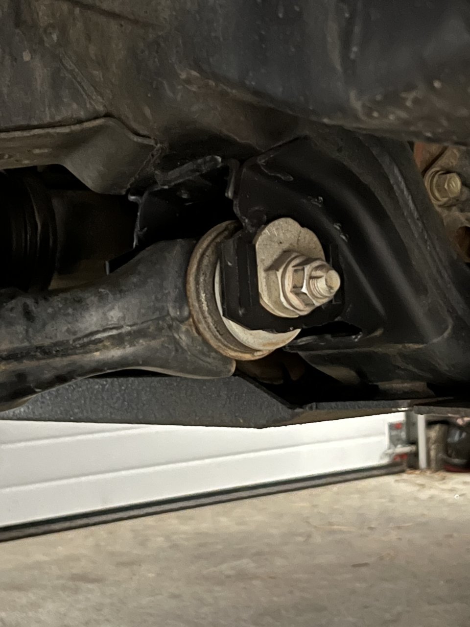

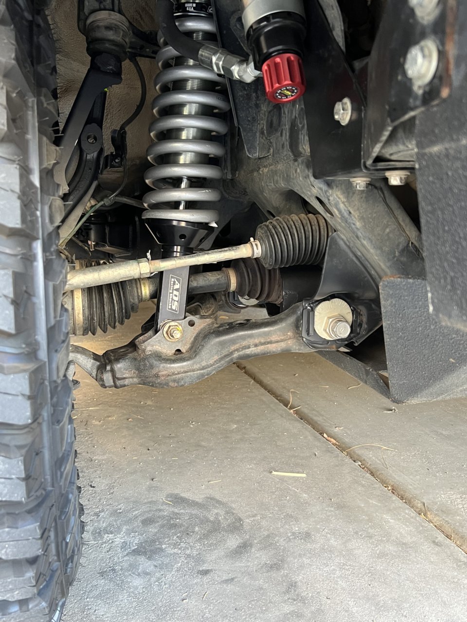

    Sorry, should have posted these initially as well. This is the driver side front
    driver rear-
    passenger front-
    passenger rear-
    only one that appears to be in the correct position is passenger rear. Current caster measures far less than what it should be, based on what I have seen on this thread thus far. I appreciate the help!

    They aren’t using the Spc’s to align your truck. They are doing it all off the lower cams.
