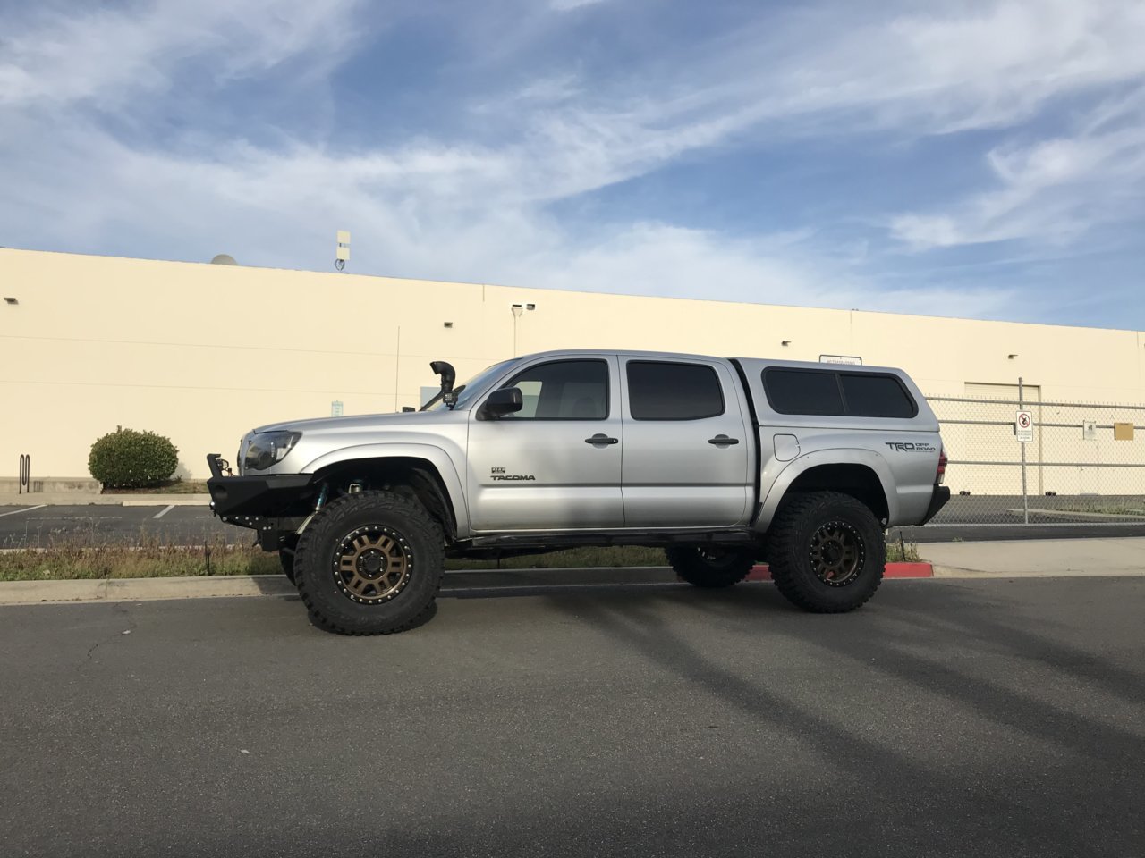

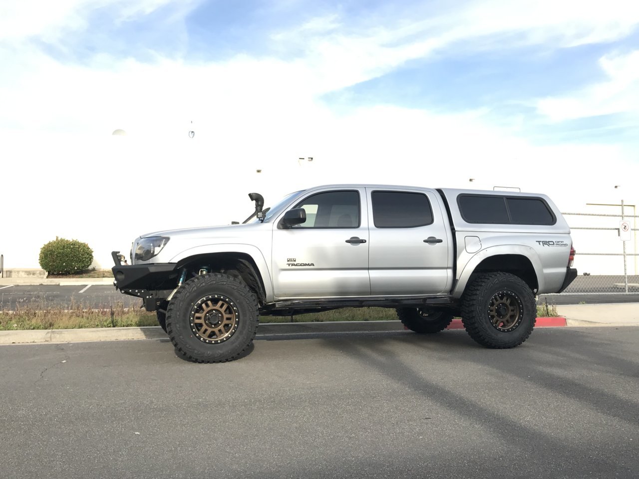

    Had my 35x12.5’s mounted yesterday. A little taller than my old 315s, but a little narrower. Only about 60lbs per tire.

    That is all the extra info I didn’t want to really go into with my earlier post. I was trying to keep it kinda absolute bare bones and still get the message across that it involves a lot to clear 35s. Kudos for putting the alignment info together so that others can see the how and why the alignment needs to be changed to fit 35s.
    Although the other part of my brain tells me that if I had a straight axle up front I could move the whole assembly forward and have way more room up front...
    tetten[QUOTED] likes this.

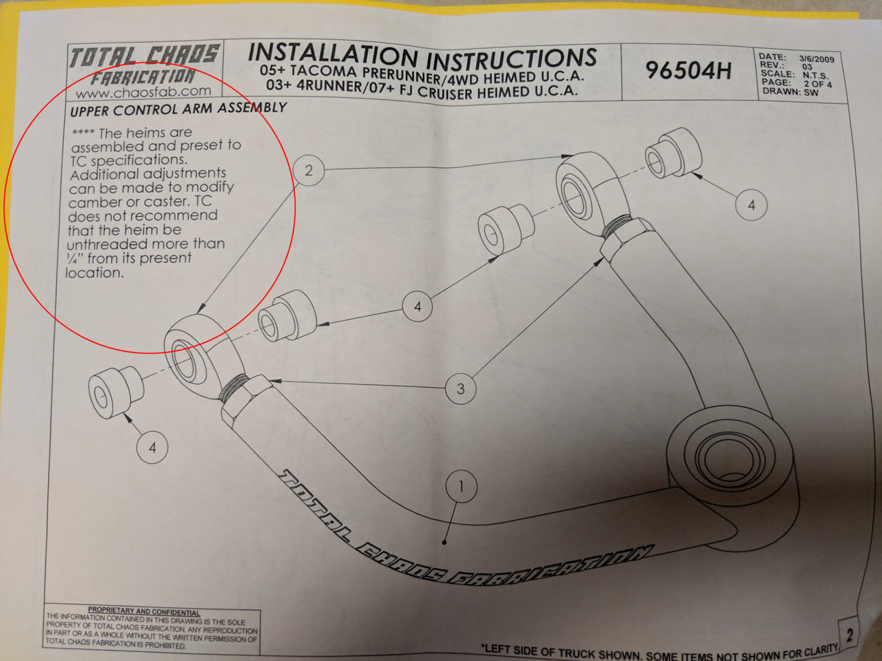

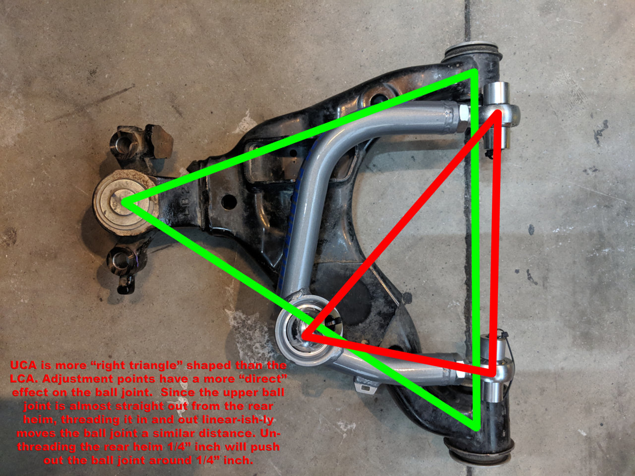

    They help with the caster loss after lifting just like the other UCA. What's nice about the move-able ball joint UCA's is you can take your truck to an alignment shop have them set your caster, camber, and toe. If your truck feels squirrelly on the highway after the alignment or think that the steering is too hard, you can change the position of the ball joint to increase/reduce caster without affecting camber or toe much, if at all. They have other benefits too, they aren't my cup of tea, but I can see why others find them appealing.
    Heimed uppers would definitely help if your frame/shock towers are tweaked. Before I bought my +2 kit I asked jberry which options were worth the money and time to deal with. He said heims are worth it and wished he had them on his 2nd gen. Shock towers have a tendency to start to tweak in board over time due to hard hits and all the cumulative small hits with the desert driving we do. When the shock towers get bent inboard they start to pull the entire UCA assembly inboard too and adds negative camber. Being able to adjust the upper ball joint outboard can negate those "bent shock tower" effects. Some downsides to heims is obviously the increased cost and they don't absorb vibrations like rubber or poly, its a metal-to-metal joint so you might feel more of the road through them.
    If you decide to get heimed UCAs be sure to get a tubular design. I think there might be 1 or 2 other companies that make heimed tubular stock length uppers other than TC....I could have sworn Camburg made them too but I only see the billet/box style on their website. I wouldn't recommend the billet or box style for stock length. There's not a lot of room in our wheel wells/suspension systems especially with stock length components and "boxed" designs are usually larger and take up more room and can cause interference issues on the coilover reservoir hose, spring, and the actual framing/sides of the shock tower. I had issues myself and have seen others have issues too. Here is a photo of one of my old Icon billet set, after tinkering with the heim positions I was hitting the UCA on the side of the shock tower at droop. IIRC I was also able to hit the spring with the UCA as well. There are ways around some of these issues, like clocking the spring so it doesn't interfere, grinding out the shock tower interference, and adjusting the reservoir hose....but fuck that, why do that extra work when there's another design that doesn't have those problems.
    Also be aware there are limitations to how far you can thread the heims out. They might have enough adjustment to take up your negative camber, if not, they could probably get you close to 0. Here's a photo of my UCA instructions with the limit. If I recall correctly, the Icons had a similar limit.
    You could thread out both heims if you needed to. Like the LCA, the heims on a UCA affect both caster and camber, but due to the shape of the UCA the effects are much more direct, so the front heim wouldn't be doing much for the camber. Here's a couple more diagrams that might help explain it better. I reworded some of my previous statements, it might make more sense this way.
    The front heim affects caster significantly more than the rear, here's another diagram/example....
