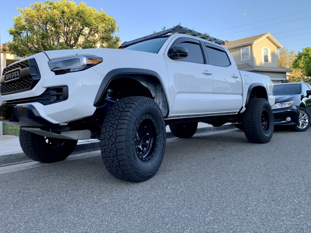

    315/70/17 new member here. I’ll post picture of the whole truck later.

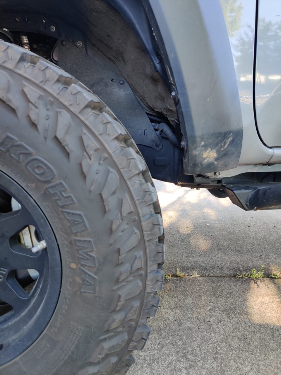

    How’s everyone’s steering rack after 35’s? After month on 315/75 I have this clunk/pop at low speed turns left or right. After the truck sits over night that 1st turn leaving the parking spot it’s very loud.

    No issues after hard wheeling.

    More than likely a bushing or joint

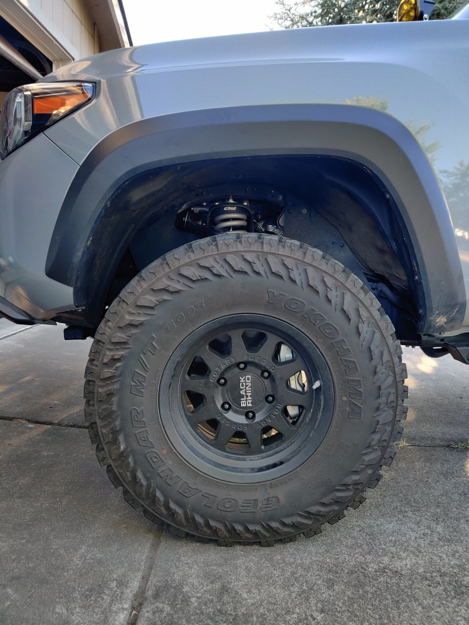

    I just moved from 265/75-16 & JBA to 285/75-16 & SPC with CMC. Wheels are -10 offset. Been trying to keep trimming down to a minimum but gotta get back under and do some more LCA adjusting after reading through this thread. I originally had the LCA's maxed out with the JBA's although not anymore and running in the SPC "D" ball joint position. Gonna try the "E" position with lowers moved forward.

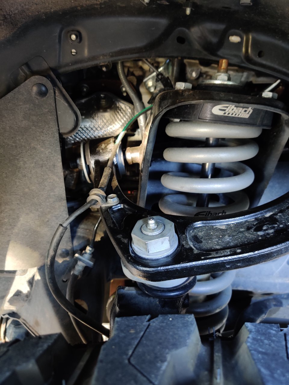

    With spc’s make sure your lca cams look like this. And then do all the other adjustments up top.
    JDSmith, Brian422 and JDPNW like this.

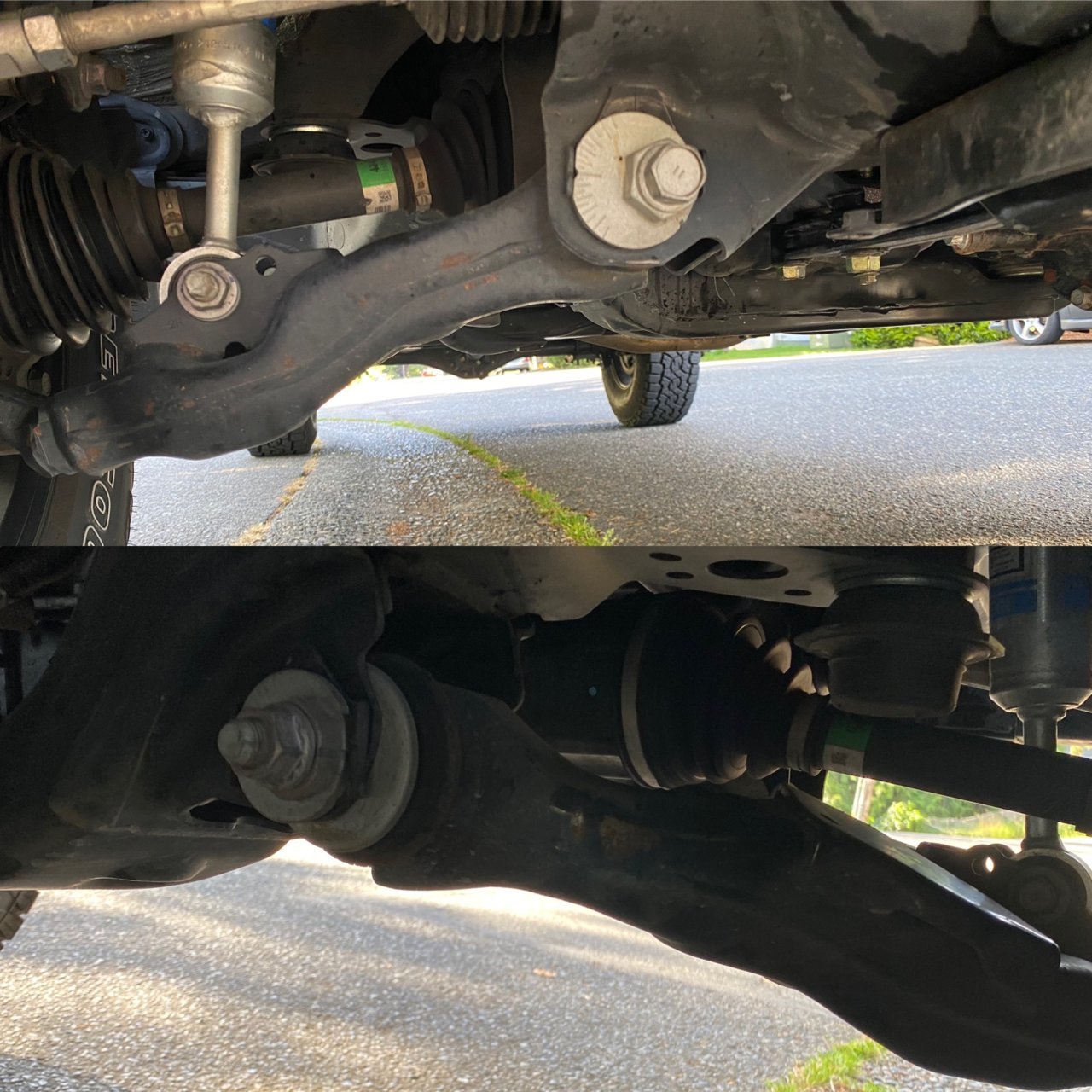

    Ready for alignment tomorrow. Bottoms adjusted and top spun 1 notch fwd to "E".
    H3llRid3r, GillyLink, kas2828 and 3 others like this.

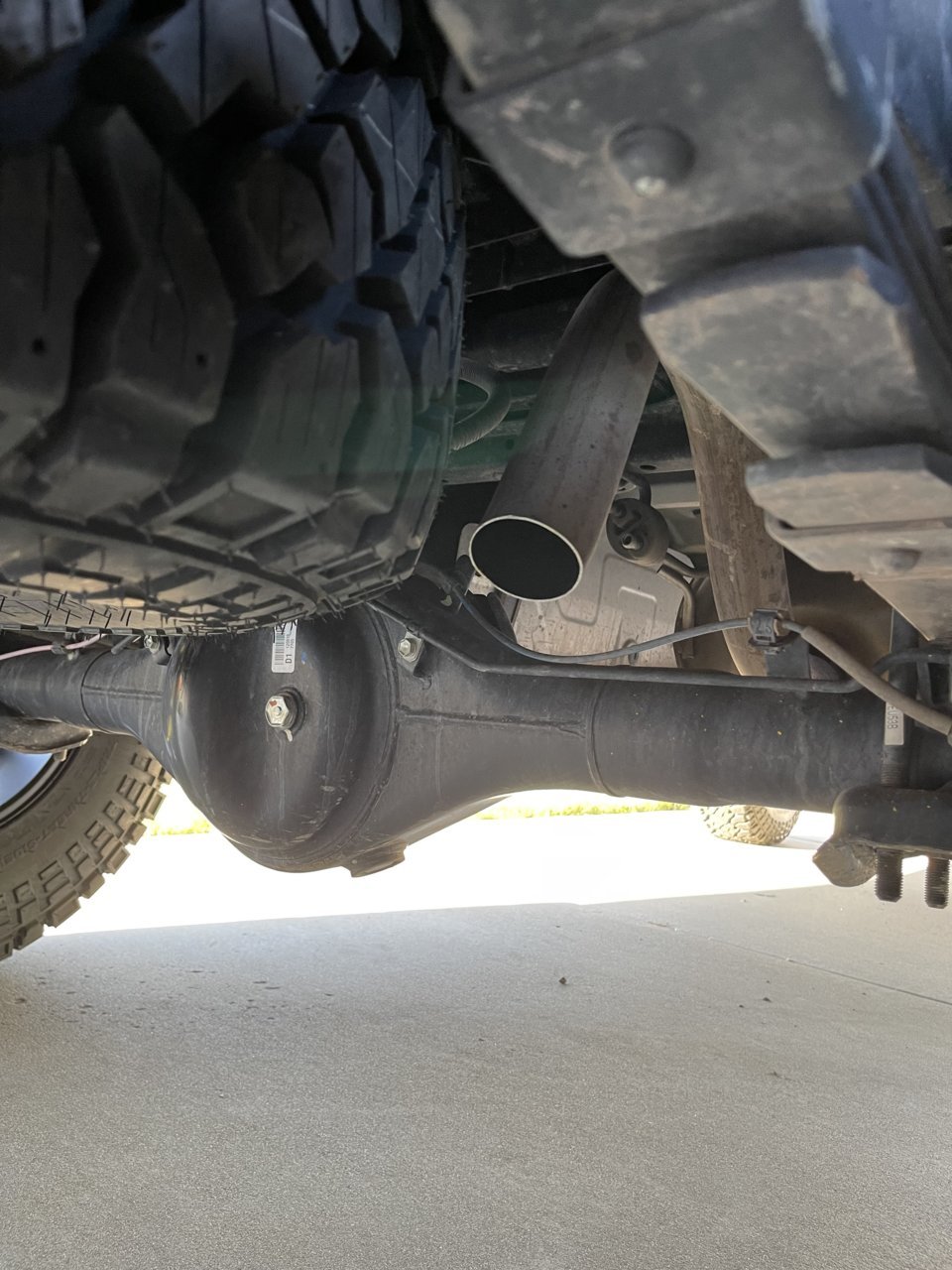

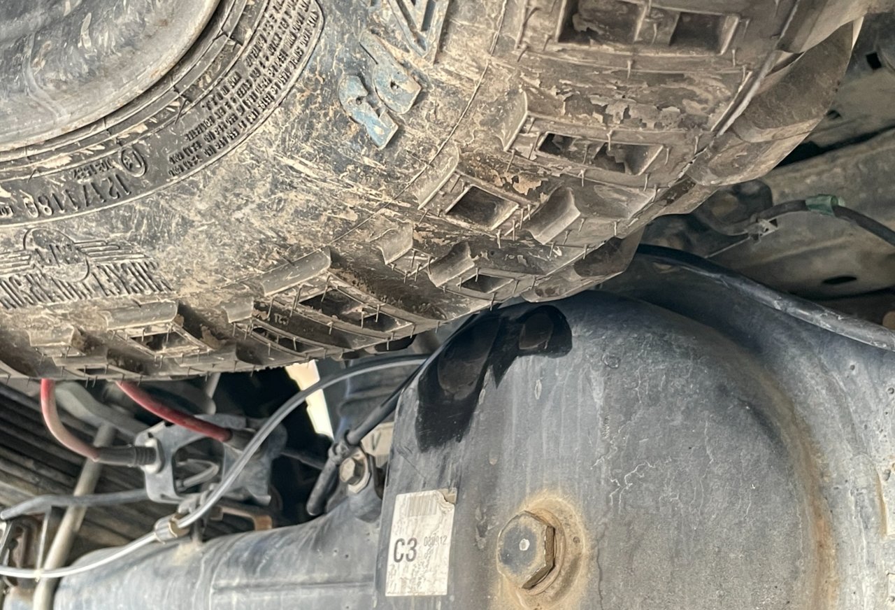

    What kind of voodoo is this?? I BARELY got my 33 to fit and it rubs the crap out of my diff. I had to move my brake line because the spare hit it.
    GillyLink likes this.

    When you get a 35, moving the spare tire hoist makes no difference. Your up against the hangers at that point.
