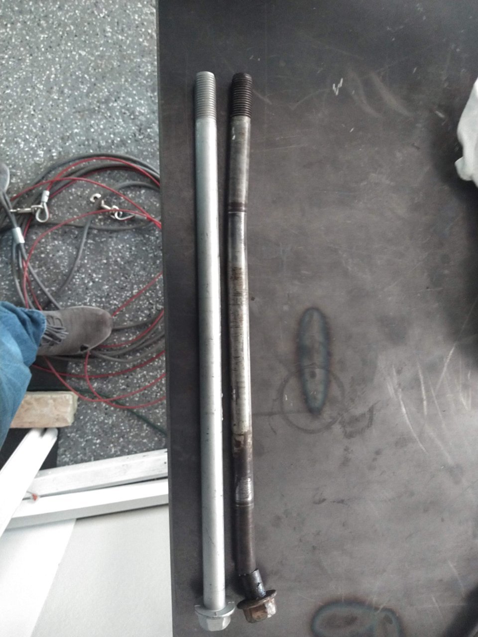

    I usually laugh when people spend big money on billet upper control arms, but dont double sheer the mount. Your more likely to bend the bolt than do damage to an upper arm, especially when on a heimed setup.
