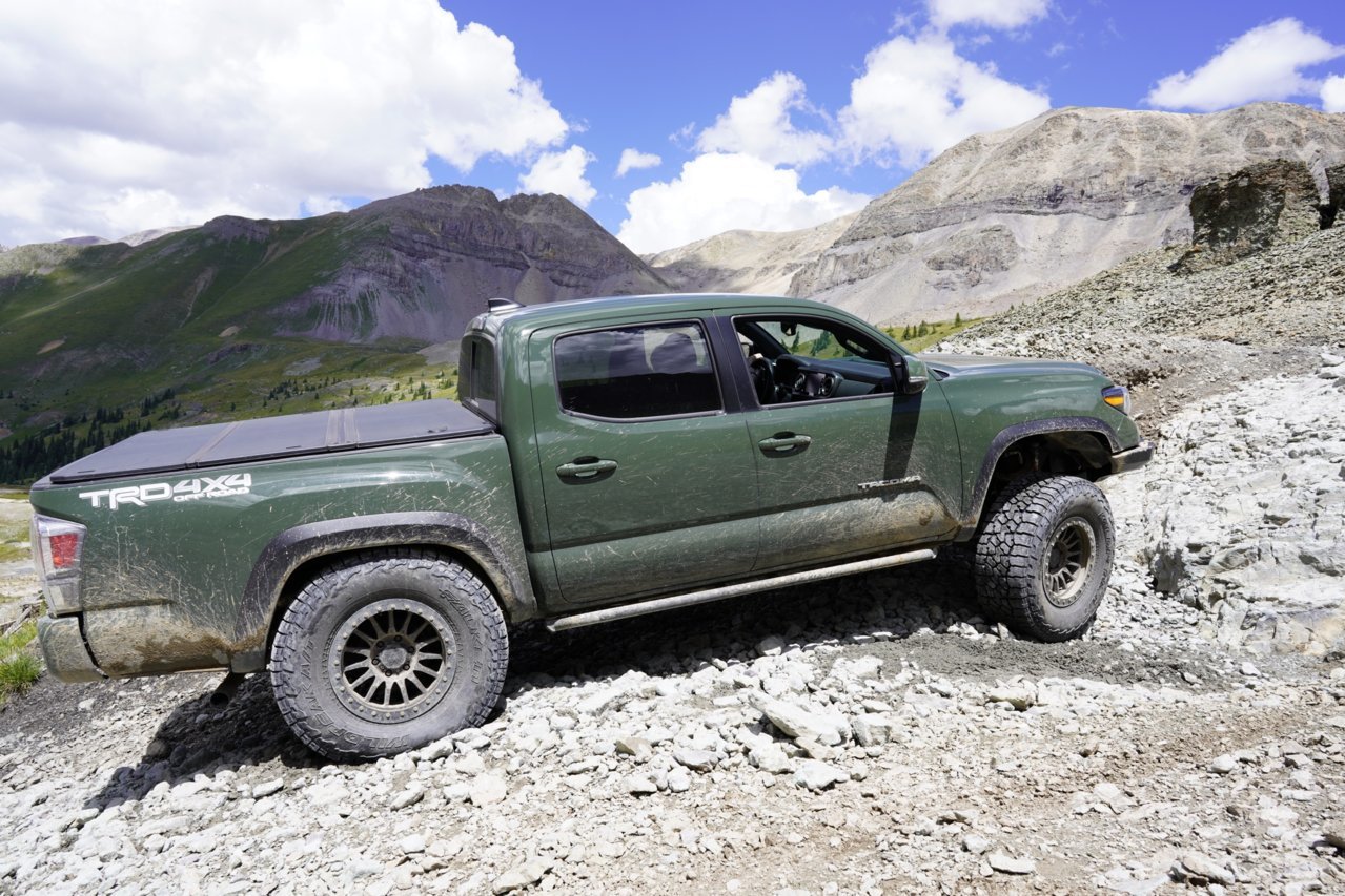

    I’m finally in the club. 315 75 r16 Patagonias are on around 16x8 0os SCS F5s, lifted 3 in the front 2 in the rear lift, TC UCAs, warfab tie Rod sleeves, all installed yesterday. After a quick lap around the block when I finished, some slight rub on the CMC full lock, and when flexing a bit on turns. Going to get an alignment today and ask to push caster as far fwd as possible. Wish me luck guys, real test will be a big trip up to bald mountain for a poker run in September.

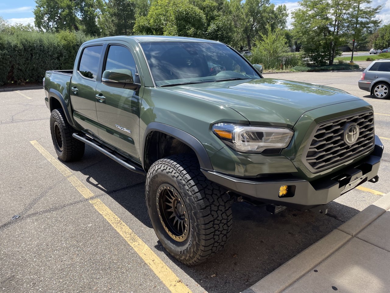

    Thanks to this forum I have successfully fit 35s. Going for another alignment to push the tire further forward since my lower cam tabs are all in neutral positions. I guess my fault for not having the larger tires on the truck just telling them I want maximum clearance wasn’t enough even for a dedicated Toyota off-road shop in Colorado. Oh well just money.
    -12 offset rrw RR-7h
    Falken wildpeak at3w 315/70r17

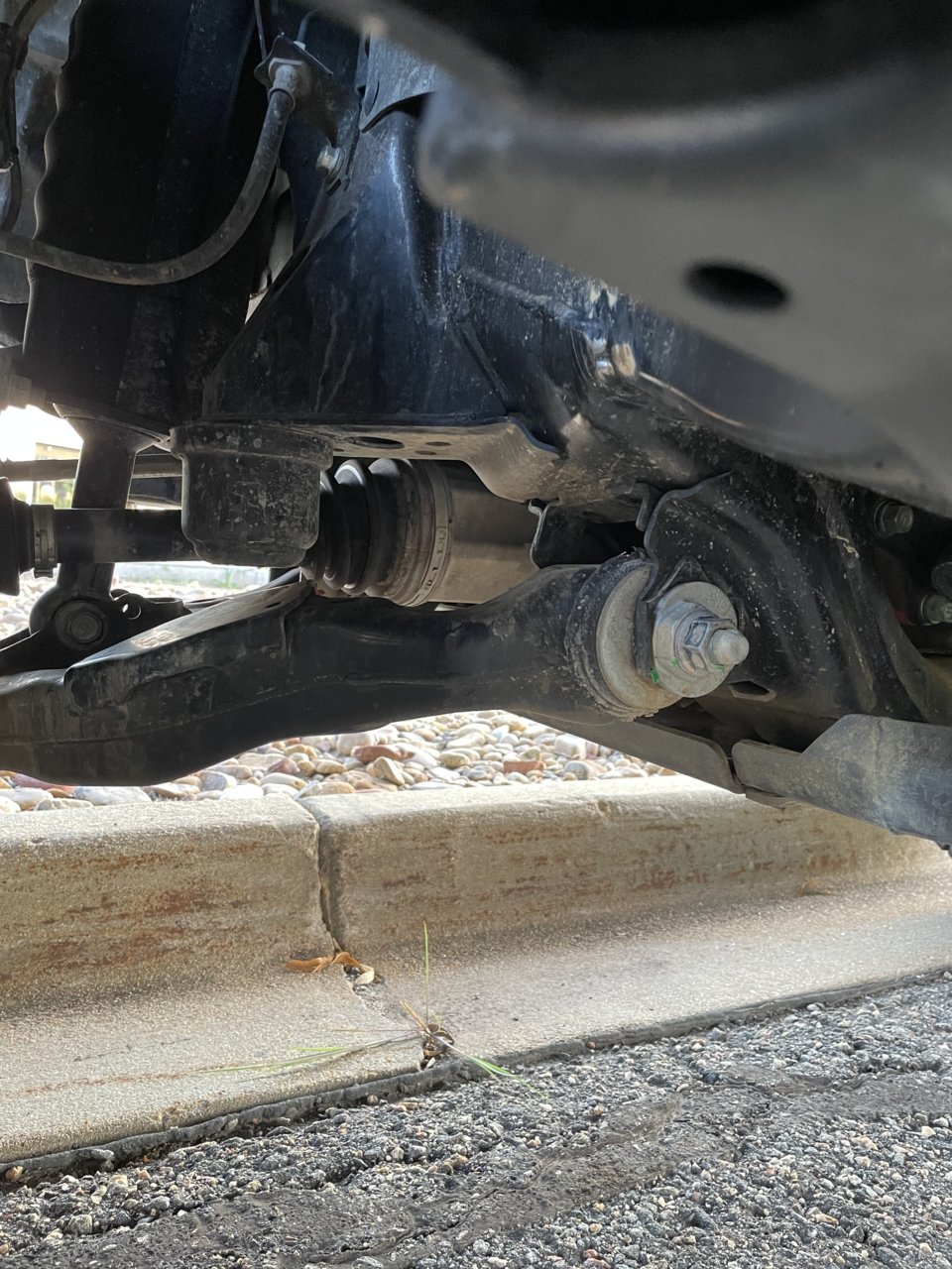

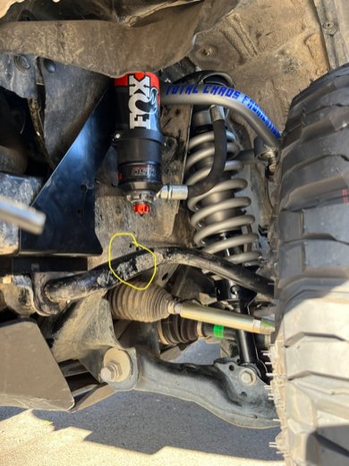

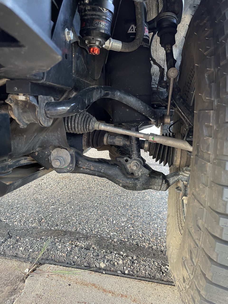

    Exhaust reroute RCI steel full skid plates (front, transfer case, transmission) Front camera (anytime backup camera) RCI rock sliders AC Drip mod OEM locking tailgate Brite box fogster anytime fogs Backwoods adventure mods hi-lite front bumper with Baja designs squadron pros ARB single OBA Fox 2.5 PES DSC 2-3” Wheelers superbumps + ubolt flip kit Deaver stage 1 u402 Cab mount chop+fender trim Rrw RR-7 -12 offset with 315/70r17 5.29 regear ARB front air locker Z precision big cupholder
    Here’s my final alignment. Plz roast it to know if I can trust this shop. They didn’t understand how more caster reduces clearance but I’m still happy with the clearance improvements so far just based on looking at it. Maybe there’s more to be had :confused:
    SPCs in position A. I don’t want to run D/E because the ball joint they pushed almost all the way in and the rubber boot barely touches my springs at full droop. They said that’s normal for SPCs and big springs like on fox shocks
    Front driver
    Rear driver
    Edit: looks like my SPCs are running +4 caster so I’m at 5.2/5.5 caster which will reduce clearance to my cab mount chop some but maybe negligibly so. Is that too much caster to run? Drives fine but wondering if things end up weaker or something

    that's not how caster works. The caster your truck is running is what the alignment sheet shows. They should rotate the front driver side bolt 45 degrees clockwise so the bolt is in the 9 o'clock position. Then use the upper spc ball joint to get the caster number and camber number that you want.
    edit. after looking at your pictures further you are running the balljoint in position G which means it and the uca are adding 0 caster and the only thing it is doing is adjusting camber. Take it back or take it somewhere else and have them fix it, When I have done alignments on SPC uppers I shoot for 4 degrees caster and I prefer how the trucks drive with a little negative camber. I like -.5 degrees camber and .04 toe per side. Have them start by rotating the front control arm cam. Then you have to redo the caster swing and start monkeying around with the uppers, will likely land with the uppers in position b or c. By turning the front cam it will also force them to pull the ball joint out and away from the spring which will create additional room between the ball joint and the springs.
    https://www.spcalignment.com/instructions/25470-INS_WEB.pdf

    Yea it’s in G I always read the instructions backwards it’s annoying.
    so if I’m running 1.2-1.6 caster is this alignment not acceptable or just could be better? Passenger lower cam tabs are maxed out for clearance it’s just driver that isn’t
    i did some moderate off-roading from my last alignment and the machine already read a bunch different. Is this normal for alignments to get jacked up so easily with slow off-roading?
    they keep saying G gives the most clearance which I guess is true being lowest caster and that the alignment sheet doesn’t read right with SPCs which I get isn’t true now. Kinda disappointed since they put SPCs on all their rigs. I could try to go back but I think they’re likely gonna tell me I don’t know what I’m talking about just like when I tried explaining more caster reduces tire clearance but it’s all moot cuz I wasn’t talking to the guy doing the alignment since they don’t let you in the shop which makes sense for safety to some degree

    Having the ball joint forward like that does help clearance but so does moving the other cam to help pull the lower ball joint forward. You can get the same clearance and have more caster by maxing the cams. I hated the way my truck drove with under 2 degrees of caster.
