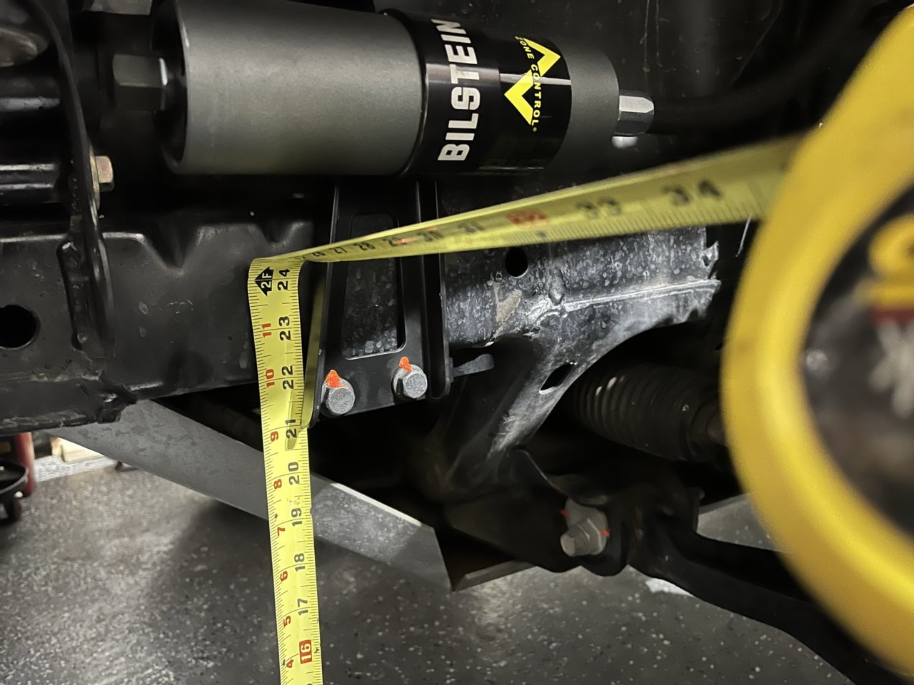

    When you are turned full lock, how far is your tire from the arm on the upper? With the 1" spacer I'm 1/2" from the upper on full lock (pic below with 1/2" piece of plywood)
    You can see the smudge where the tire hit the control arm without the spacer.

    I really appreciate all your help. Unfortunately it's the front arm of the UCA that I'm concerned about. I clear the ball joint area. My tire hits the front arm of the upper before full lock when not using the spacers. The trick to checking at full lock is to turn the wheel all the way and then turn the truck off. The wheel will stay at full lock that way.

    Awesome, thanks, that helps a lot. My tires will be about 3/8" closer but it looks like it'll be fine.

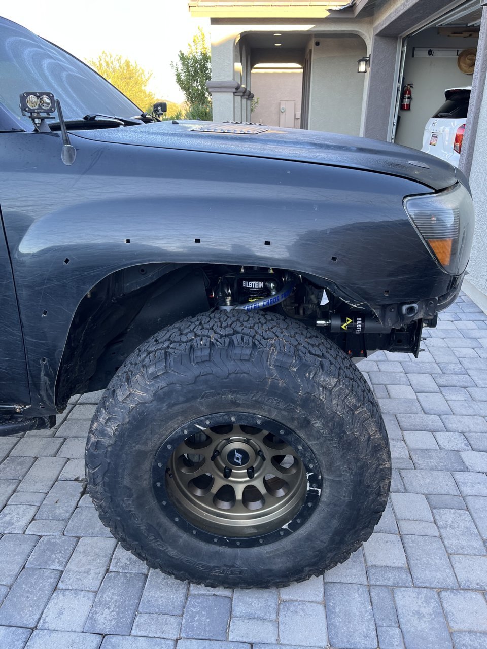

    Anyone running DK tubular UCA with 35s? I have a cmr, pinch weld cut/hammered and fender liners cut up. Looking to avoid cutting fenders/flares but will if I have to. Also, wheels are 17x8.5 -25 offset

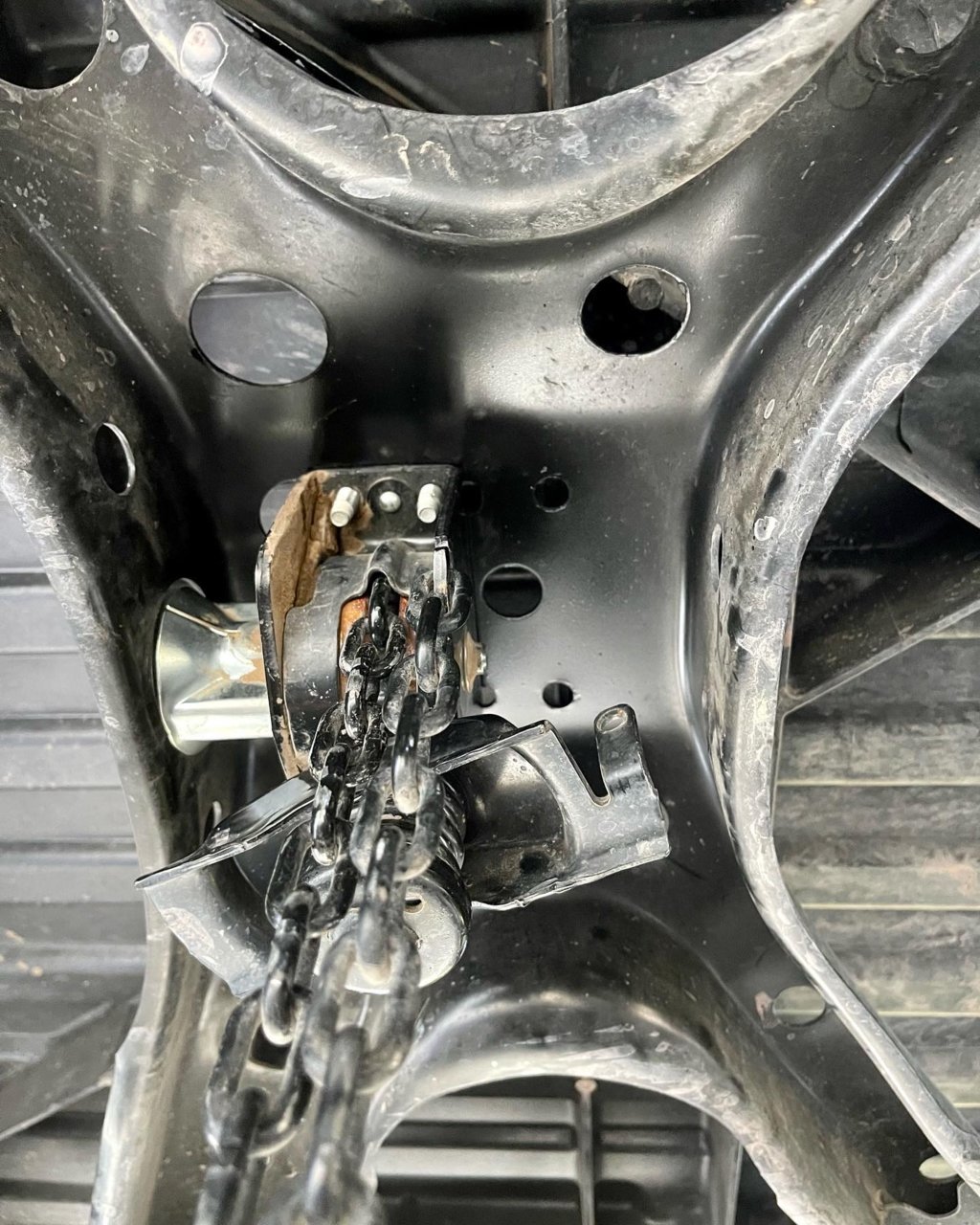

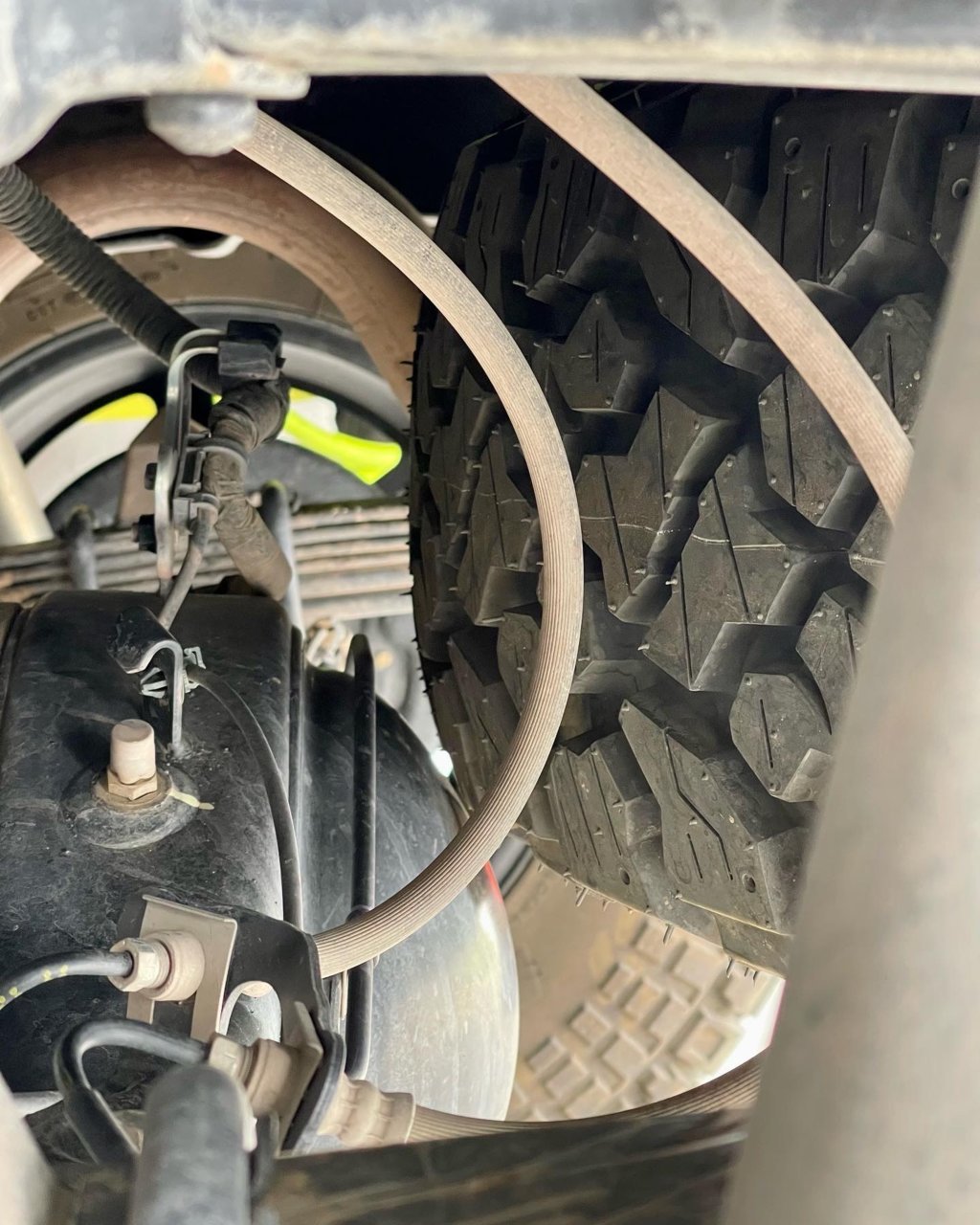

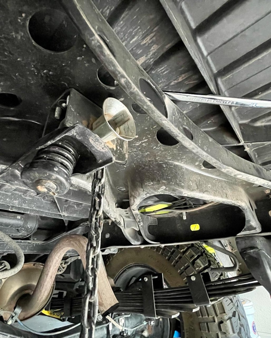

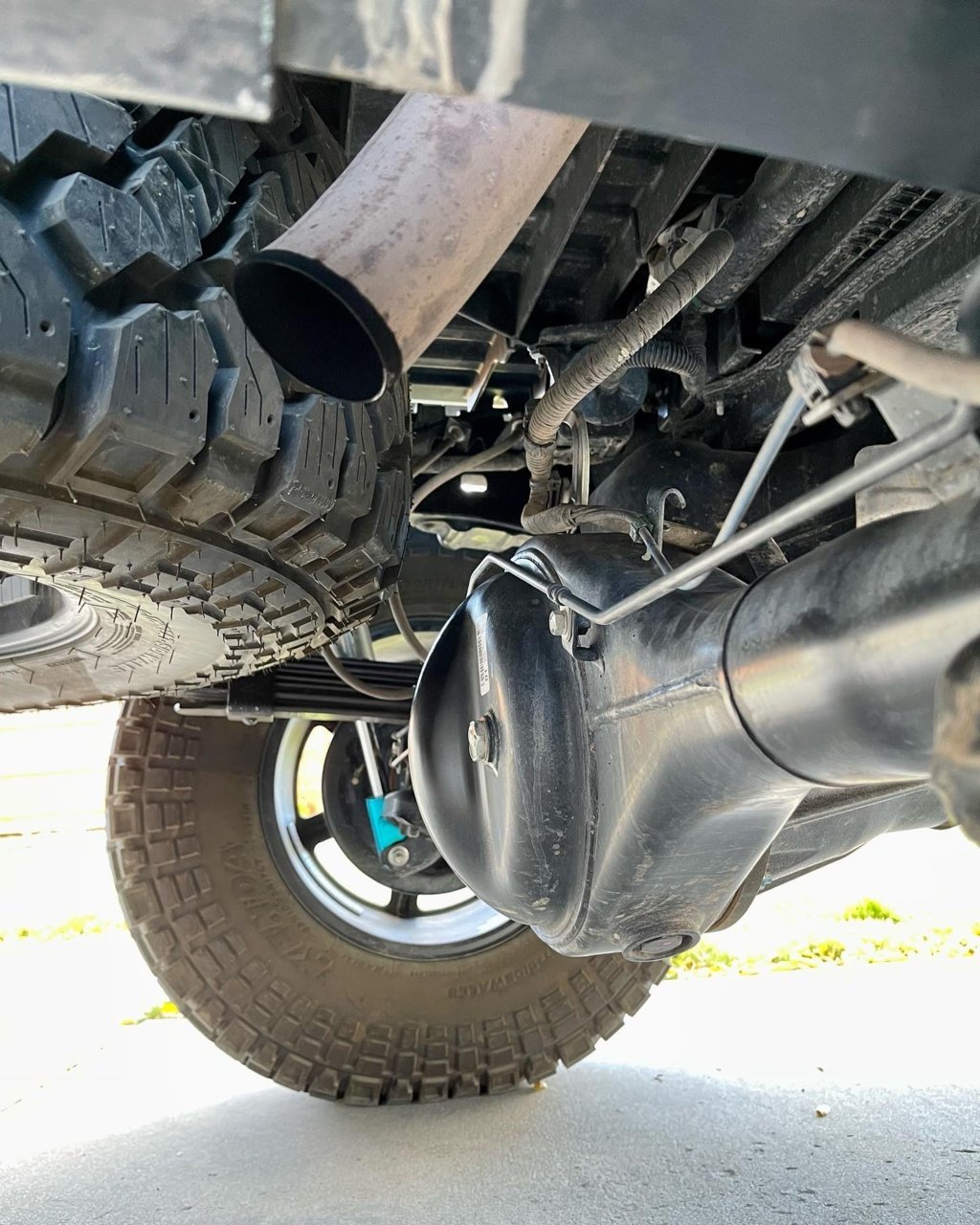

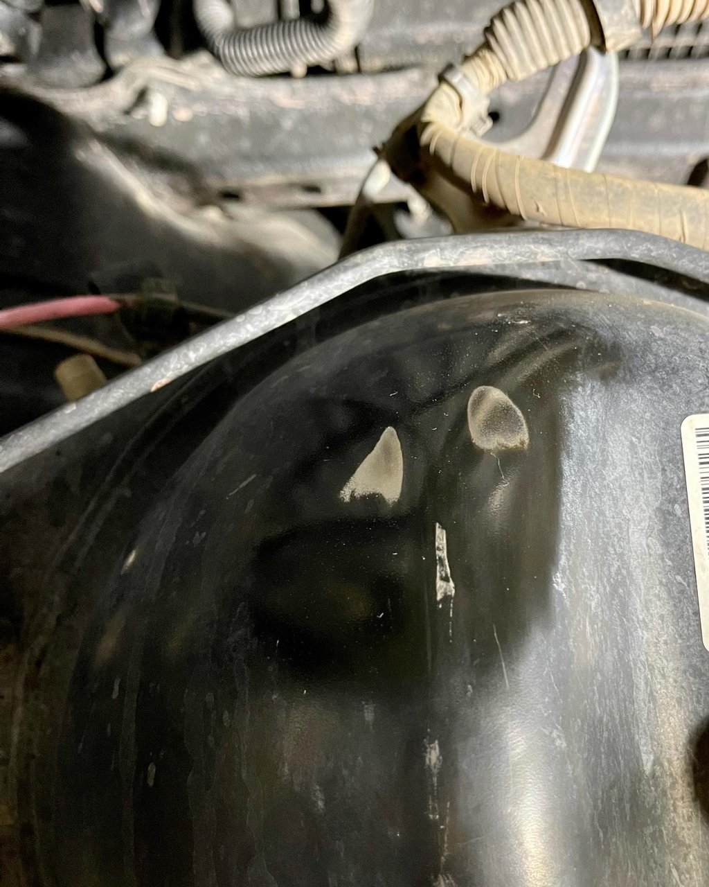

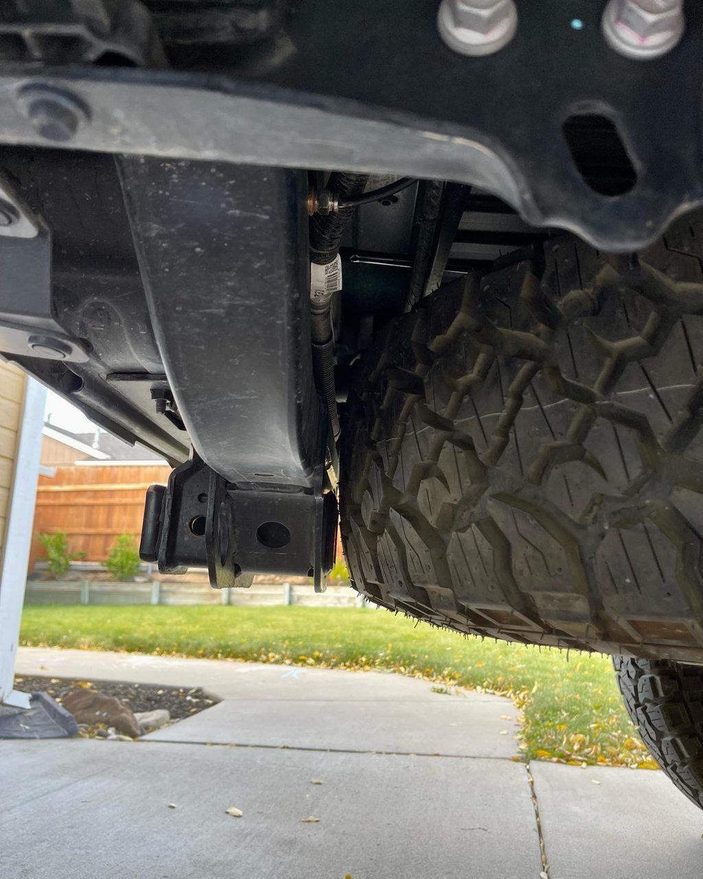

    Relocated spare tire hoist for more clearance. My 35 10.5 r17 was rubbing my diff

    It will make its way back to its old home if you ever do hangers. Diff rub is a way of life. Lol

    why is it that hangers allow it to slide forward? Do they allow more clearance as far as the space from hanger to other hanger?
    I’m probably going to go with DRT fabrication hangers

    The hangers are just a little tighter and since the tire is a circle, it moves forward where it was before relocating the spare tire hanger.
