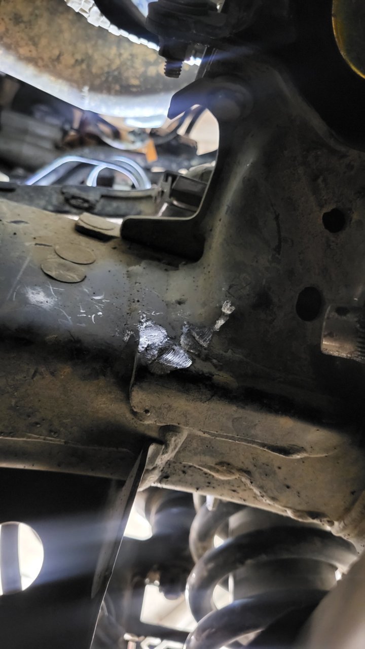

    I envision having to lift the motor significantly on top of pulling the header and removing the diff in order to notch the frame. I figured line up where the shaft would go and cut out a good slice of frame and weld in some angle iron. I think your way sounds much better than having to notch.

    I ran my setup un touched but under load the steering shaft flexes around, so it got into the frame a bit. Took 10 seconds with the grinder to smooth a cunt hair away, all good now.

    looks like when your body flexed it would hit too.

    Precisely the problem, but slapped it in last minute before a trip so didnt have time to "wheel" it and test it. Works cherry now that I'm not fighting the frame :rofl:

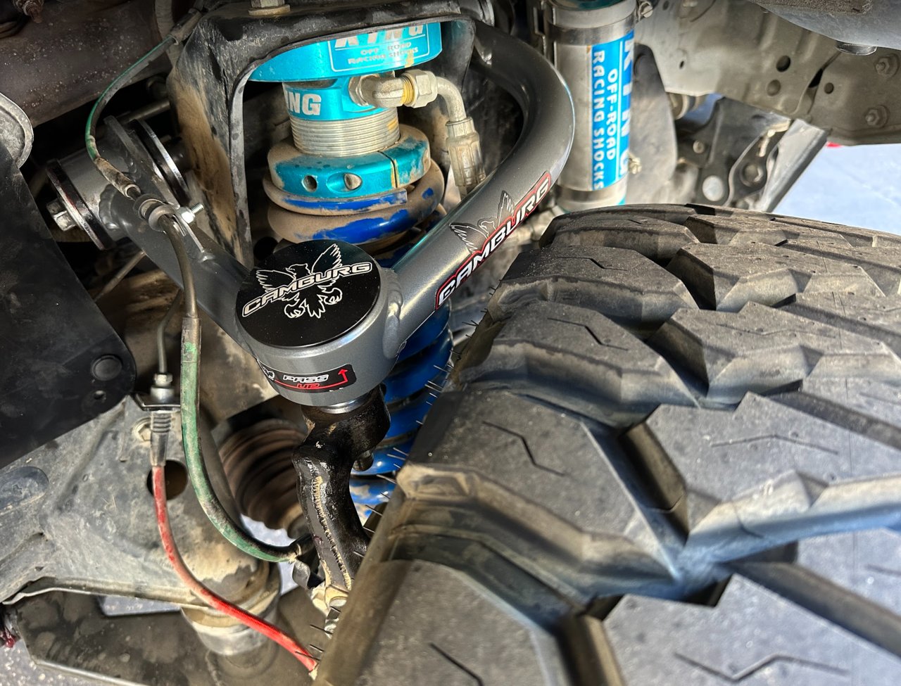

    **UPDATE**

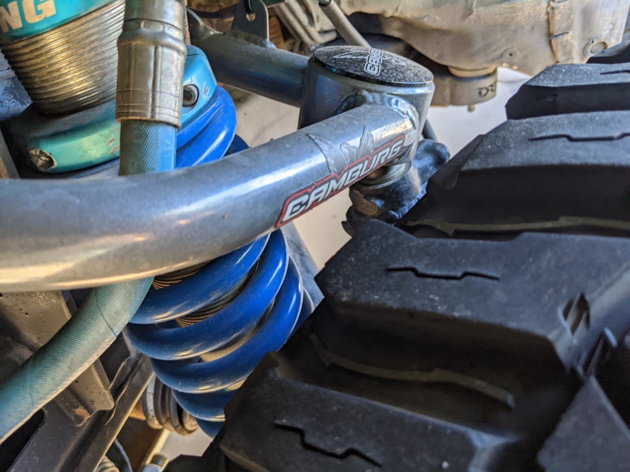

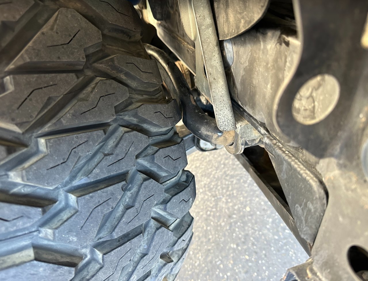

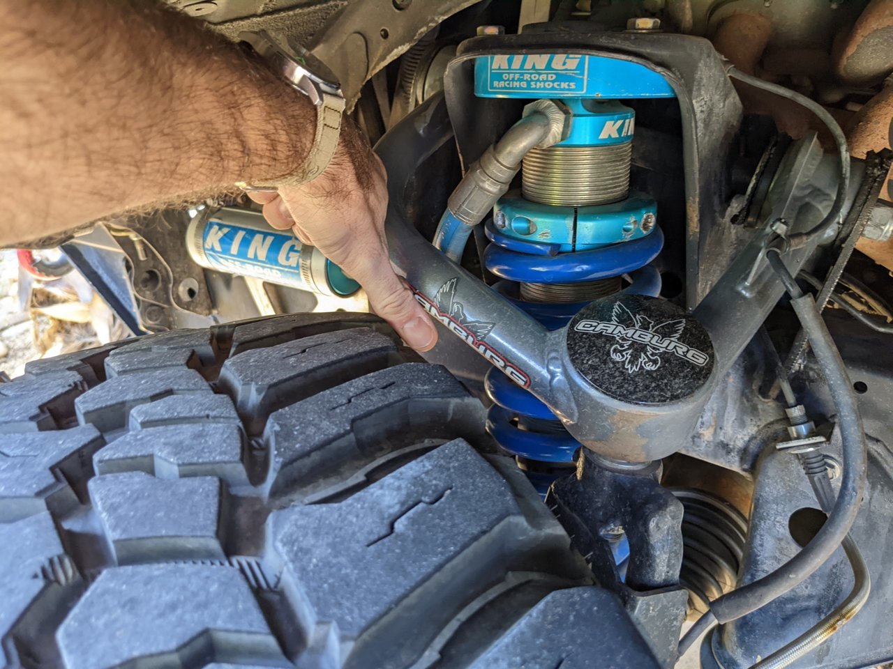

    Finally got my new arms that were backordered and replaced my Kinetik Billet arms with the 1.25" Uniball UCAs. The tires no longer rub the UCA with the spacers removed! Now they rub the sway bar on full lock reversing but I can live with that for now, and may remove sway bar anyway.

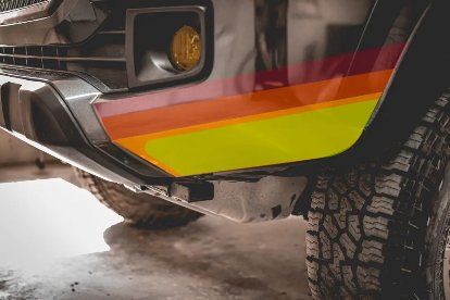

    I didn't have a viper cut or HC bumper with 35s for a long time. Just a little trim on the lower forward edge of the bumper, almost imperceptible if you weren't looking for it. Neither are needed for tire clearance, but come in handy for approach angle.

    What is a viper cut?

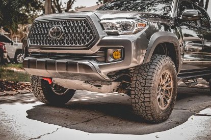

    Hi @erok81 if you would have used google this would be simple. A viper cut involves cutting the bottom “corners” from the lower/outer edge of the bumper. This makes the truck look like a viper…?
    Here are a couple pics showing different levels of…viper-ness and the final product.
    I don’t have any sort of lower bumper so I can’t show pics of my truck. But it’s more like a bullnose python cut. Yes. That’s the one.
    Note: pics and info taken from here: https://***************/2020/06/22/how-to-high-clearance-viper-bumper-cut-3rd-gen-tacoma/
