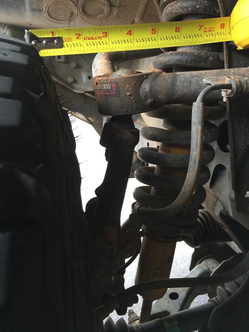

    Maybe one of you guys will be able to help me out.
    I’ve got 16x8 0 offset 4.5 backspacing.
    Have 315/75/16 BFG AT KO2s.
    Caster is at 3.4 R and 3.7 L.
    I have to throw a spacer on the front (1.25”) to not rub my TC upper arm / spindle but now I’m rubbing hard on the fire all at full lock.
    I want to get rid of the spacer but not sure what offset/bs to go with to get rid of it. Picture of the space now with the spacer on.
    I was looking at the SCS BR6 16x8 -12 4BS but not sure if that will work?
    anyone have some input?

    Should be easy enough to figure out given you have both the spacer and wheel measurements. If you can reduce the gap to the spindle by 3/4” then you know you just need a backspace that’s about 1/2” less or so.

    Makes sense how would I do that calculation. Im at an 1 1/2” from the sidewall to the spindle/uca ( basically the size of my spacer ).
    I think I’m at ~ -38 mm and 3.5 bs with the spacer. ( Spacer is 1 1/4” ). So technically a -12 mm / 4.00bs wheel should work?

    Also should I take into account the side wall flex when I air down?

    You flex low not high so shouldn’t be a factor on the spindle

    Mod list... Well, my paint is factory.
