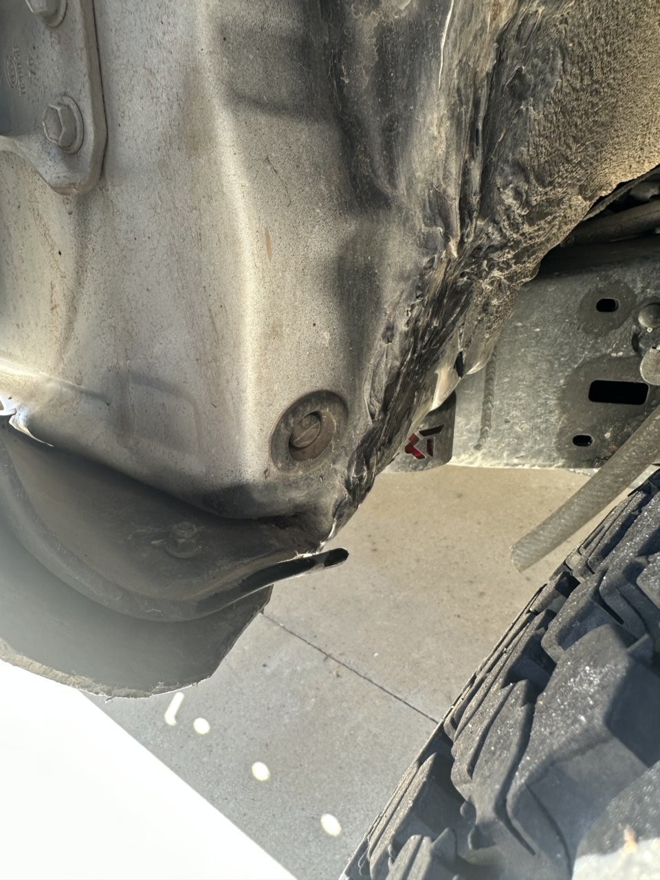

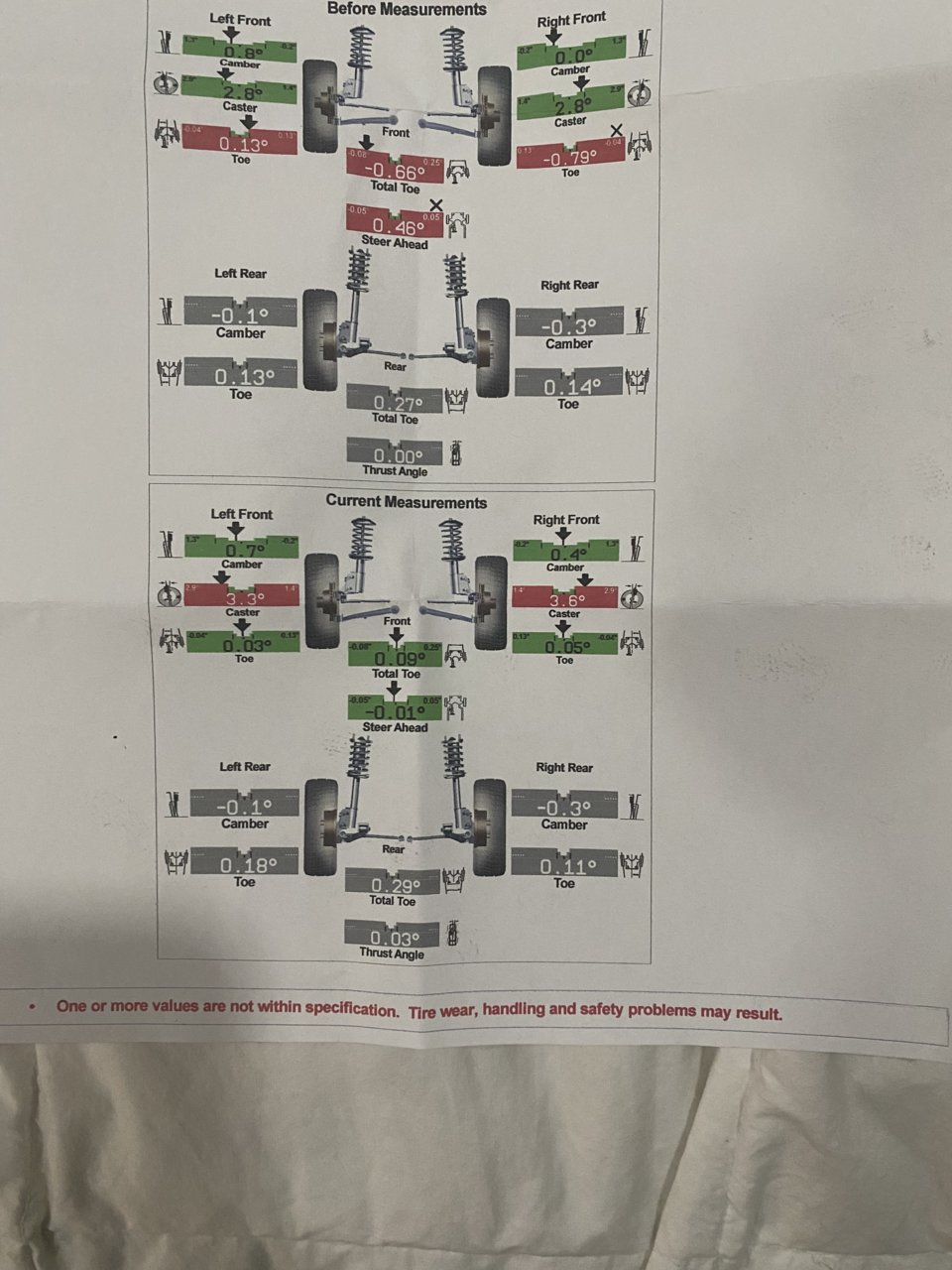

    So I got a realignment and it doesn't hit the firewall anymore. Alignment specs pretty similiar to yours. Now when turning right at full lock, the tire hits the driver side sway bar and the passenger side frame. Do you have any other issues with rubbing after an alignment? Any suggestions? Truck shop said to get new wheels but that sounds like an expensive fix for now.

    My lift kit required a sway bar relocation, which pushed it forward a tiny bit. You could also run sans sway bar, but it could be less stable at highway speeds. Tinker's Advernture has a great video on sway bar pros and cons. I don't hit the firewall but with the caster forward I slightly run the front bumper skirt. Pure laziness as to why I haven't trimmed it more.

    You need to go w/ more negative offset on the wheels or spacers like you mentioned.
