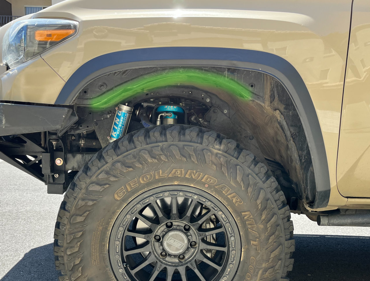

    I'll post a pic shortly to give a visual of where/how it rubs, and appears to be same situation with every Tacoma on 35s I've seen without bump spacers.
    Again, just trying to find out what the workaround is other than limiting travel. I don't see how moving the uniball/ball joint fore/aft/inboard/outboard would change how far up the tire is traveling toward the upper sheet metal.

    The green highlighted area is where I rub at full stuff. That whole upper arc.

    What’s interesting, that is the whole underside of the fender. I’ve actually never rubbed that. The only thing I can think of is variations in tire size and tread design from manufacturers. We works with tight tolerances of the wheel well so it could be something like that but idk.

    Yeah, you can see through the green highlight that the black paint has worn away nearly all the way around. I've gotta get those bump spacers on ASAP to avoid the common core support damage our trucks see from repeated smashing in that area.
    It's so weird that you don't hit there. Even when I had 285/75R16s they would kiss that area on a hard bottom-out at speed.

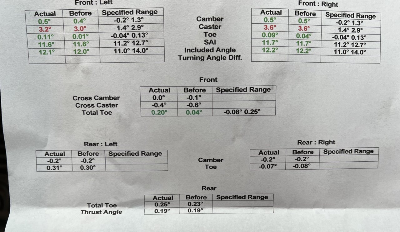

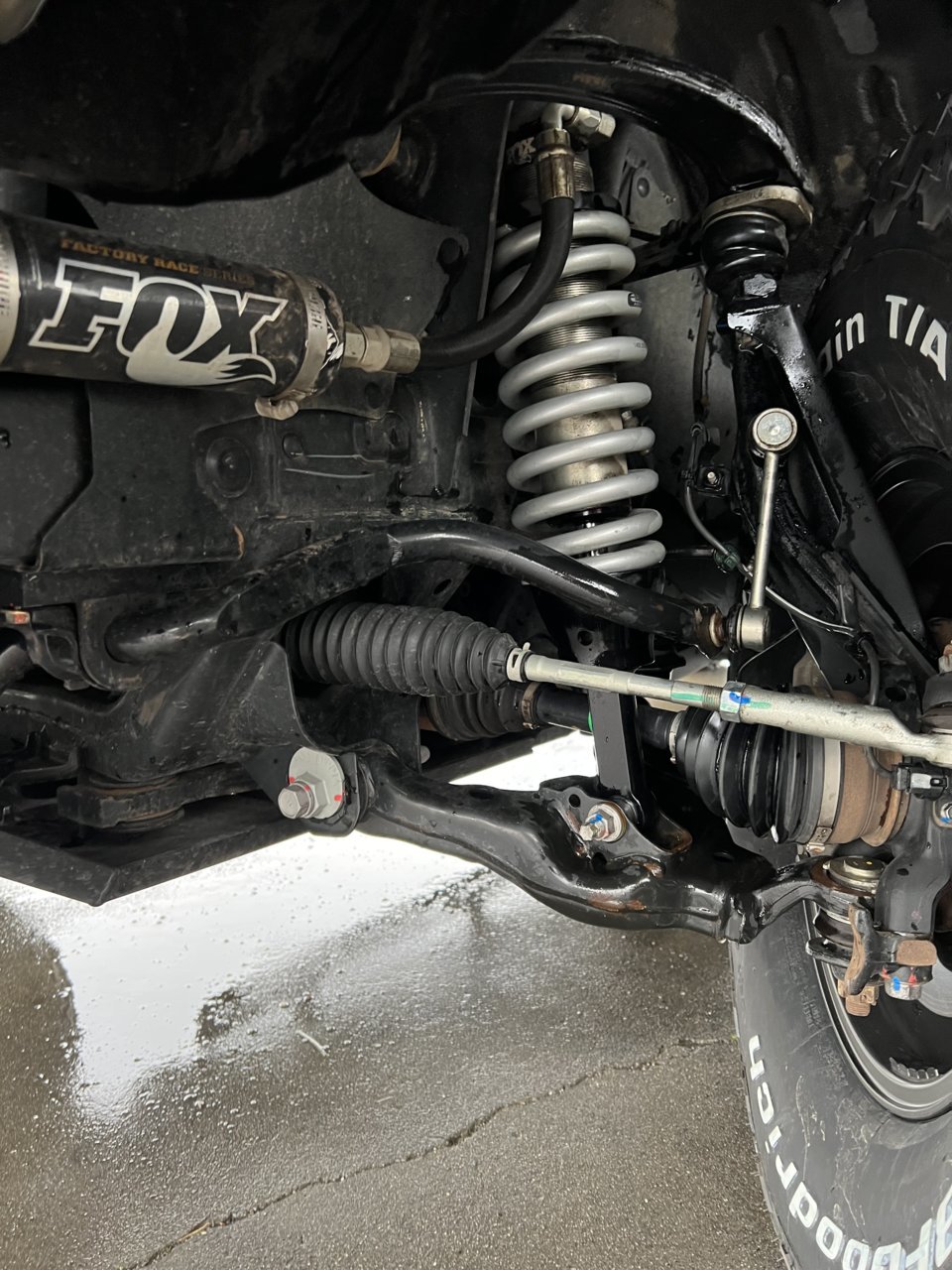

    Finally got them back on after having some work done over the winter.
    For other folks wondering and because finding alignment+build+pictures all in one post is a real challenge in this 95+ page thread: SPC UCA, stock LCA, Fox 2.5 RR with 14" Eibach springs, Icon RXT leaf springs, AccuTune U-Bolt flip and bump stops (3"), Archive hammer hangers with crosstube and 3.6 shackles, Total Chaos Spindle gussets. No bumps up front. 315/75R16 BFG KO2 mounted on SCS RAY10 16x18 -12 (4" BS). DRT cab mount relocation. Not that it matters but the rear bumper is an apogee and the front bumper is an SSO full plate with a Warn 12K evo mounted.
    How’s this alignment look? I need to get it up on a forklift this weekend.
    Full left turn on the left side clearance to the UCA since that came up a bunch in this thread:
