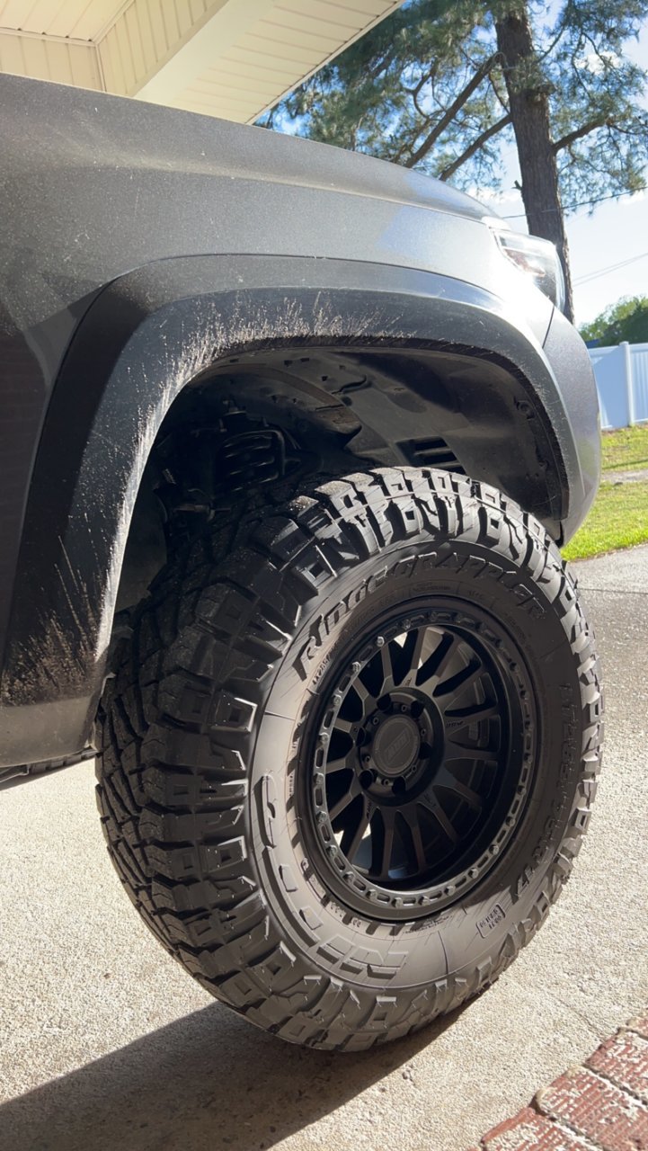

    A decent thud. ;)

    Could be inner fender, if it was the flare/cab mount you'd definitely feel it lol. Have you hammered the inner fender at all?

    The only reason I suspect it isn’t the fender is that I don’t hear it/feel it if I hit them straight on, only when the wheel is turned full lock. I imagine if I’m hitting the fender I’d be hitting it with the wheel straight, too. Cab mount is relocated and has substantial clearance so definitely not there.
    I’m thinking it might be the fender flare. Going to clean the inner fender area so I can see where the tire is slamming and/or wait until I can get it up a lift.

    dont need a forklift. put truck on jackstands and remove the front shock. jack control arm up with tire mounted. cut/hammer where needed and give a little extra clearance for bushing deflection

    I suspect I’m hitting the UCA under compression at full lock.
    This is about 95% lock (i.e. the wheel snaps backs little when I let go) and the inner part of the sidewall is directly under the UCA. Under compression, it’d push straight up into it. Eh, well, the UCA moves with the wheel assembly right? I'm only getting rubbing at compression.
    What’s the best next steps for clearing an SPC UCA? I’m already on -12 (4” backspace) SCS RAY10. Can I align my way out of this hole?

    Probably not. A small spacer should give you the clearance though.
    edit - looks like your UCA ball joint is set to the furthest outward position already

    That’s exactly what I didn’t want to hear. ;) I’ll try a spacer and get the rest of the issues worked out then maybe switch to a 3.5-4” BS wheel.

    Eh, I just realized I'm only getting a rub under full compression and not at lock, so I must be getting quite close to the UCA but not hitting it. My suspension knowledge is a little rusty but the UCA moves up with the wheel under suspension and so compression wouldn't cause the wheel to move up into the UCA, right?
    I guess it's time to pull the coilover and do it right. ;)

    Alllllright we’ve gotten to the bottom of it.
    I do touch the UCA just barely at full lock and full compression but not enough to care.
    It’s rubbing on the remote res. I’m not sure I actually have any great options for moving it so I’m probably just going to live with it for now.

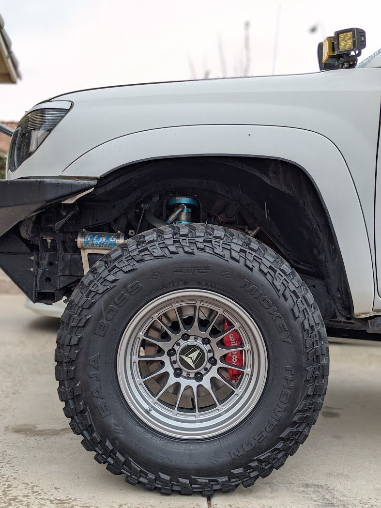

    This is why I went with 17x9 Summit Dakars. -25mm and allowed me to run the Wilwood BBK.

    I think the difference in your build is the Kings. The res mount is in a better spot than the Fox ones.
