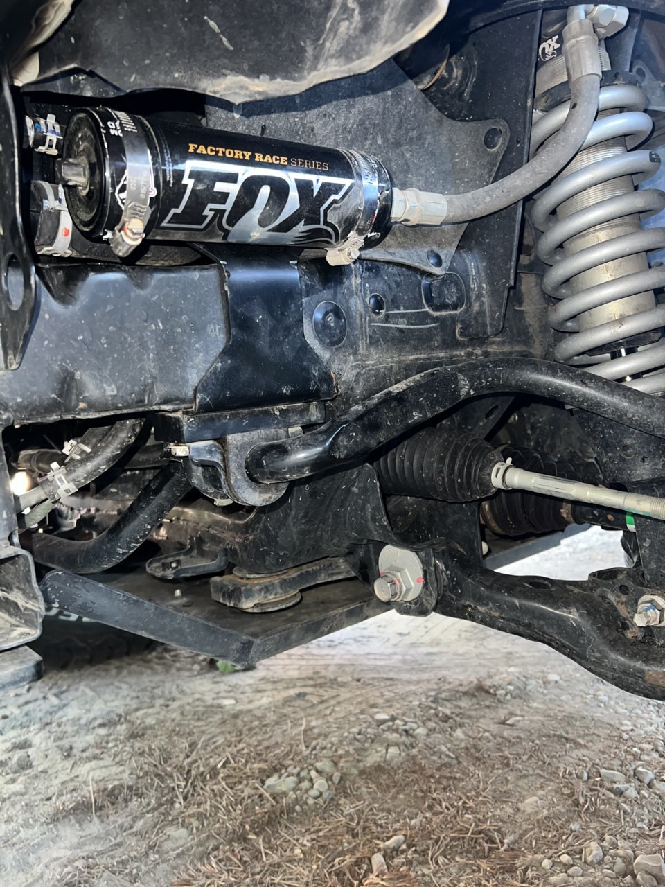

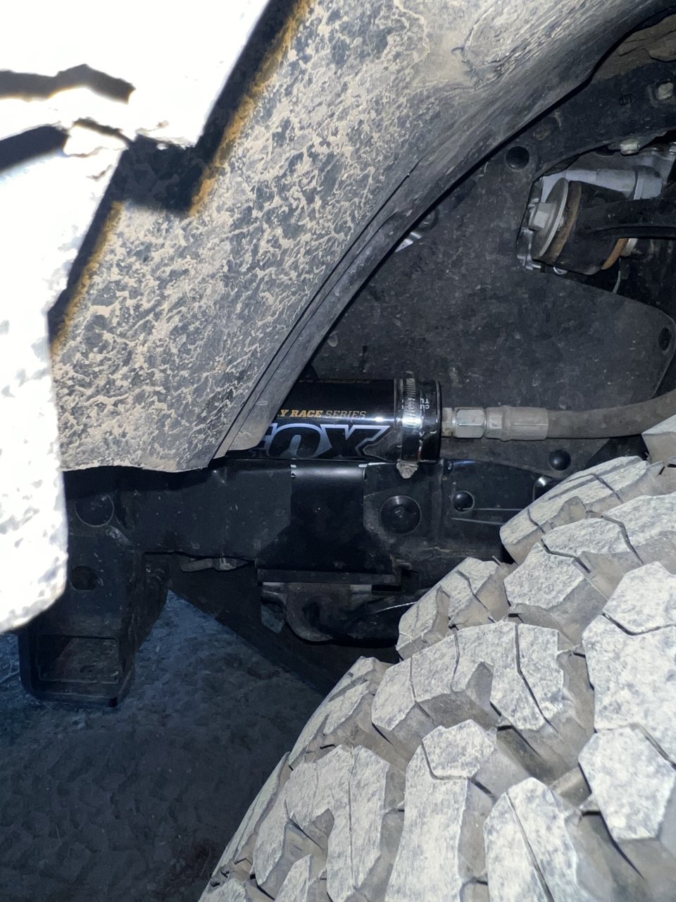

    For folks awaiting the results of my space experiment… sorry to disappoint! I thought it was silly to approach this from a wheel geometry perspective if all I was hitting was the reservoir, so, behold.
    I had a local shop pull the Fox mount and put it on a brake and bend it back up above the frame rail. Voila, no rub. I can get a finger between the UCA and the wheel at full lock, so the 4.03” backspacing is totally fine with.

    My friend did the same thing with a hammer, no need for a press brake.

    Well shit, the bilstein resi brackets have 2 bent gussets perpendicular to your bends.

    Yep — in hindsight I’d have done it with a hammer. I actually expected them to fab a new bracket and didn’t realize you could get such a clean bend over that frame member. Live and learn!
